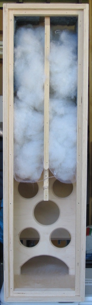

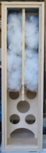

One last set of questions..
I'm not quite sure if the holes in the bracing account for 30-50% of the bracing itself..could be a little less...is this a huge issue? Nothing i can do about it now, sadly..
Also..how far behind the front opening should the polyfill/wool begin?
Sorry..my first time with DIY speakers
Anyone?
" Scott (Super Pensil designer) advises that the stuffing material be unformly distributed throughout the cabinet. "
This from a previous post..
And that's exactly the reason for my asking. I have yet to see a picture of the stuffing of a Superpensil enclosure. Uniformly distributed does not look like the one in the previous picture. I guess i could put it this way : Does the stuffing go from top to bottom and from front to back?
KarlsMoody,
Probably there is no single correct answer for this. Depending on room and your system, personal taste (and I daresay stuffing material), the amount will vary.
Suggest you try out like the picture and then add as required. The removable back panel gives you that option. 🙂
