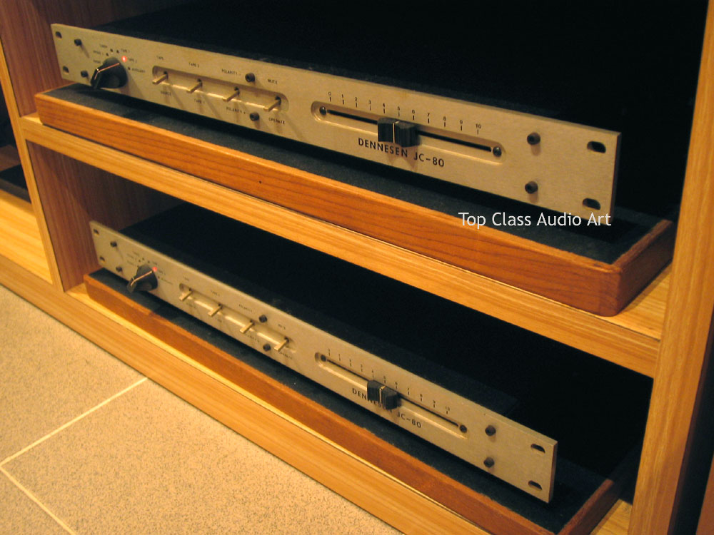

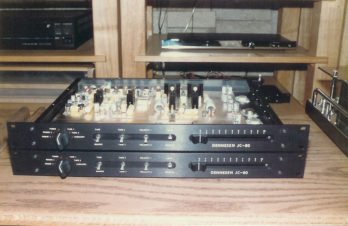

Hi John, happy New Year also from me. And thank you very much for this advice.Many Levinson, JC-80, etc
Mean you this dual mono devices?
*????*Dennesen JC-80???????PCB????-????????-???,???,?????????????
³ªÀÇ ¿Àµð¿À·ë ½ºÇÇÄ¿ ½Ã½ºÅÛµé DENNESEN JC-80 :: ³×À̹ö ºí·Î±×
DENNESEN JC-80
review33 - ????
(Image No 7)
?? JC-80 DENNESEN ??å ?????? McIntosh/JBL/audio-technica/Jeff Rowland/Accuphase/?/?¾?????

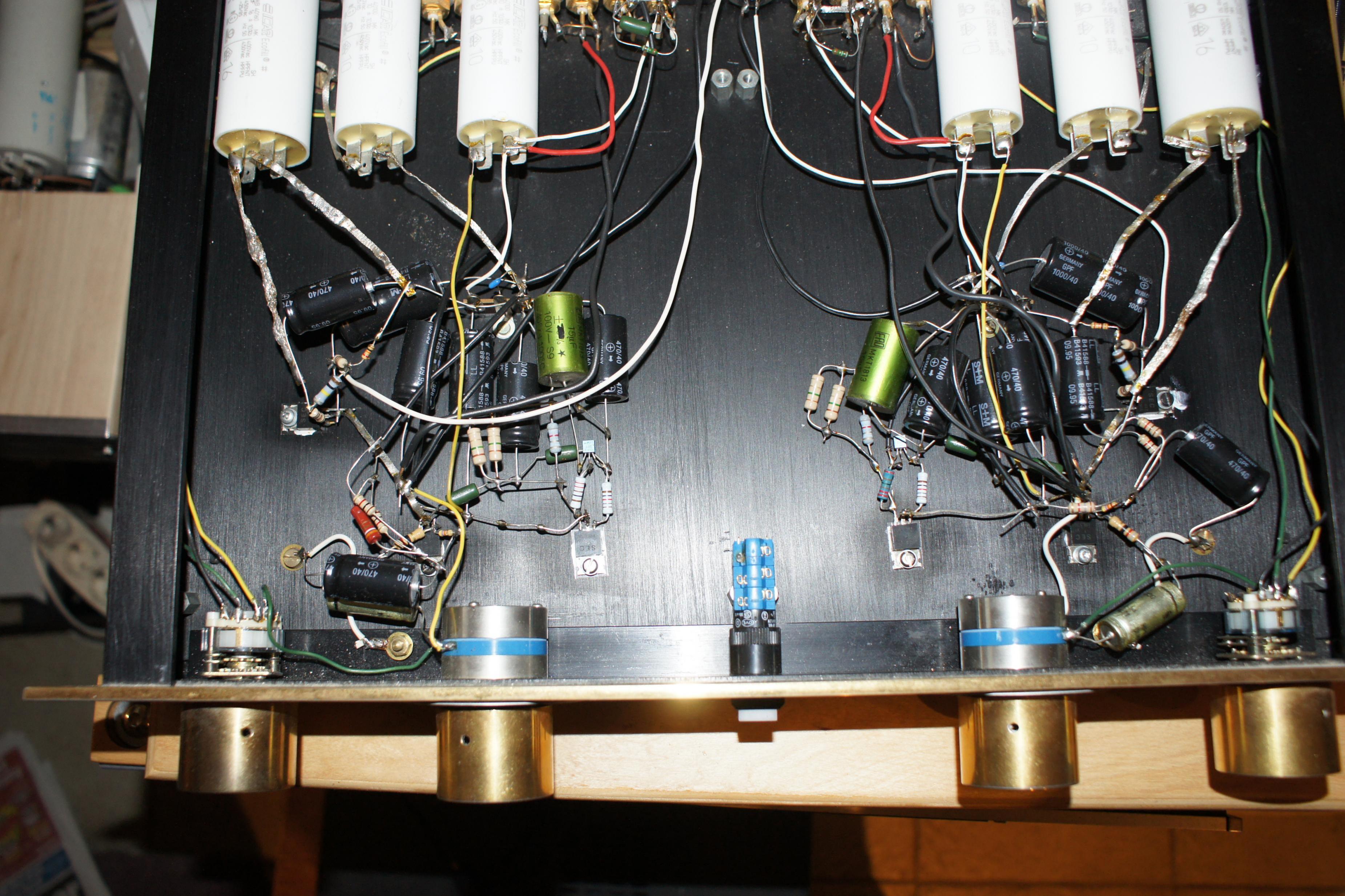

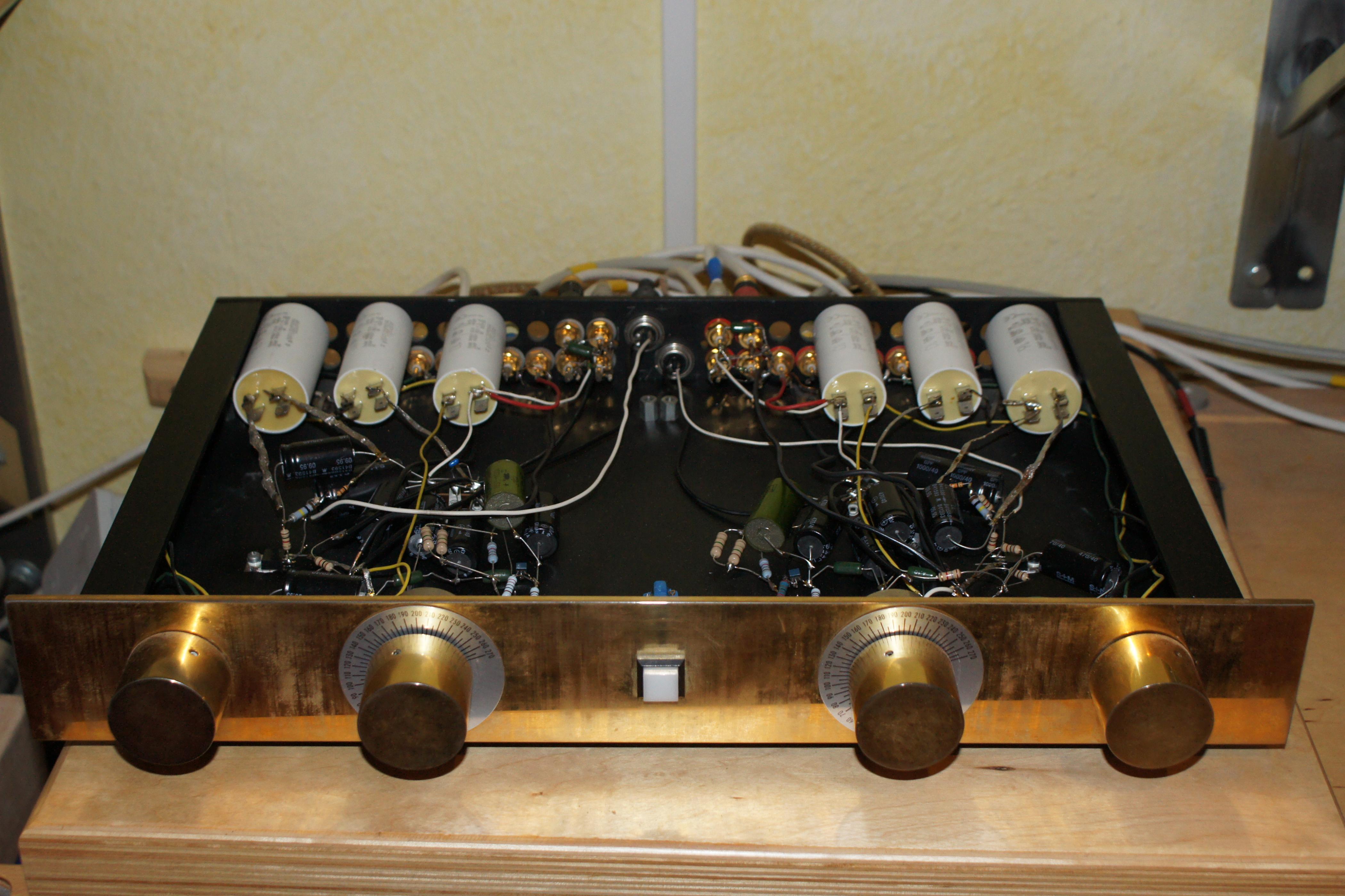

To tiefbassuebertr:
Congratulations with your nice MF preamp.
Did not know the English made such expensive gear.
Unfortunately that is not the preamp part from my own setup. I found the pictures on the web by chance.
Obviously there is no high circulation of this model.
That's a surprise.
The Krell would have used it in its premium line even more I suppose.

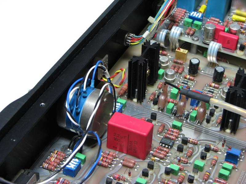

Best potentiometers without a doubt? Penny & Giles Model No. D460355/C recently resurrected. Heavier silver oxide and better machined tracks. "In the initial refit of a KRS-2, the Pot by Penny and Giles D19992 was found to be unbalanced between L+R at very low volumes, which was incredibly frustrating having waited six months for it. It turns out that the silver oxide manufacture was changed in the middle of the recession. After long discussion with Penny & Giles, an older type with higher tolerances was resurrected and produced... another three months... however the results are world class, Its model/ type D460355/C and the best available. Max differential between left and right tracks is specified at a maximum of 0.5dB, that -as it turns out- was the critical figure! The D19992 of the RF15 style was a max deviation of 2.5dB." TKD good but flimsy. The Model No. D460355/C is the best potentiometer out there, that is unless you go to rotary fixed resistors....and some other exotica that may well out live my grandchildren! If you do a google search for KRS-2 and find my posts on pinkfish media, an expansive conversation with penny and giles seeking the best potentiometer that they made for audio is peppered throughout that post, it took months and months to find this out. My ears concur.
Does anyone know the impedance of the PandG in the Aragon Aurum? would a stepped attenuator be an upgrade to this? If so, what would you suggest?
Beautiful KRS 2 and great job. I read your post on PFM. I have a KBL just back from Krell with a complete PS rebuild. I'm thinking about replacing the old VC with a motorized model. Any suggestions? Thanks.

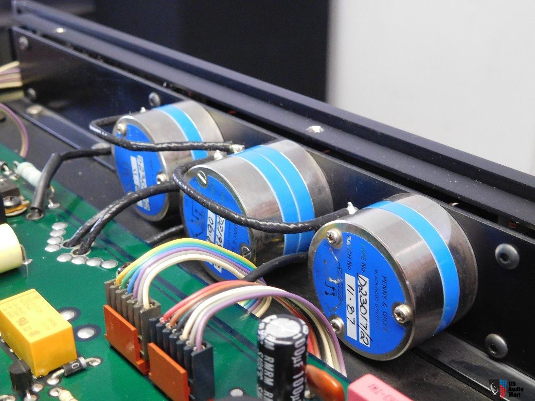

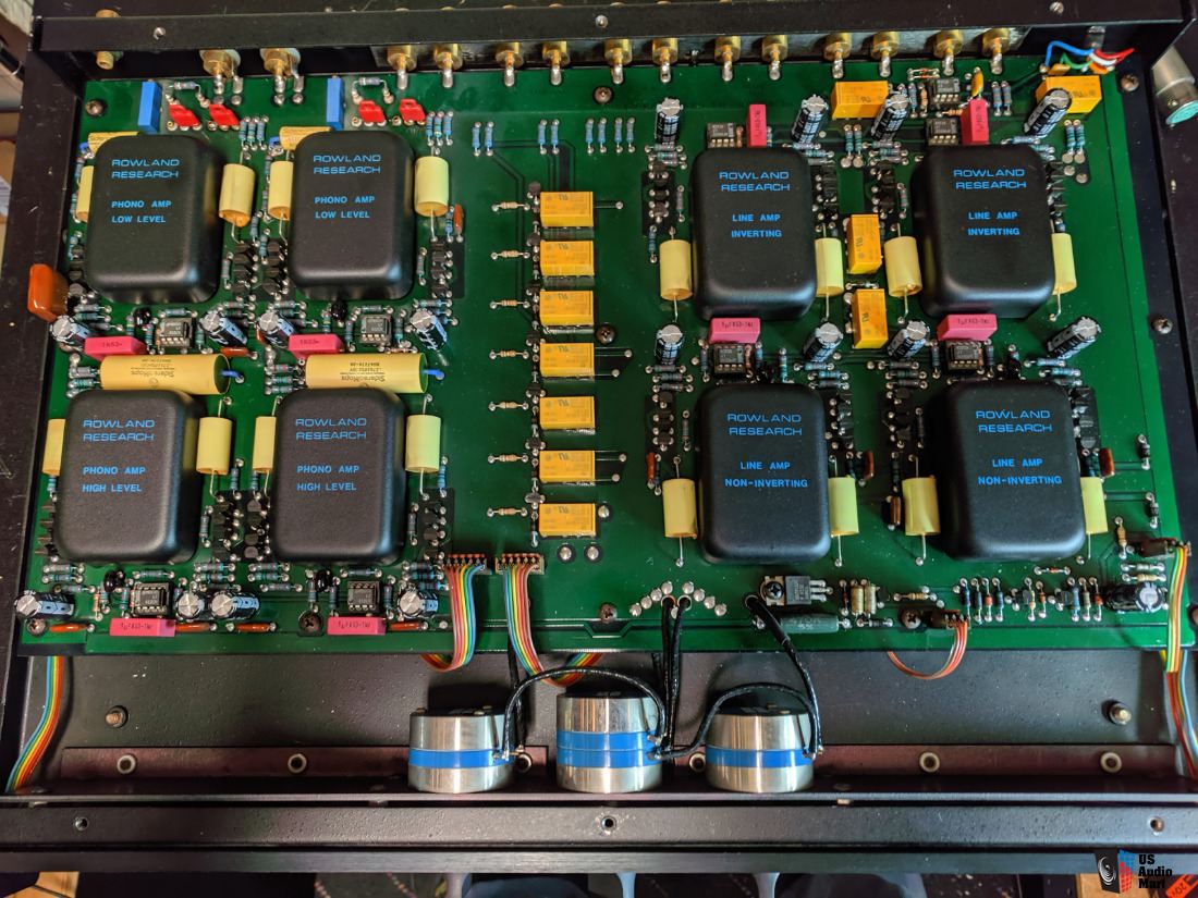

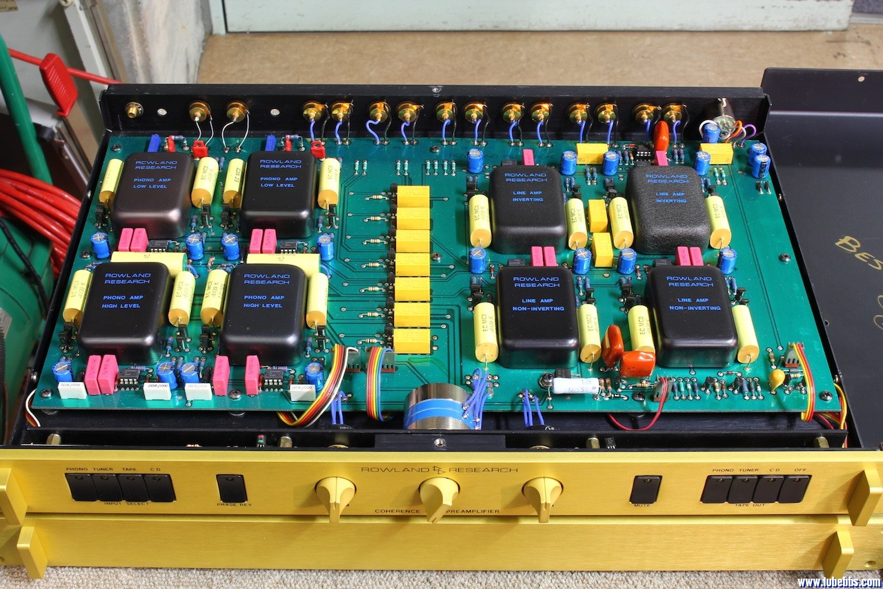

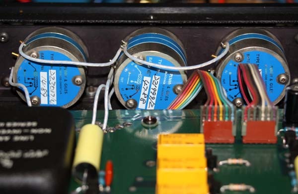

There are a lot of versions from the RF15 series. Until now I have discover versions as follow:
A: Single Channel/Mono Potentiometer:

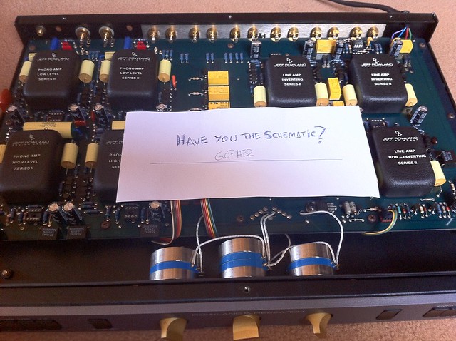

1) D23017/2 for JRDG C1 Balance - go to
Jeff Rowland Coherence 1 - Schematic for the Modules wanted
and
?? mimesis PH3 ?? - ????????? - ???[Tubebbs]???? ??|??|???|??|????|????|????|???|???|???|??|?? (scroll down)

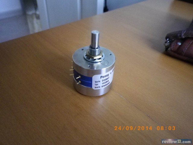

2) D22667 (RF15/2/1304) for Mark Levinson's ML6B - go to
review33.com - 影音天地
B: Dual Channel/Stereo Potentiometer

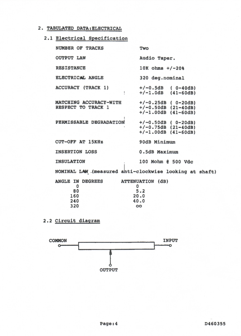

1) D460335 best choise according your description under
Krell KRS-2 | pink fish media
2) D460235 (RF15/2) for Mark Levinson's ML7
MARK LEVINSON ML7 POT
3) D460343 (RF15/2/20K/AX)
https://www.yoycart.com/Product/524726715273/
4) D23317 (RF15/2/C/A) for Horch 1.2 (Preamp from German Brand Horch Elektroakustik)
5) D21999/2 for various preamp models
6) D21999 (RF15/2/D/A) for Marenius DAC-S2 - go to
https://www.marenius.se/pdf/dac_s2_datasheet_2s.pdf
7) RF15 versions without additional numbers
currently website don't have a download area for datasheets
https://www.cw-industrialgroup.com/Products/Legacy-Products/Faders/Rotary-Fader-RF15
From where I can download this ? Which of the mentioned versions are oil filled ?
Thank you for advices.

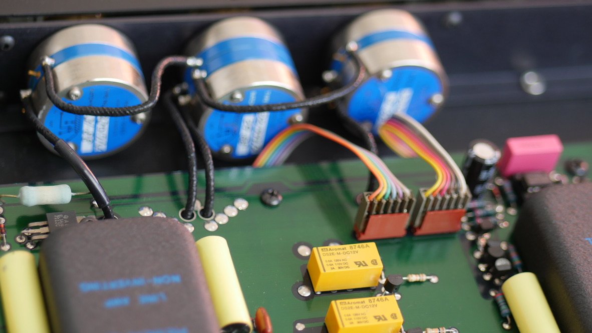

and

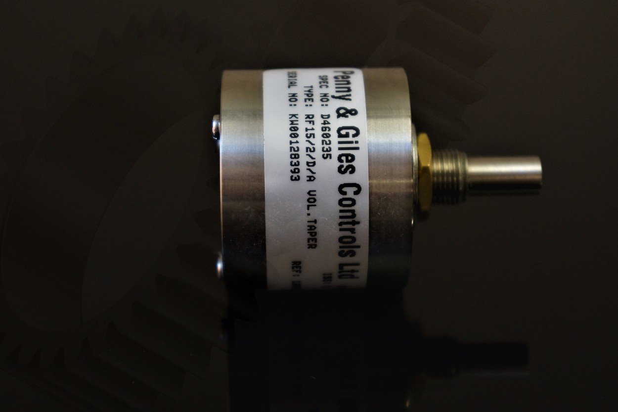

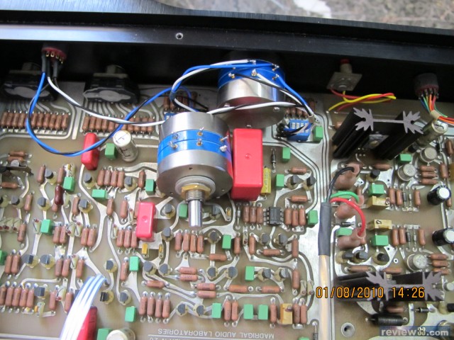

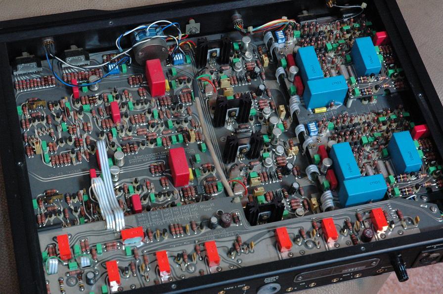

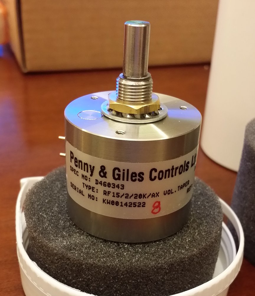

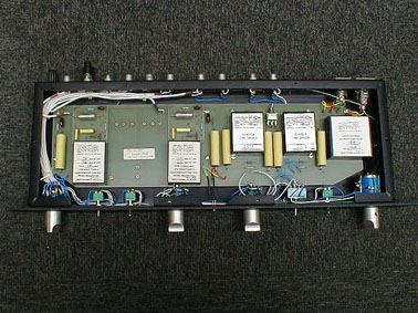

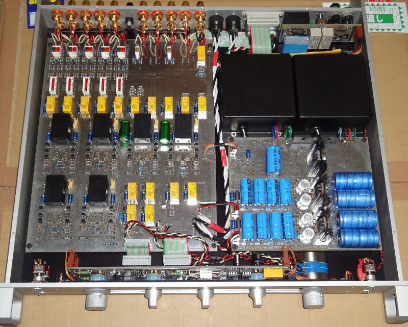

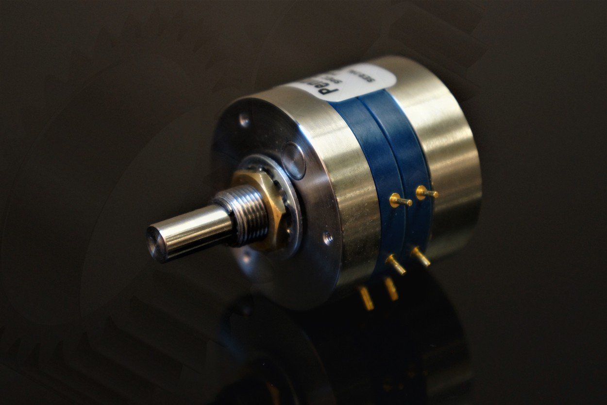

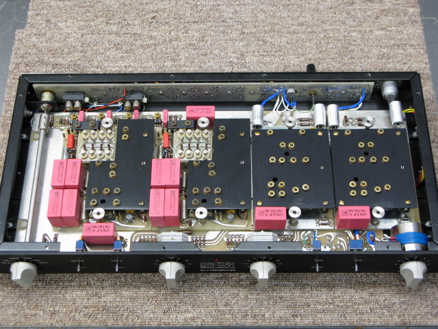

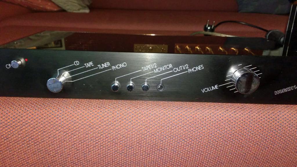

Images of RF15 Variations (Dual Channel/Stereo Potentiometer)
Images of "B" from my previous post

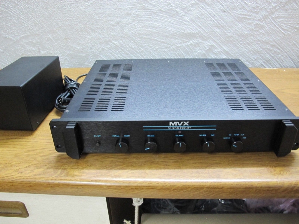

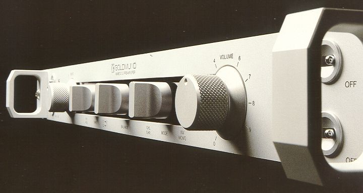

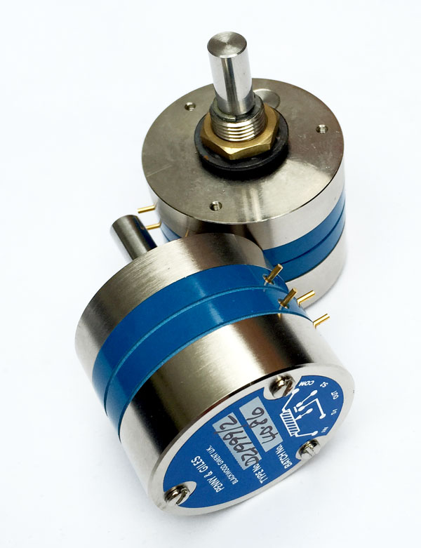

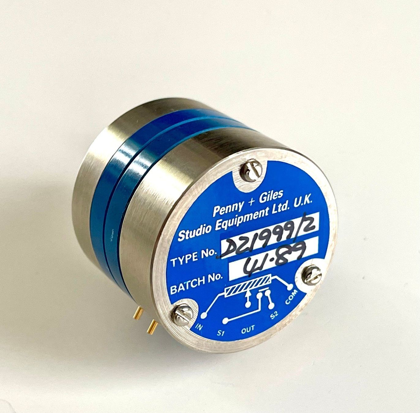

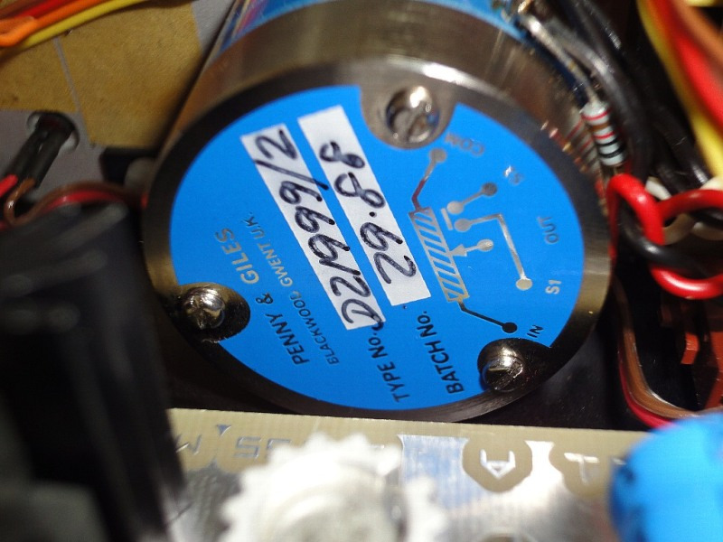

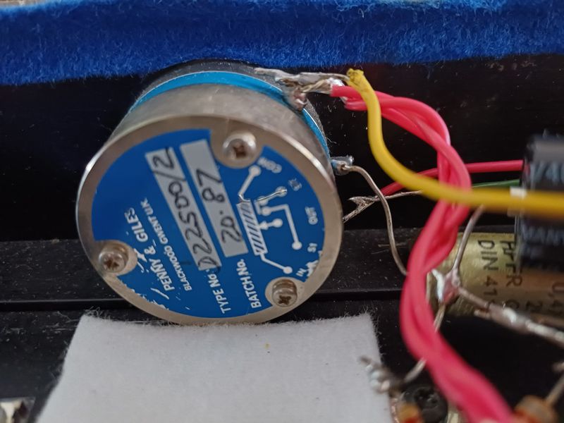

RF15, D21999/2
images of the versions with blue sticker on back plate

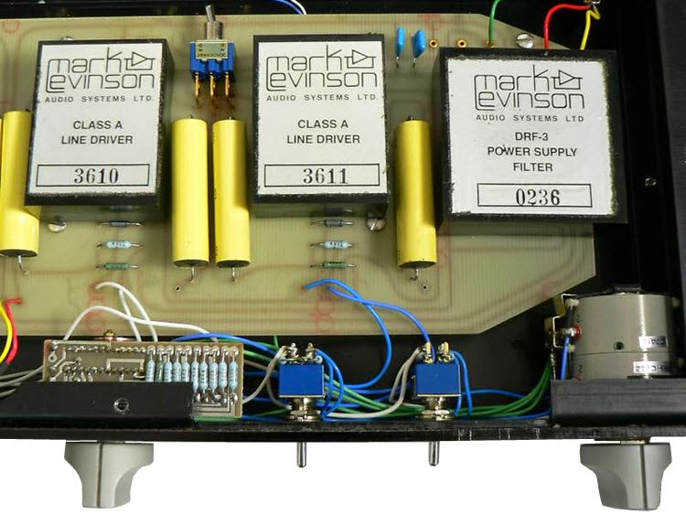

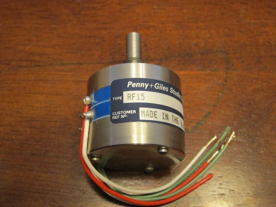

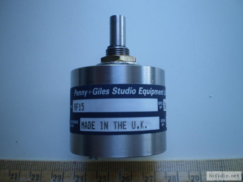

Older RF15 Versions
Early Versions
Early Versions

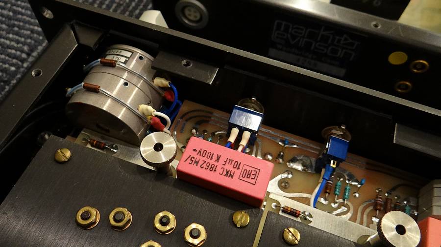

Hello all,
I have also Penny&Giles RF15 in my ML26 preamp.
The this volume control has started to have noise when turning. Is there something I can do for the pot or just buy new? I have tried to rotate it multiple times back and forth but it does not help. Is there any maintenance that I can do?
Thanks.
Thanks.

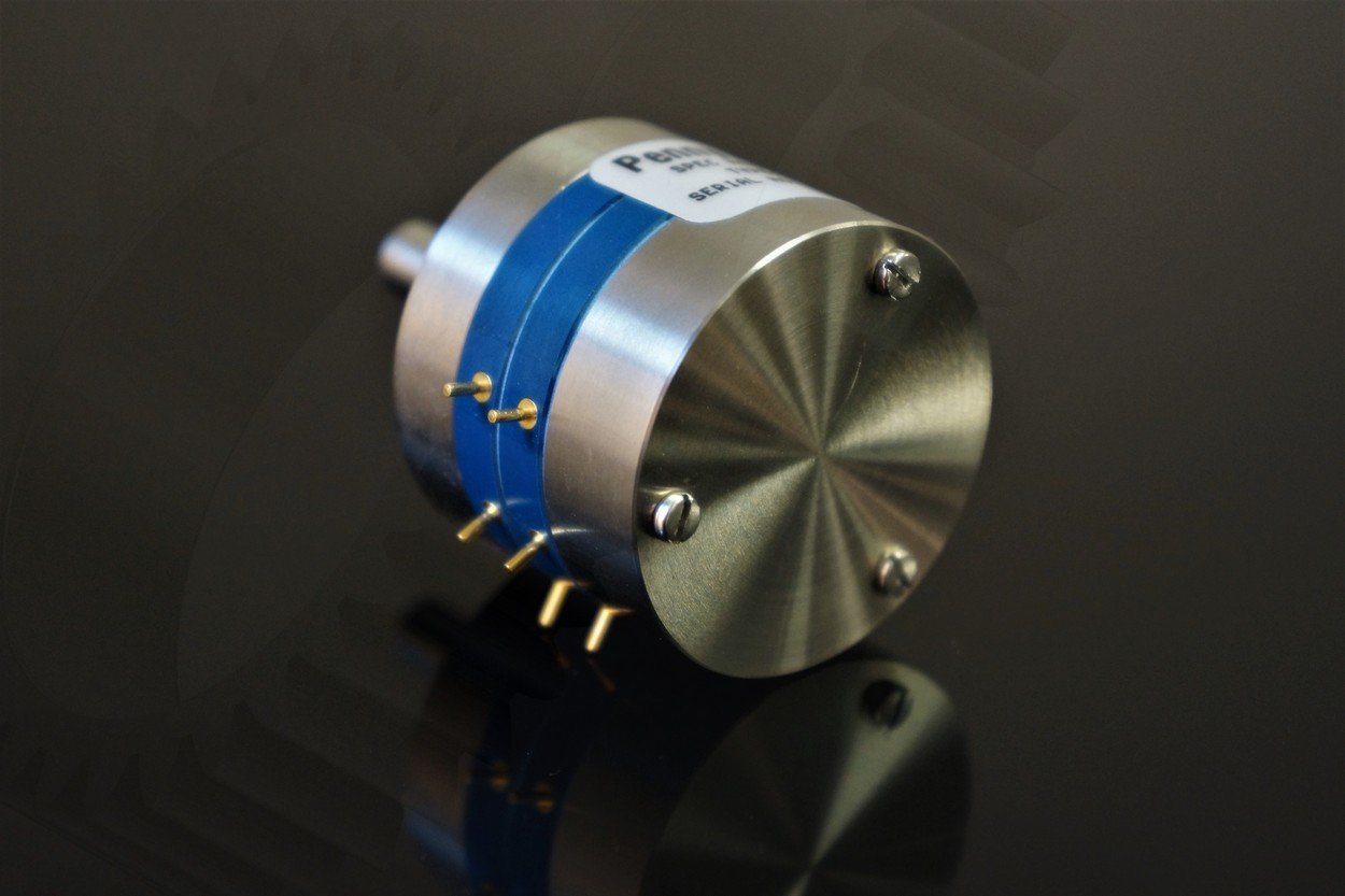

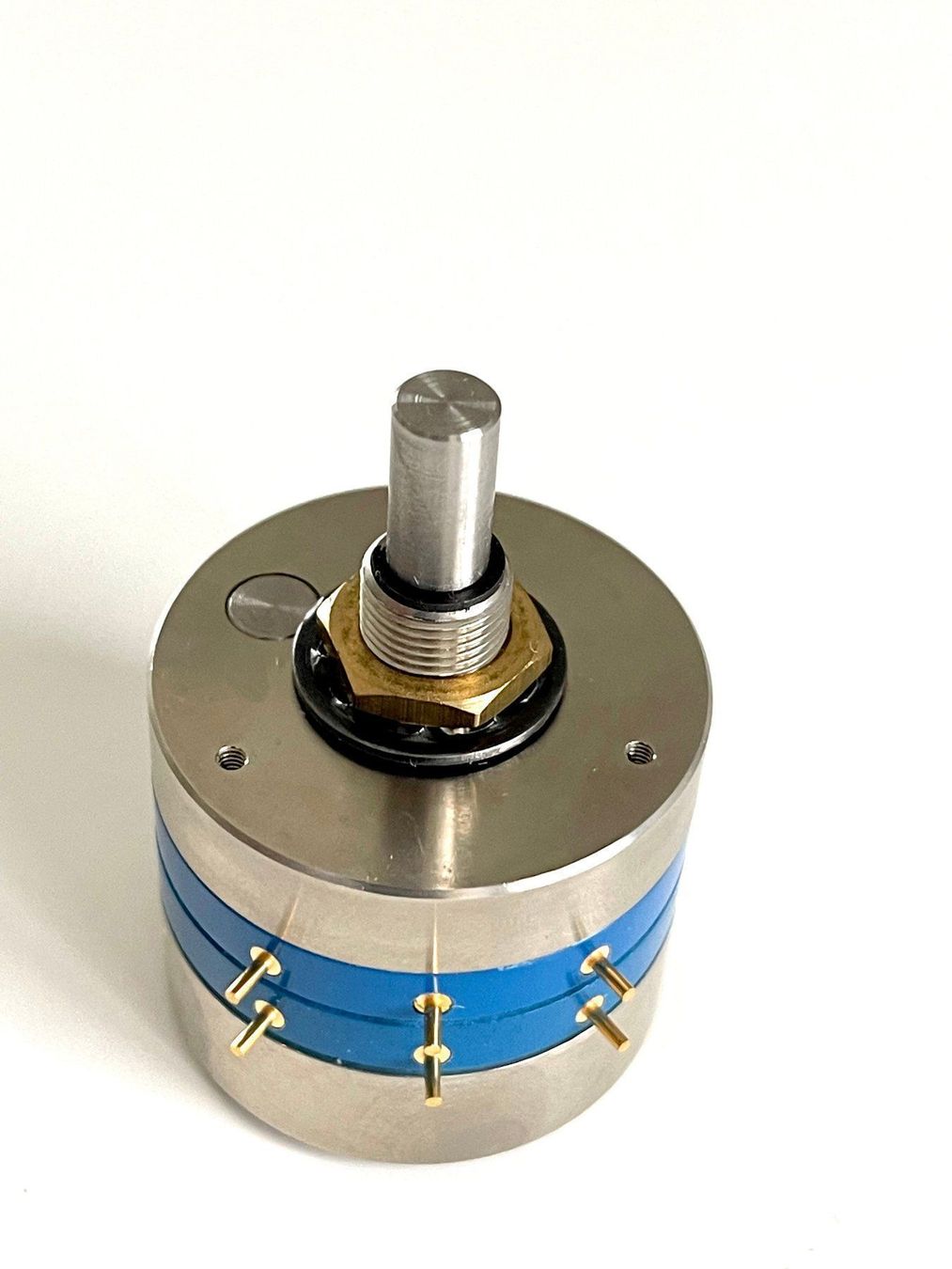

In the attachment various images of this P&G series - first image is those single channel potentiometer which is to be replaced by an ELMA "04"
Which resistor version for ELMA's 04 should I prefer ?
