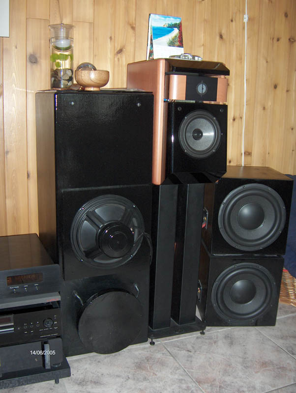

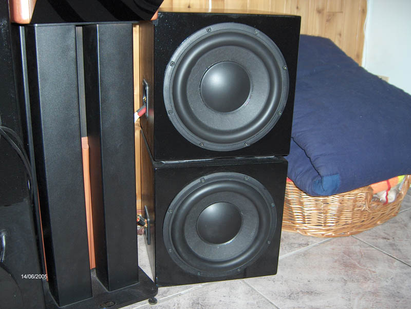

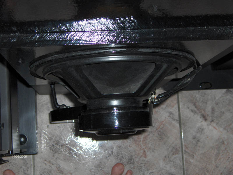

Here are 2 10 inch subs XLS (with PR) that I built. They are vary good for HT but they dont go low enough for music -3db at 30 hz. I also buILT iSO subs using the classic line. THose go -3db 22hz and are really good for music. The are much easier to bottom than the XLS.

You got that backwards right ? They are good for music but lacking depth for artificial sound effects in movies ? I dont think a stand up bass or a grand piano do much below 35 hz. I might be wrong. I usually am.

It depends on your taste in music and movies! I have a RTA in my system and I can tell you there is plenty of signal below 40 Hz in most recordings. It's a question of being able to move enough air to get sufficicent output to make the extra depth worthwhile.

Hi Paul, you are right about EQing for the XLS LINE, I have to use an ART EQ-231 to limit the roll off below 40 hz. i actually apply +4 db at 40hz, +6 db at 32hx and +12 deb at 25 z to extend the basse response. Otherwise, the small box drops like a rock starting from 40 hz.
On the contrary, the Peerless Classic line in a 75 liters reflex box extend way down to 25 hz with only a + 4 db correction. However, like I was saying the classic line will bottom heavely with HT signals because it has only half the Xmm that the XLS line has
In my setup I combine the 2, using the EQ, I turn down the volume of the Classics on HT and I keep both lines for music. Great stuff for a minimum amount of money spent if you compare with commercialsubs out there.

What about trying it with 2 PR from Stryke?

The lowest F3 according to WinISD would be with a single PR from Stryke, the model with the lowest mass, 700g. F3 would be around 35 Hz anechoic with a 50 liters box. In room, you could achieve a F3 of about 25 Hz with the 1050g model with the same box size.
Achieving a low F3 with two PRs is harder. Also, when you factor in the cost of two PRs and the cost of the Peerless subwoofer, you can forget the PRs and buy a Ascendant Audio Avalanche 12, or a Acoustic Elegance AV12, or something like that.
