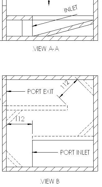

how did you solve the 510mm length port problem?
510mm long is easy as advised above with one elbow.
The design I did called for a 100mm x 856mm long port if using pipe but a folded 70mm x 112 rectangular port was used. Sat on the bottom of the box like an underground car park with the inlet like a ramp.
Reactions: bassman_soundki

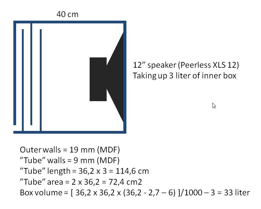

i wonder how big box can i do for the most extended possible frequency response?
I'm running a LXS 830500 in a 33 l vented box tuned to 23 Hz, using a labyrinth vent.
First I powered it with an old Onkyo 85 W amp .... but have shifted to a Class D 300W .... Onkyo worked but with the Class D amp it is just impressive 😉
Have also tried a closed box with linkwitz transform and around 300 W ..... that didn't work as it simply has too little output.
Go for vented unless you have a lot of drivers 😉
As can be seen on sim of this build, it actually takes 600 W to make the unit max out ... so room for improvement here 🙂
