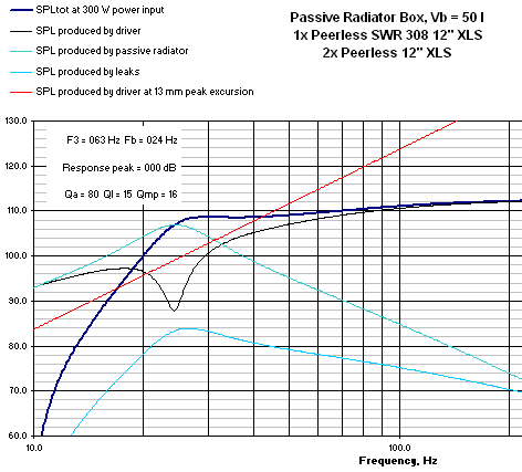

I would like to build a subwoofer with one Peerless 12" XLS (830500) and two 12" passive raditors. First, should I get the 425g PR or the 625g? Second, how big should I build the box? Peerless' own application notes only describe how to build with one PR and not two. I have found a LOT of threads about peerless and passive radiators but no post that gives a basic guideline of how to build and recommended box-volumes. Since I use linux, I can't try different box-sizes in winisd etc. If I can get hold of a windows machine, will the basic winisd suffice or do I need the pro version of the software?

And here's a design with 50l and two 625g PR's:

just wanted to let you guys know that my sub project is making progress. The MDF board landed at the carpenter that is going to help me this monday. Don't wanna cut 60mm MDF by hand
50l box with 2 passive radiators. should sound nice and give a good LF response
