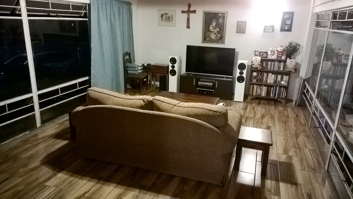

I just reviewed the picture to check my imaginative capability wasn't getting too carried away and it was. a bass box under the speakers and television unit would look Daft.
for the athletic of this situation a nice white painted front ported 12" subwoofer located instead of the table to the left would look good from a ascetic/artistic point of view and likely a placement/sonical sense as well.

what I see to be a table with a amplifier on and a computer standing beneath? why not place a sub there.
That's basically the idea. I was wanting stereo subs, but this is now my plan. I'm building a proper table there, so I'll build it to house the amp, PC, and woofer.
I dont see how the 6 inchers extend that low realistically, though some may be the room size
The drivers have an excursion limit of 10 mm each way, so theoretical SPL at 30 Hz is about 101 dB without room gain. The speakers themselves respond well to 26 Hz (glass panes shake like mad, clothes vibrate a lot on me, etc.). The woofer still needs to fill in <35 Hz to bring levels of sub-bass up to 0 dB at least.
Under the table and mains..
There's an idea!! Even if I didn't go with a TL, I could simply use a low profile woofer (or perhaps two in the same cabinet, separate enclosures), with a port on each end. Something like attached.

I think I might go with JBL GT5-10. The enclosure volume will be about 65L, internal dimensions about 16 x 65 x 63 cm, vent frequency at 25 Hz. That should sound awesome! And I get my stereo...
