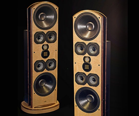

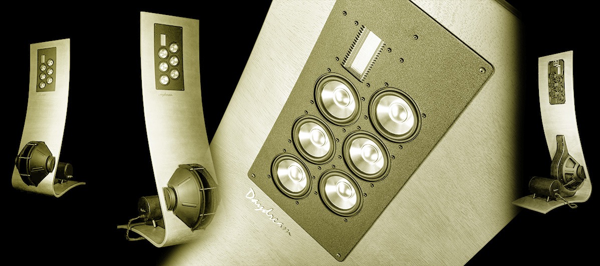

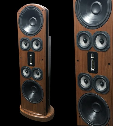

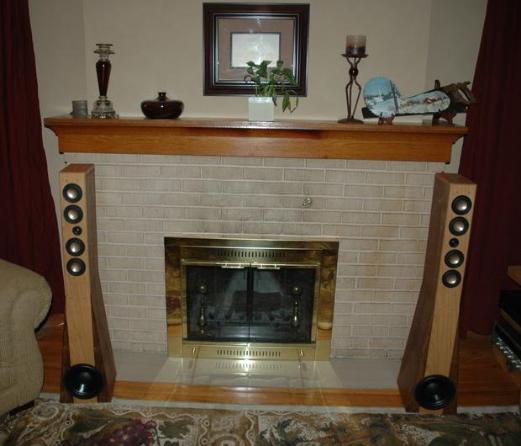

I suppose you can achieve great results with both approaches.
There are many posibilities, idealy you should make mock up build on cardboard and measure.
Some like symetry mmtmm, some square mids with tweeter in the middle, some on the side of mmmm.
There are those who prefer mmmt, or similar.
Way too many options. That's why its not possible to say which one is best.

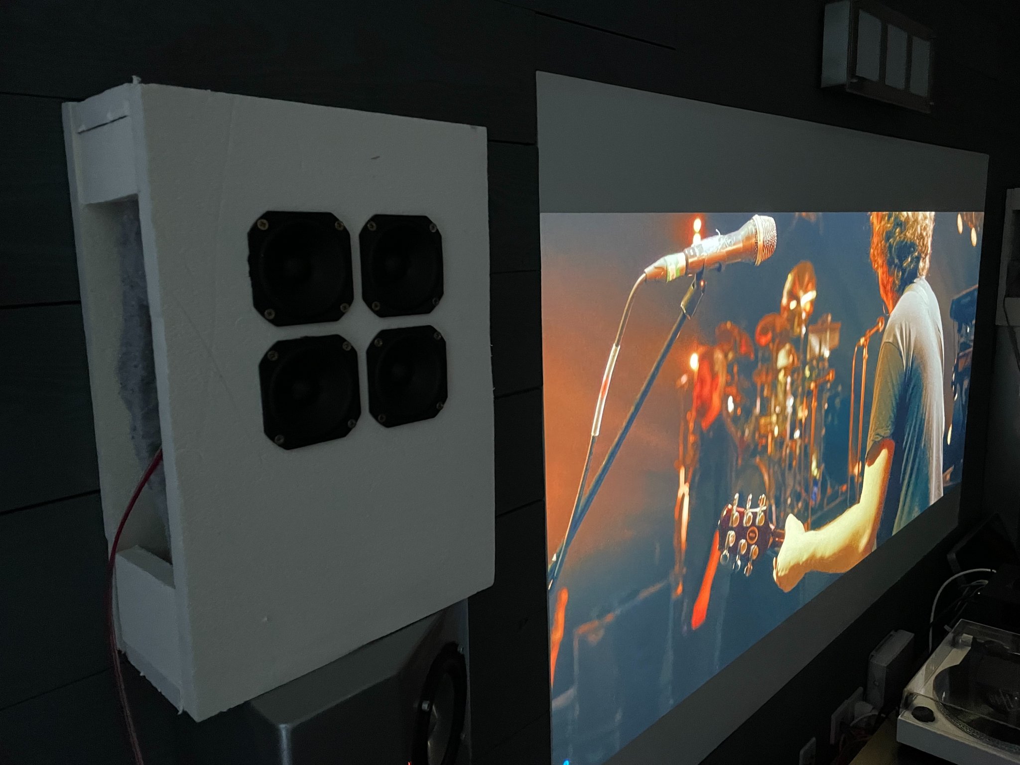

Did a mockup with styrofoam this WE:
11 cm internal depth, 30cm wide
Equalized with Audissey => automatically crossed with 12" sub at 120hz. This was the first surprise, I did expect much higher (the 4 in line did cross at 180Hz)
Even with the missing tweeter and stereo subs, my Jordan VTLs are far behind in terms of dynamics and immersive sound. Thanks Adason for the inspiration.
Tried first 4 in a row and then the square pattern. Bass is totally different in this configuration.
Next step will be measurements (was lazy and let Audissey work for me today).
Dynamics is just crazy, it's a different league. I guess that comes from the 4 drivers series/parallel that work far from max.
That's enough for me to go on with the project and start building the final enclosure (also hosting a Dayton ND20FB-4 and a Dayton DCS-205).
As I want to play with MT crossover I'll go active (3-amping).
- 4 TC9 in a square pattern
- "Half" OB, wall mounted but with no sides (just top/bottom/back). Constraint here is wall-mounted and reasonably small.
- 7.5mm spacing between drivers (so to have space for a small Dayton tweeter in the middle. C2C = WL of 3500Hz
- Some stuffing for the back

Did listening off-axis, and eq done also off-axis. Sure I don't get the full benefits of OB, but here wall mounting is mandatory 🙂 . Measures will explain what's happening, need to find back the cable.
Will see with the Dayton...it is 90db, TC9s are 90,4, simulations give just a few watts for my listening level.

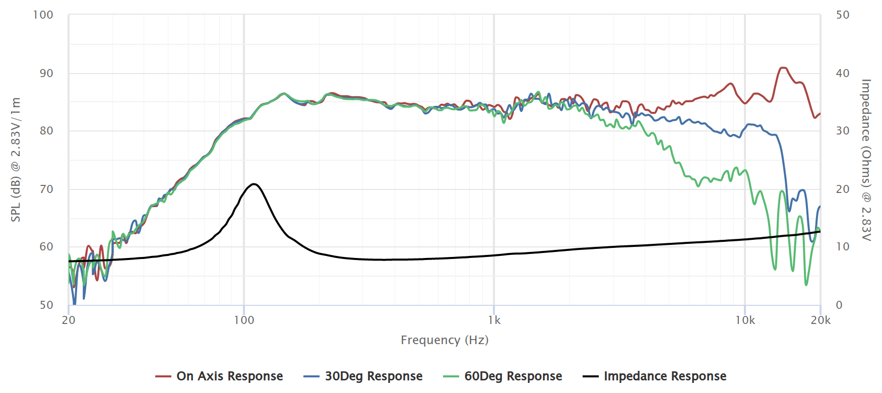

Quick and dirty measurements show an off axis30° curve that looses 2db (compared to on-axis) between 1k and 2k, then is stable from 2k to 4k then goes down by 8db from 4k to 8k, really starting to fall at 5k.
At 45° there is not much difference.
So crossover in the 3500-4000 should be OK (possible due to very close spacing thanks to small footprint of FD20), worth trying. Hoping that will limit power enough to let the tweeter survive.
Also have some bumps at 200 and 300hz (+-3db) maybe linked to the non real OB setup (sides open + stuffing), but they seem quite consistent / axis and should be manageable with DSP (will see 🙂 ). Doesn't match any of the dimensions of the box.
Measurements below 200hz aren't so relevant as I limited the sample to 100Hz-20000Hz. However, below 200Hz everything goes away at 17db/oct, starting to seriously fall below 175Hz, so subs will have to go that high, hoping that's manageable by DCS205.
This was also the opportunity to see the job done by Audissey : very very basic... seems it only plays with low Q filters, a real DSP manually tuned does much better. Did measure w/o audissey (with audissey ON it changes th general shape of the curve for off-axis listening but doesn't touch any of the bumps)
Now that's th emimiut of my competences with REW, and I'd like to better understand how to use the impulse / delay graphs to see if that translates the feeling of way higher dynamics than my Jordans.
