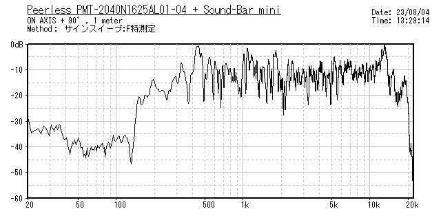

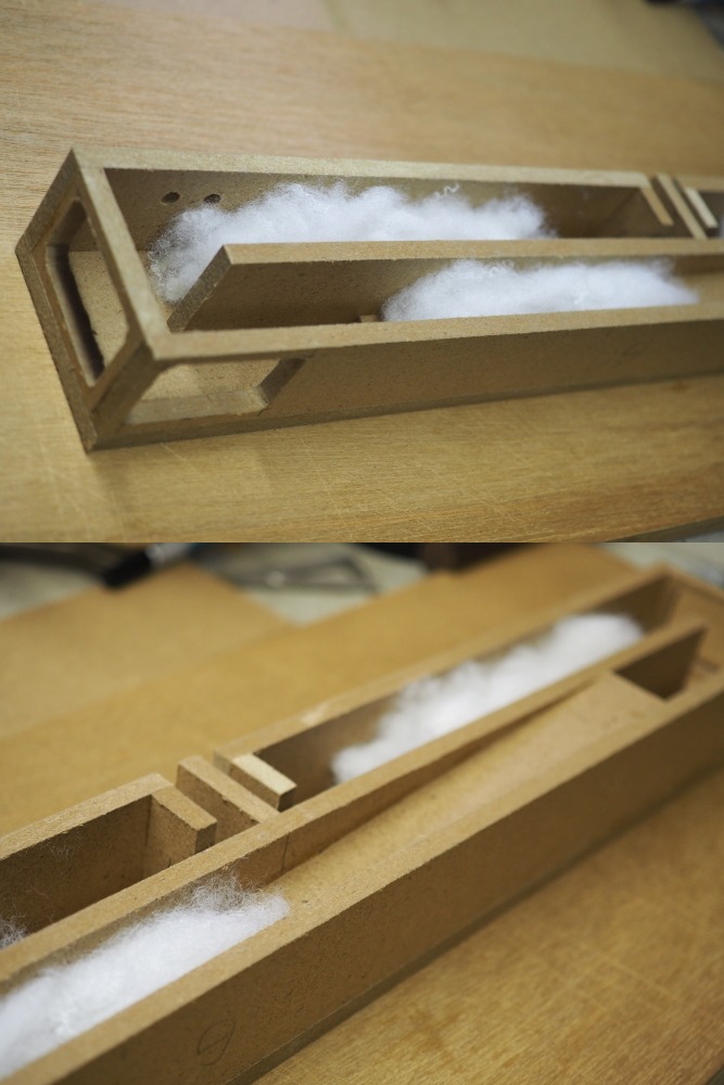

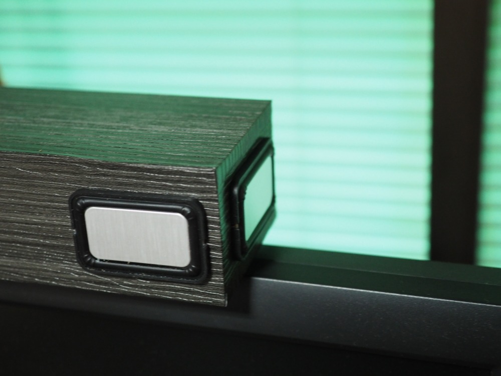

I used four PMT-2040N1625AL01-04 to make a small soundbar.

PE says these speakers can work to ~200-250Hz, so I am curious how 4 of them in this enclosure will measure.
