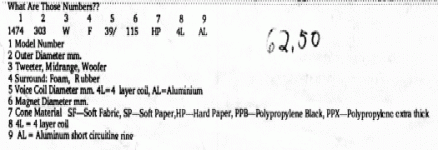

The following is a scan taken from the Peerless page of Madisound many years ago. The numbering system remains the same.
Peerless uses the same numbers to denote the same qualities now, but seems not to make the code to the numbers so easy to get.
Ignore the handwritten "62.50", that was just a certain price for a certain Peerless woofer years ago.
So here they are. 😉

If you want a COMPLETE list, please use this one:
http://www.d-s-t.com/main/tech/codes.htm
Grtz, Joris
