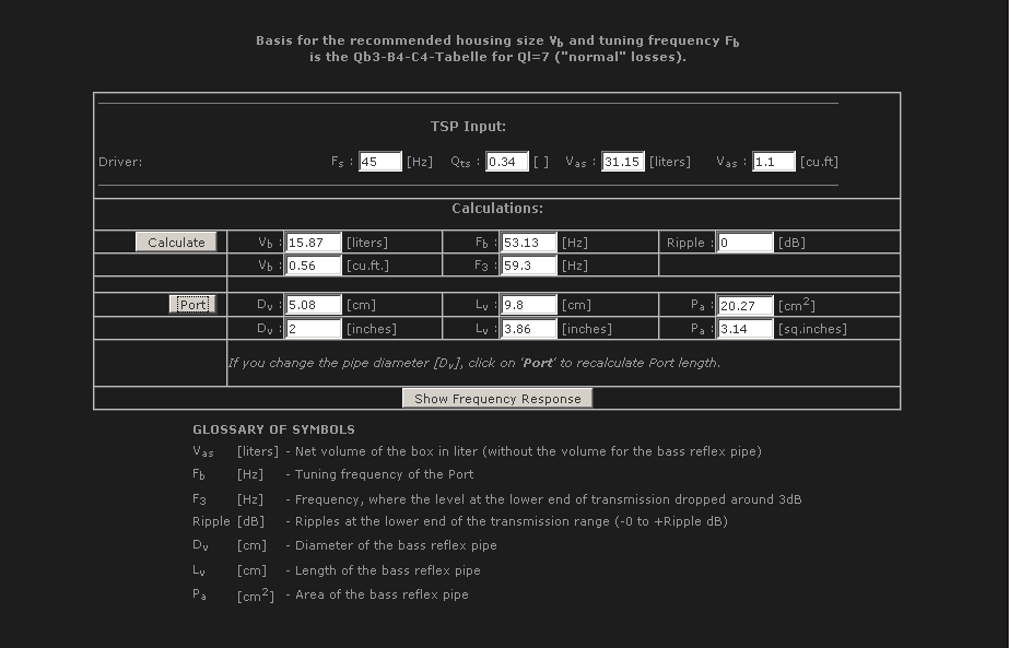

Finally finished up building some bass reflex speakers with these speakers and the recommended notch filter.
I used the following specs to build the speakers (see attachment).
I bought some decent built speaker cabinets with lousy throw away drivers at a thrift shop for $5 for the pair. I installed a new front panel over the existing panel and a new rear 3/4 inch thick rear panel. I have stuffed the top half of the box with polyester stuffing from Wal-mart. It has a 2 inch diameter port tube. I ran some single frequencies through the speakers and at about 60 Hz the bass starts dropping off according to my listening ears (just like designed - how'd that happen?). So I'm setting up my subwoofer to crossover at about 80-90 Hz and see how that sounds. These speakers need to be exercised in the bass regions to get their best bass response. Running some bass frequencies through them for about 24 hrs straight helps.
These speakers are an inexpensive way to try out some full rangers. I'm using them with a t amp and they sound fairly decent and really work well in the higher frequencies. They are actually just temporary speakers while I build some RS 40-1354 TQWT full range speakers. I'll probably move them out to my covered deck and hang them up away from any rain or moisture. All in all I think I spent about $10 per speaker and enjoyed the process of building them.
