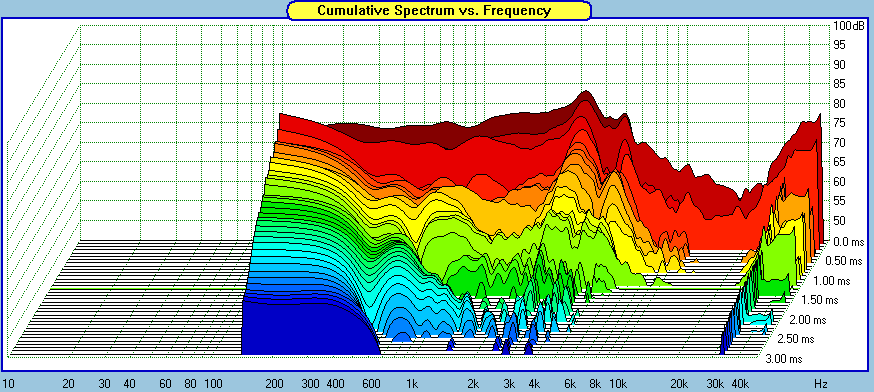

I'm wondering if the tone bursts at 2kHz look clean enough to be acceptable...

But what I'm more skeptical about is energy storage issues...

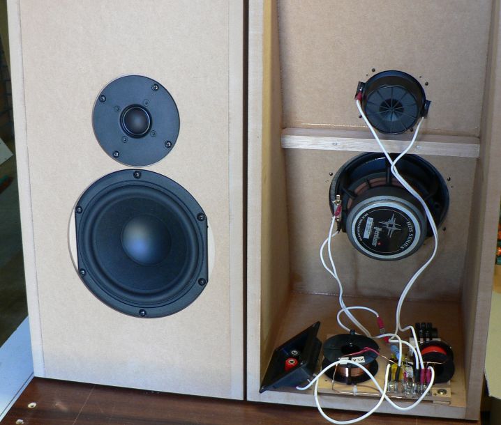

If you are going from 200Hz up, I'd go with the 830883 as it would make a better mid and less beaming. The higher Qts will help the lower frequencies. I've ran trials using a 830875 Nomex in an OB and works very well. The baffle in the pic was a test one for some Scan Speaks but managed to do the Peerless as well.

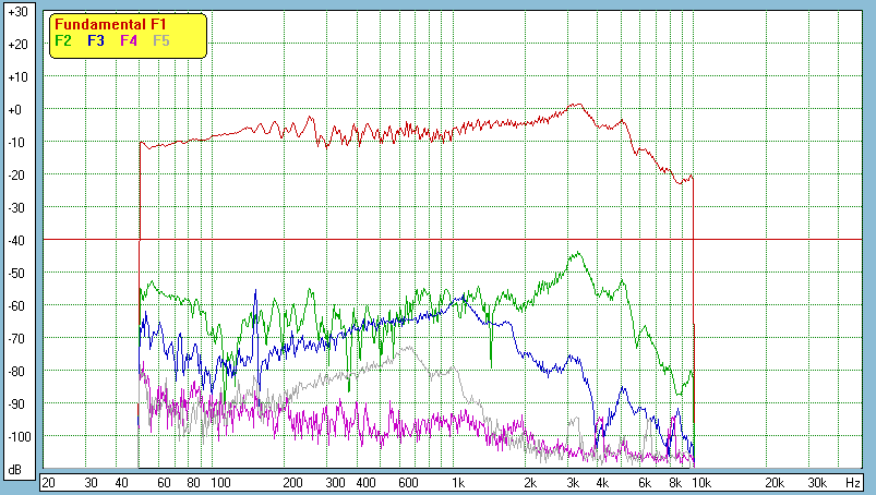

On Zaphaudio.com, we can see that the smaller HDS midwoofers do have the peak in 3d order distorsion due to cone breakup, but it doesn't exceed 2d order distorsion anywhere. I hope the 8" behaves the same... The crossover doesn't remove the peaks in HD, just the peak in frequency response so it is very important IMHO to check distorsion sweeps...
In fact I was wondering if I could "guess" from the measurements of the smaller HDS drivers the behavior of the 8"... Not really scientifical.

http://www.mfk-projects.com/midrange_data_1.htm
http://www.markk.claub.net/Testing/Woofer7/Peerless_HDS_exclusive_7.htm
Those two measurement show quite well how the linear distorsion of the 8" is degraded above 1000Hz, which can also be guessed from John Krutke's measurements.
