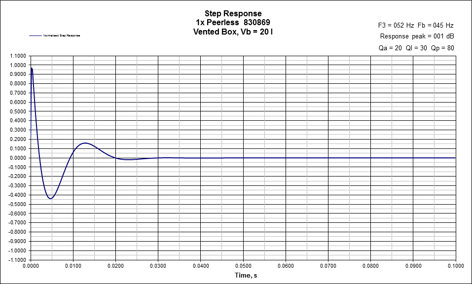

I just tried to replicate your bass response in unibox, you have it in a 20L sealed enclosure?!
If you want to go with something that small, then I think that 20L vented tuned to 45Hz would be a good compromise between bass extension and transient response.
Attached is comparison between sealed 20L and vented 20L tuned to 45Hz. also attached is step resonse for the vented, which is VERY good for a vented enclosure!
Tony.
Tony.

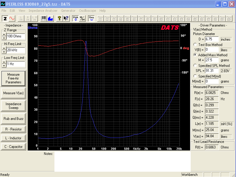

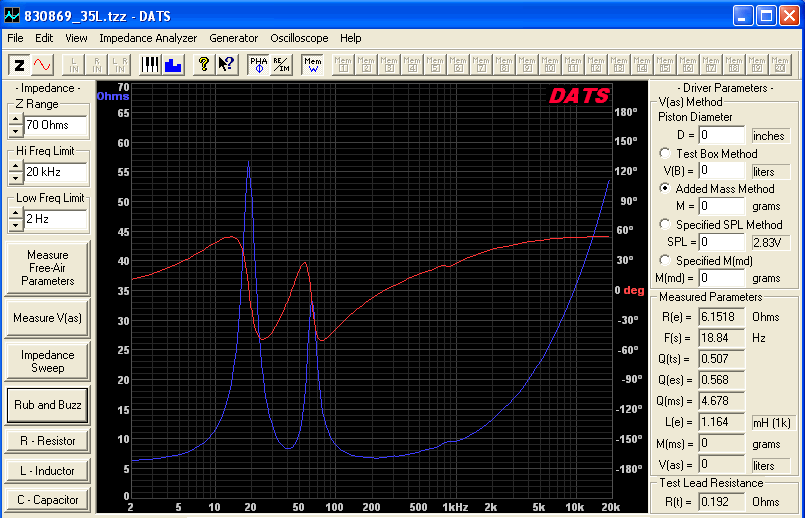

hi andreaemme
I found the zma files for you. There are 2 sets, one is in Free Space and the other is when loaded into a 35L vented box.
I'm afraid I can't find the frd without any crossover. All I have are frd with crossover already installed.
I can't upload with zma extension. After you download, change the txt to zma.
I've tried the 830869 in vented boxes of 20L and 35L. With 35L, it goes lower but midbass is very weak. Reducing the volume to 20L and tuning the box slightly higher improved the midbass at the expense of low bass. These are all with a 2-way designs. Hope it helps.
Actually my post above was after a very quick simulation, it looks better with 42Hz tuning.

Thank you very much fot your interest and for measurements but after your comments I'm planning to continue my search of a mid-bass punchy woofer, also because I can't go down 30 liters in my existing cabinet.
