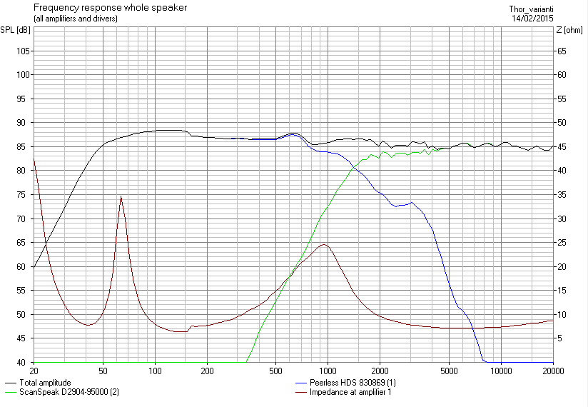

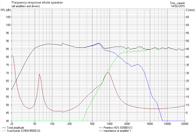

Thank you very much Wintermute, this is the reason because I'm looking for better data than my frd and zma:
this is a simulation using your zma file (and related Tymphany T/S parameters)
this is instead a simulation using zma file I've built from anothe datasheet (in which T/S parameters are slightly different and also crossover was optimized for that): I can't get a reason for the 150 Hz peak as the 650 one!
I'll use your file! Just a question: is your zma measured or extracted from datasheet? in the second case, how do you build minimum phase? I've used Response Modeler application but I think I've made some mistake.

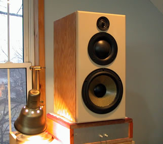

Frankly, I was quite impressed with the speaker+horn combo. The Peerless, as well as the Selenium/horn, are quite friendly to work with.
One thing I noticed with this Peerless 830869 is that it is a very "Polite" driver. No funny peaks to deal with but at the same time, I feel it lacks some punch in the midbass. The speaker sounds much better if a 12" for the bass is added. Of course that would mean using the Peerless mainly for mid duty, like 100Hz to 1,500Hz. The speaker really comes alive then. But the downside is more cost and more complicated.

This is not my daily speaker. I was basically experimenting. I wanted to hear what the Selenium and horn combo sound like. I was pleasantly surprised that the combination sounded pretty good. I heard complaints about the Selenium D220ti being harsh or bright but I heard nothing of that sort. Maybe it was simply a question of not being able to control it. As with most compression drivers and horns, it's essential to have some reliable measurement tools to work it. Without it, it's easy to sound bad.

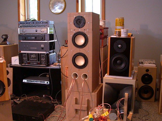

Presently, I'm listening to the speaker below. It started out as an evaluation of 2.5 concept. It ended up a bit more complex. The tower is essentially a modified 2.5 in the sense that the upper HiVi M5a is a Band Pass. Otherwise, the midbass gets bloated. The lower M5a has only an inductor.
This on it's own would be acceptable. But I like my music to go down to about 40Hz. So I added a bandpass sub, the one right below. After some re-tuning, it really sounds nice. The system is fully passive, even the bandpass sub. Within is a 8" Dayton SD215 DVC. Cheap and good.

Hi I extracted it from the datasheet using nth technologies spl copy and then extracted the minimum phase using the minimum phase extraction spreadsheet (I can't remember where I got it from so have attached it here).
I assume you have spliced your modeled low end response to the traced response? Did you use the frequency response blender? It is really excellent and will adjust for baffle step as well. software I highly recommend it!
