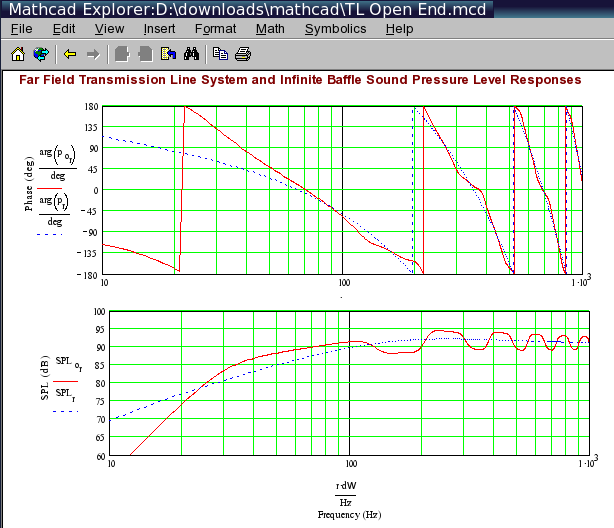

I built recently a pair of small speakers mainly for the computer audio. These speakers use the Tang-Band W4-655SA fullrangers. (The "four euro fullrangers" I bought earlier were not so good-quality. These ended up on my garage shelf.)
The TB:s sound surprisingly good but they're not so efficient with lower bass sounds. So could I use a single Peerless 8" CSX 217 woofer as a subwoofer, playing the ~30hz...~100hz area?
TL's interest me, so I decided to simulate this driver in a TL box. What do you think about it? Is the driver too "weak" to be used as a sub?
L : 75 inch
S0 : 2,7 * Sd
SL : 0,5 * Sd
stuffing 0,2 Lb
http://www.d-s-t.com/link/peerless/data/850136.htm
