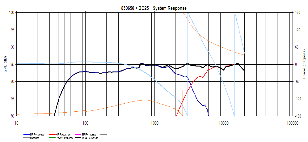

Here is - 15 degrees off axis, on axis even slightly better (more constant response between 3k and 6k hertz). I'll buy some extra resistors for fine tuning by ear the tweeter response.

I finished my project and wanted to thank all who gave suggestions. Now I'm only playing with stuffing, trying to find the right amount, and since I made removable baffle this is a fast work.
While I'm typing I'm also listening to the speakers and I find they sound good, with natural voices and good timber of the instruments. So I'm really satisfied.
The box are 12.4 L tuned to 50 Hz with a 190 x 325mm baffle, woofer is 125 mm from bottom and the tweeter is 255 mm with a 15 mm offset. I'm attaching a description of the xo. The speakers are finished in bamboo veneer (*) with a hardwood baffle (ayous).

Yes.
The 1.8 ohm resistor is for the L-Pad, and should be a "normal" value. However, the 1.5 ohm one, is not really for a zobel network, but for a 2nd order xo with an added resistor and when this resistor is low, it slightly modify the output in the xo range. I found the info on this forum, but I'm not able to find now the reference.
Ralf
I can be wrong, but if you see as a whole the part of the circuit with the two resistors and the tweeter, the total resistance should be:
r = 2.7 + 1/( 1/1.8 + 1/3.1 ) = 3.8 ohm
(where 3.1 is the resistance of the tweeter)
I don't think this is a too low value, but as I said I can be wrong, and I'm wishing to know better.
Ralf
