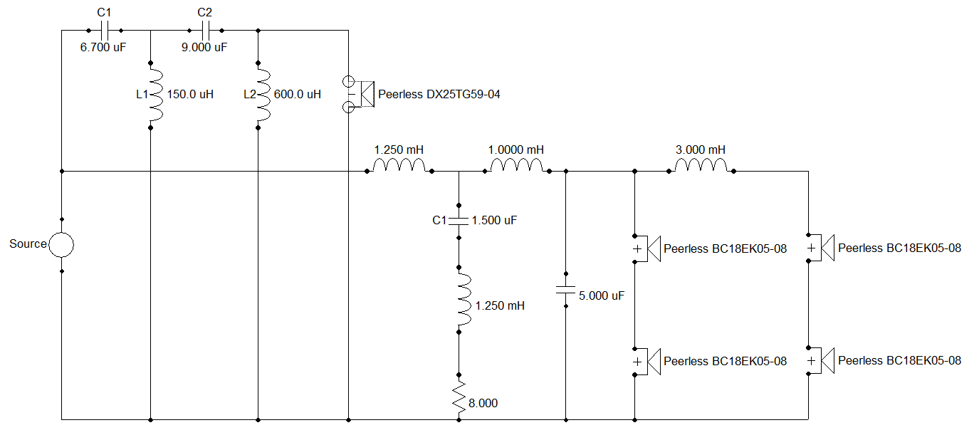

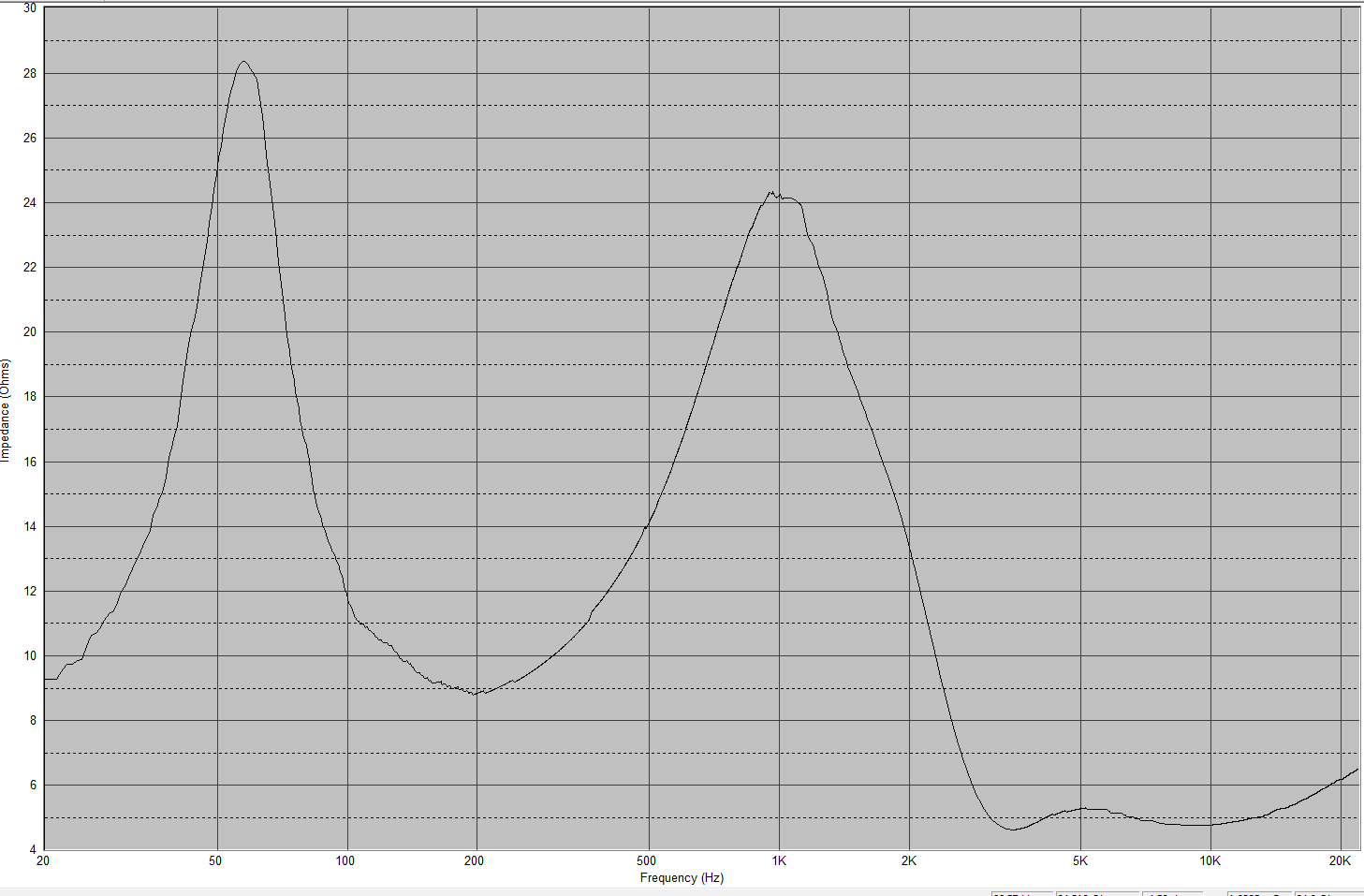

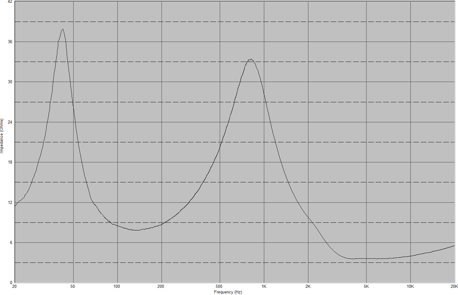

Goal is to see what i could do with relatively cheap drivers and to get system sensitivity >= 91 dB. Limited my tweeter choices (as you can see - no padding).
Minimum impedance 4.6 ohms @ 3,600 Hz.
Given the flange of the woofer, you could get away with surface mounting these so no need for a router if you can't do recessed holes.

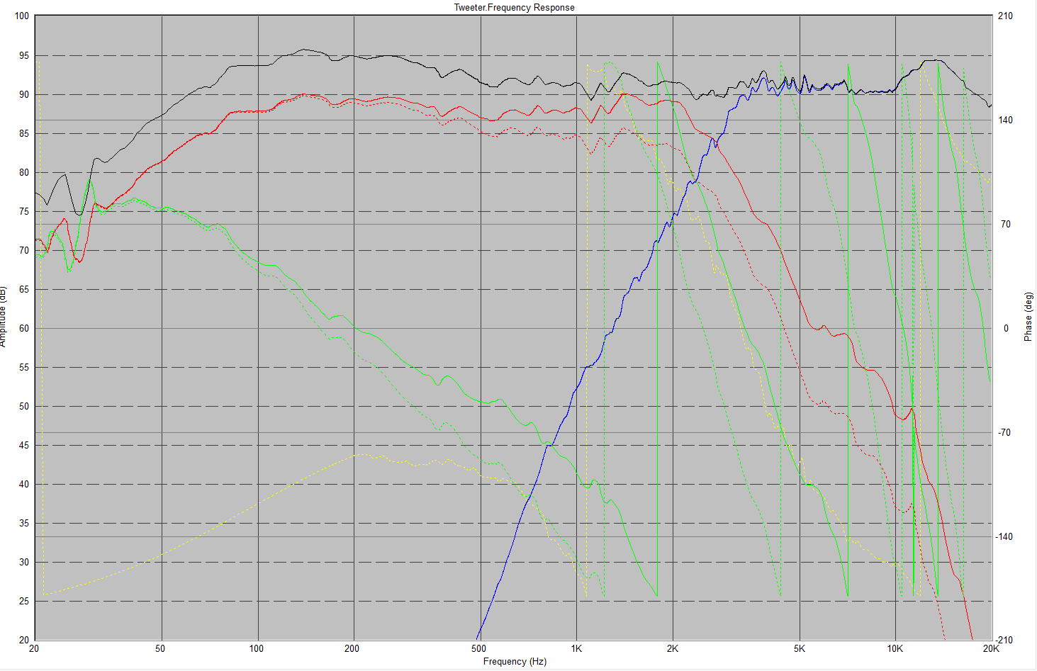

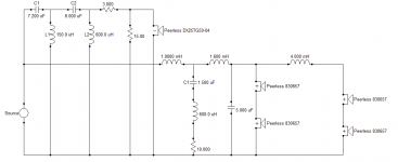

LR4 acoustic target. Crossover point high (~2,600Hz), but in order to protect the tweeter. Went as steep as I could without going fancy.
Drivers:
Woofer - Peerless BC18EK05-08 6.5"
Peerless BC18WK05-08 6.5" Paper Cone Woofer
Tweeter - Peerless DX25TG59-04 1"
Vifa DX25TG59-04 1" Fabric Dome Tweeter

Cheers. I actually swapped the BC18 for the 830657 and paired it with the DX25 before I found Paul's project above (The Tarkus). I'm just redoing the crossover with these. I need to model excursion because 3.64mm xmax doesn't give you a lot to play with.

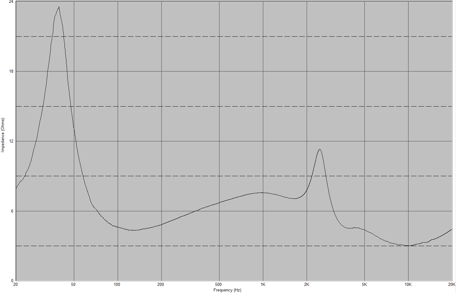

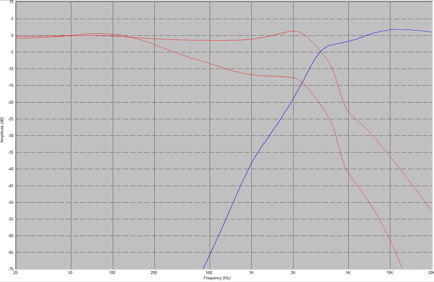

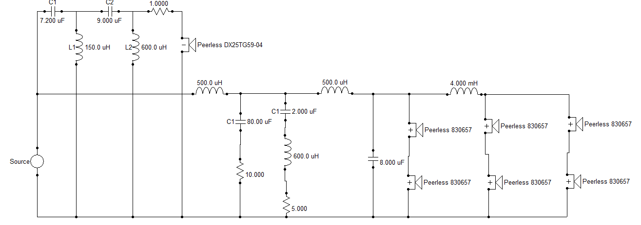

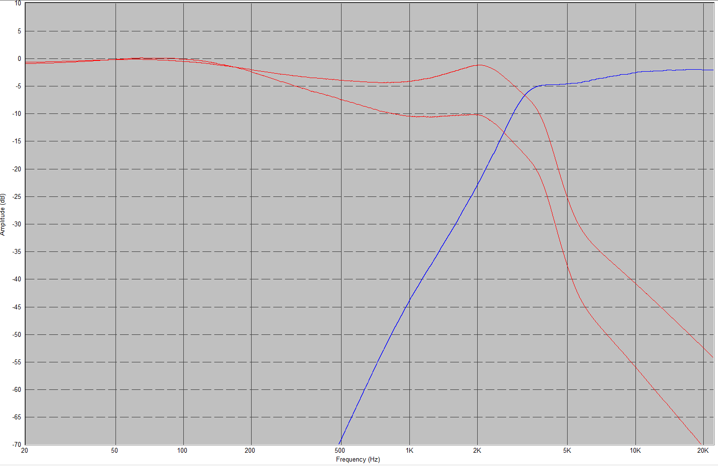

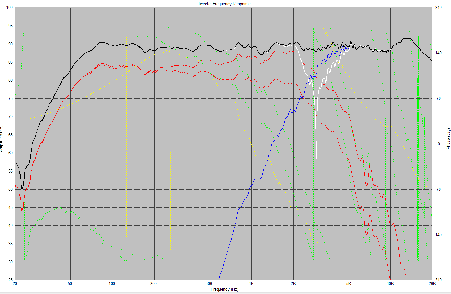

Agreed on the 4 ohm challenge. Latest modeling attempts are not looking Z healthy at higher frequency (3 Ohm dips). Stay tuned....

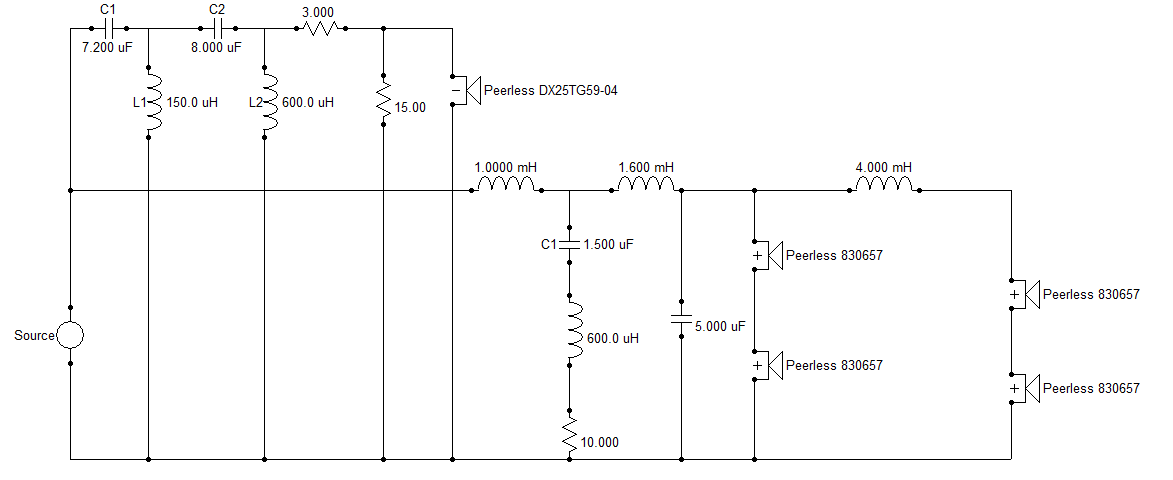

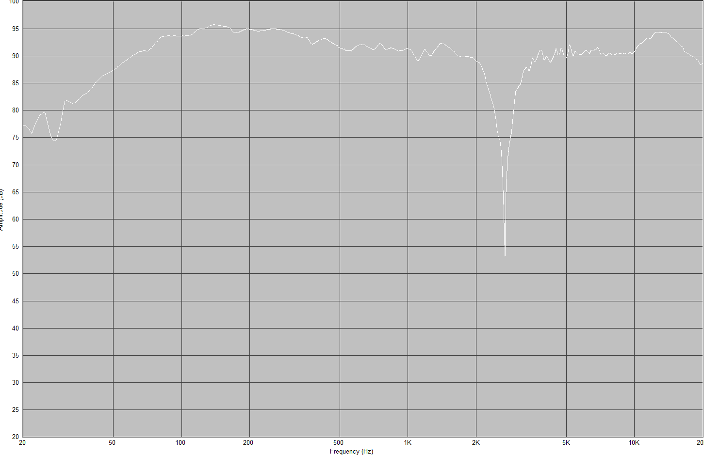

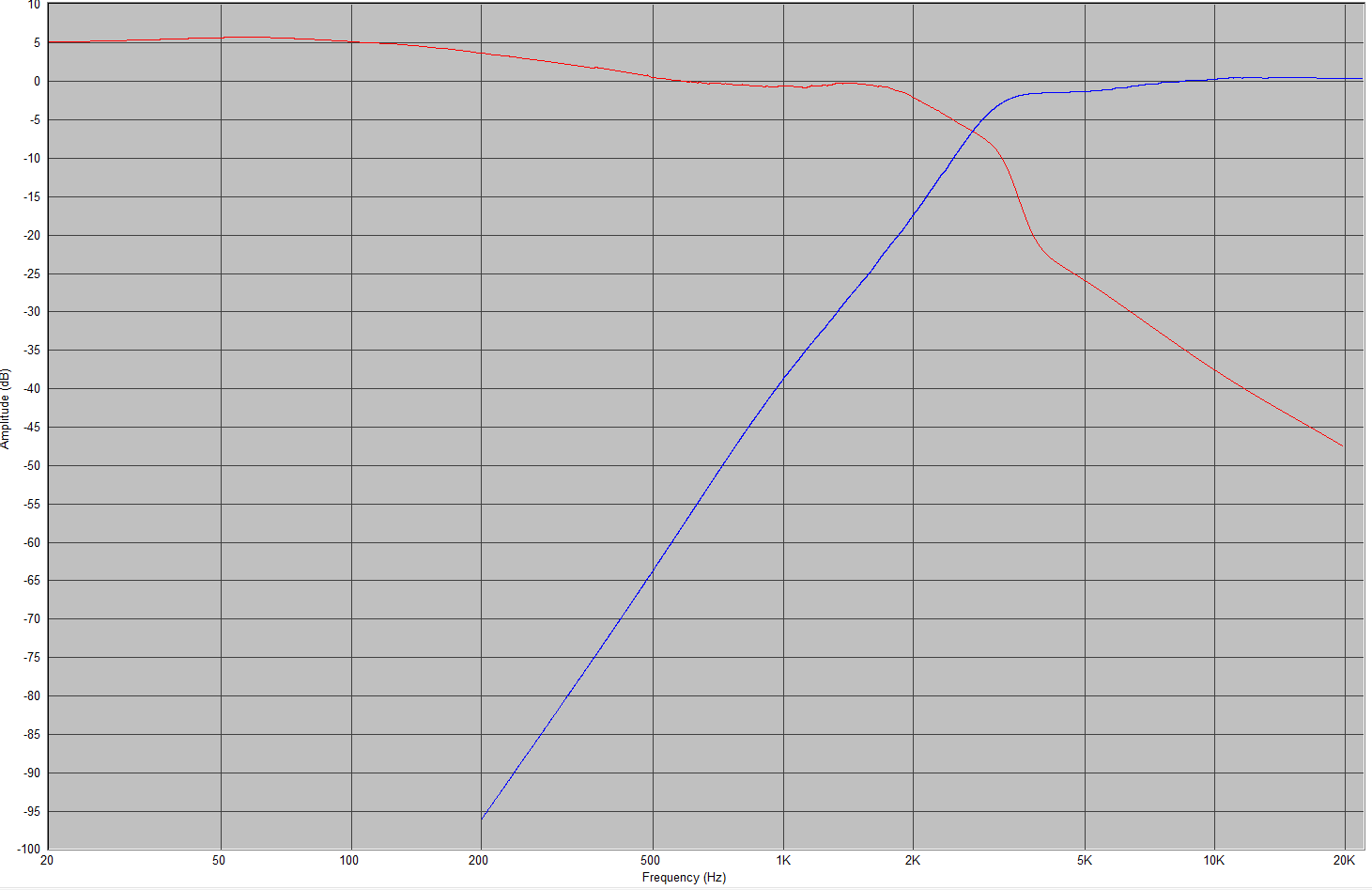

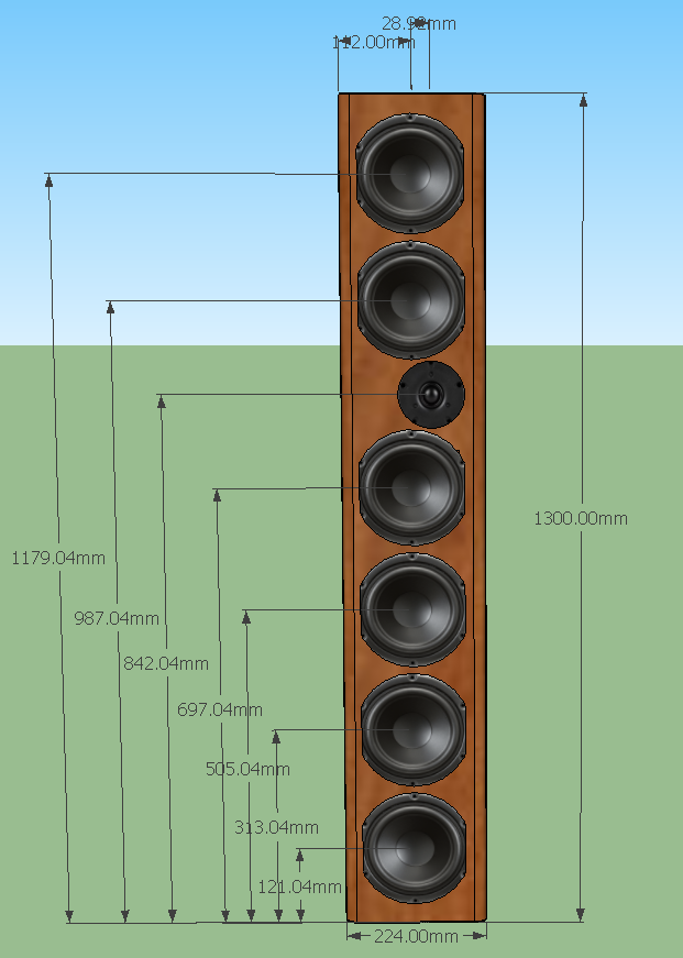

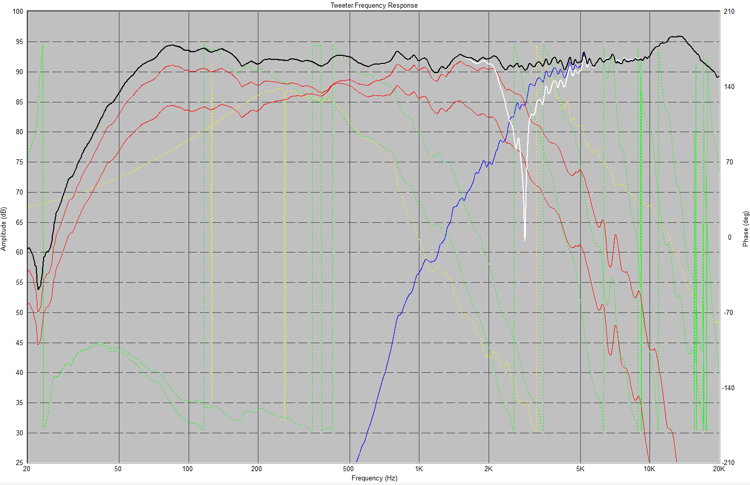

I've come up with 2 designs, both using the Peerless 830657 woofer and Vifa DX25TG05-04 (aka Scan speak D2604-830000).
Design "A" - a 4 woofer MTMMM 2.5 way. Min impedance 3.6 ohms between 4KHz and 7Khz
Design "B" - a 6 woofer MMTMMMM 2.5 way. Min impedance 3.0 ohms at 9KHz
Enclosures
A - 80L vented, tuned to 40 Hz, F3 = 54Hz, Max SPL 111dB. System sensitivity ~ 89 dB (including ~ 4 dB baffle step compensation)
B - 120L vented, tuned to 40 Hz, F3 = 54Hz, Max SPL 114dB. System sensitivity ~ 92 dB (including ~ 4 dB baffle step compensation)
The remainder of the images in this post relate to the A design
Hi Dave,
I vote for the A design MTMMM - 80L vented, tuned to 40 Hz, F3 = 54Hz, Max SPL 111dB. System sensitivity ~ 89 dB (including ~ 4 dB baffle step compensation)
They are already very big speakers !
IMHO if you want more sensitivity go for more sensitive drivers not for more drivers.
