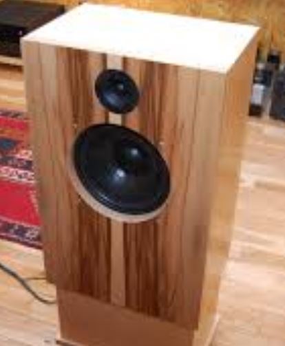

Any thoughts on using the Peerless 830668 ten inch mid/woofer in a two way?
It seems to me that it could work well when used in conjunction with say an SB Acoustics ring dome TW29R which can be crossed quite low around 1500Hz .
It has very smooth roll-off with minimal break- up so also might suit a simple crossover.
It also suits a sealed box which for me makes it very appealing.Not a fan of ported bass.

I've designed with Peerless 10" woofers and I love them - for three way systems. The largest woofer I would ever use in a two way system is 8", and even then you may need to go three way. Peerless woofers have far better midrange output than almost any other brand (for woofers).

If you compare the frequency response curves of the Peerless 830668 and the Seas A26 RE4 they are really not too different.Yes the Peerless has a slight peak around 2000Hz compared to the Seas but it also rolls off much sharper from around 3000 Hz which might make it even more suited to a simple two way with no crossover on the woofer.Off axis response is very good right up to the natural roll-off which is often the problem even with much smaller drivers.

Let's assume we are hopeless noobs when it comes to this. It is best to see if this sort of thing has a hope of working first. We should look at a prototype of the already legendary DeVore Orangutan 96:
That incorporates some good ideas just from looking at it. I would expect no less of John DeVore. But I'll bet you he has a few crossover parts in there beyond a cap and a coil.

Actually, there is a fair amount of breakup, it just happens to be complementary with the voice coil inductance.It has very smooth roll-off with minimal break- up
Looking at the datasheet, the minimum impedance is about 7.3ohms at around 150Hz. If we look at the datasheet plot at 2kHz we find it is about 21ohms while the frequency response is about +2dB compared to 150Hz. Three times the impedance means 1/3rd the voice coil current and therefore should make the response fall to about -10dB. Therefore the cone is actually breaking up 12dB at 2kHz to achieve an overall +2dB response.
What this means is that the midrange distortion is going to be boosted up by 12dB compared to a driver which has a perfectly well behaved cone. The SLS series are built for subwoofer applications so less thought has been given to controlling the voicecoil inductance and instead more attention has been given to maximising excursion to deliver clean bass.
The result of this is that the midrange distortion is going to be higher than drivers built as 'midwoofers' (like the Peerless HDS series) even before the 10" cone has added it's +12dB zing to the distortion.

For a 2-way system, I still recommend an 8". Even that will have Doppler distortion. It will be worse with a 10" woofer. You really are in 3-way territory with a 10" woofer. Otherwise you'll be crossing the woofer off a bit lower and asking even more from a tweeter.
Can you make a 2-way speaker system using a 10"? Sure you can. Performance will suffer and later on you might discover how to make similar systems (but 3-way) that sound a lot better. Remember, 2-way systems that have good response in the bass ranges will have Doppler distortion higher up. It's annoying once you identify it.

Well, since it is a new build that needs things like wood ordered, I thought I'd raise the issues I have seen with that design. Having made several 2-way systems with 8" woofers for people before. A 10" - even a really good 10" like the one being considered will magnify the shortcomings.
Still, it would probably sound better than a full range system, and probably a 6 1/2" 2-way as well. But a 6 1/2" with a tweeter that uses a 10" sub works extremely well. Witness my PSB Stratus Gold speakers, that's the basic design they followed.

10" midbass plus tweeter does seem to be the ideal scenario for a compression driver horn tweeter with a PA midbass.
Doing it with your regular lower efficiency drivers has some problems.
But really it's just a stretch of the 8" bass plus 1" tweeter idea.
So for sure you need a big tweeter that can cross around 2.5kHz if you go near natural 10" bass rolloff. The SB ring radiator doesn't look ideal to me, since it has a high FS impedance that won't work nicely with a single cap and 6dB electrical slopes.
John DeVore's (ferrofluid?) Morel waveguide idea looks good. But I still don't like single cap. What might work better is the old negative polarity idea around 2.5kHz with a high order tweeter crossover. That might work with the SB tweeter too. This is a plan because big woofers have fierce time alignment problems.
You need a very well-behaved woofer too, IMO. Use its natural rolloff. Some poor demented soul at this forum is currently trying to do something like this with an SB 10" metal woofer currently. He is currently working on a 1200Hz crossover with breakup notches to make it work, and getting all sorts of phase problems too.
