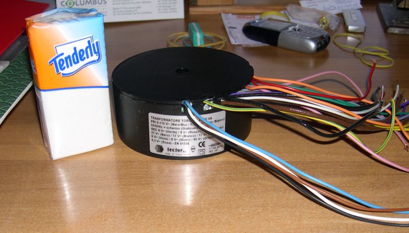

Good news
Hi all,
today I received the trafos back from Tector.
They weren't completely filled with resin but now the assembly looks much more solid to me.
Enclosed a photo....

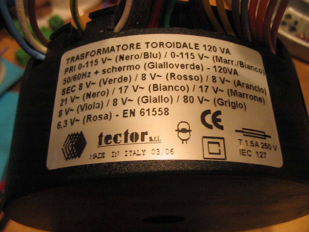

Hi Andrea --
Just to let you know, I received my transormer today. I know I speak for everyone when I say that I (we) really appreciate all that you've done to make the group-buy happen. Thanks again.
One last bit of housekeeping, for the benefit of those who don't speak Italian, could you post the English translation of the winding information on the side of the trafo? Thanks.

I don't have the trafo here but I can see the colours from the photo and make a quick translation:
Nero = Black
Blu = Blue
Marrone = Brown
Bianco = White
Giallo/Verde = Yellow/Green (shield)
Giallo = Yellow
Rosso = Red
Rosa = Pink
Viola = Violet
Arancio = Orange
Grigio = Grey
If I missed something just let me know.

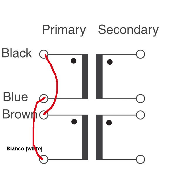

Andrea (or anyone who knows):
I got one of the Tector transformers from the group buy awhile ago and am just getting around to completing my DAC (rev1.1b). I had a question regarding the primary color coding. There are two pairs of 115V primary windings; blue/black and white/brown. What is their phasing for North American use? I looked all over Tector's website and I could not find wiring/color code diagrams. I have all the secondaries figured out, but need to know how to parallel the primaries for 115V use. Thanks!
Chris
Chris
I took a look at the label and realized from memory that I had messed up the pairs when I wrote the previous post. I confirmed with Tector that the correct wiring is as the below diagrams I sent them:
Glad you got that sorted, Chris. I was going to post, but realised it was the phase you were after.
Jon
