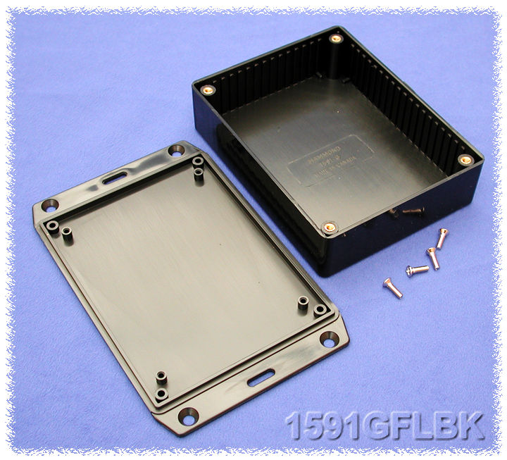

Your main problem is the case, the "electronics" part is easy, just get a chipamp kit.
An LM3886 or something.
You'll need an aluminum box that contains the amp and PSU and still fits in the pedalboard or, *now* that I'm thinking about it, just to get a flatter pack, the job might be split in 2:
1) a self contained PSU, with transformer + bridge + main caps supplying, say, +/-22 V or whatever the chipamp needs *plus* an auxiliary regulated +9V @ say, 1A (or 2) to power a bunch of pedals and
2) a small aluminum box or chassis with *only* the chipamp and a flat heatsink.
This way we only *need* aluminum for the chipamp dissipation, and the PSU can fit anywhere, even in a plywood homemade box or a plastic one.
3) thinking even further, the chipamp does not even need a *full* case but may fit in a section of extruded aluminum railing which may also be part of the heatsinking .......
Think ... think ...
