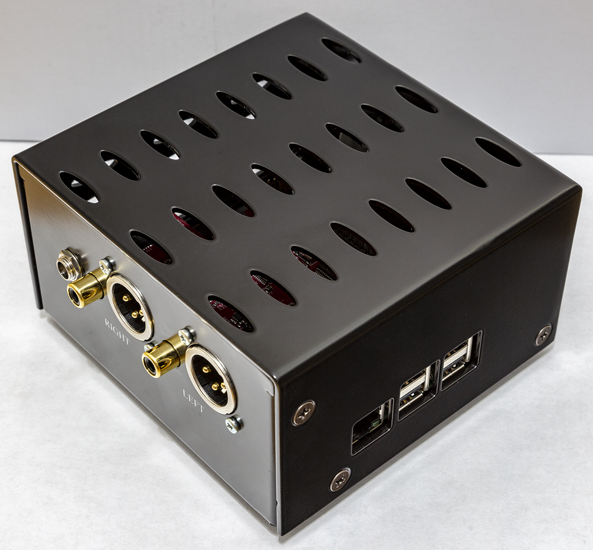

Improvements over previous generation DAC include:
The PecanPi Streamer is a ready to go plug and play streamer, that uses the PecanPi DAC, and will be available with the following software options:
Discounted preorder will be available shortly through Orchard Audio's website
- Fully linear ultra low noise power supplies
- Re-clocking with Crystek femtosecond jitter oscillator
- Built in HW volume control (no Volume-Clocker needed)
- Built in high performance headphone amplifier
- Full size XLR connectors
- Ability to back-power the Raspberry Pi
- Improved thermal design
- Aluminum case available

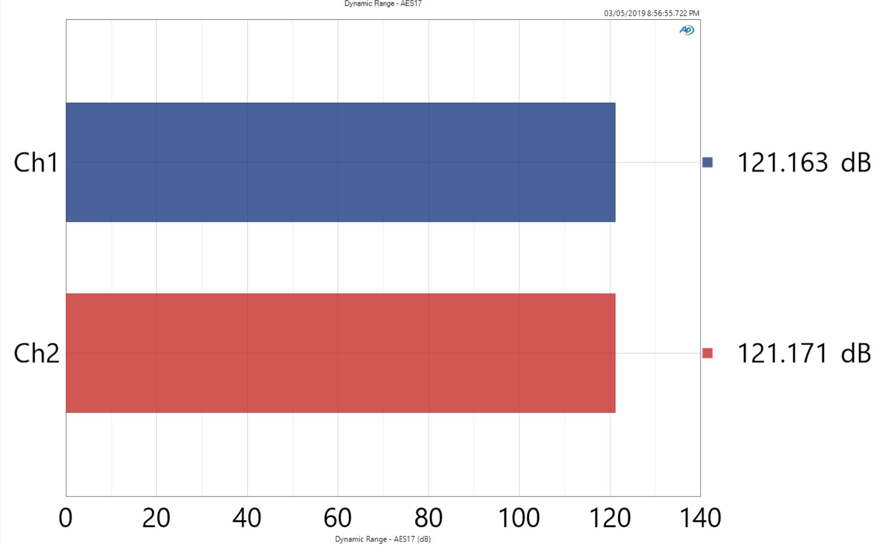

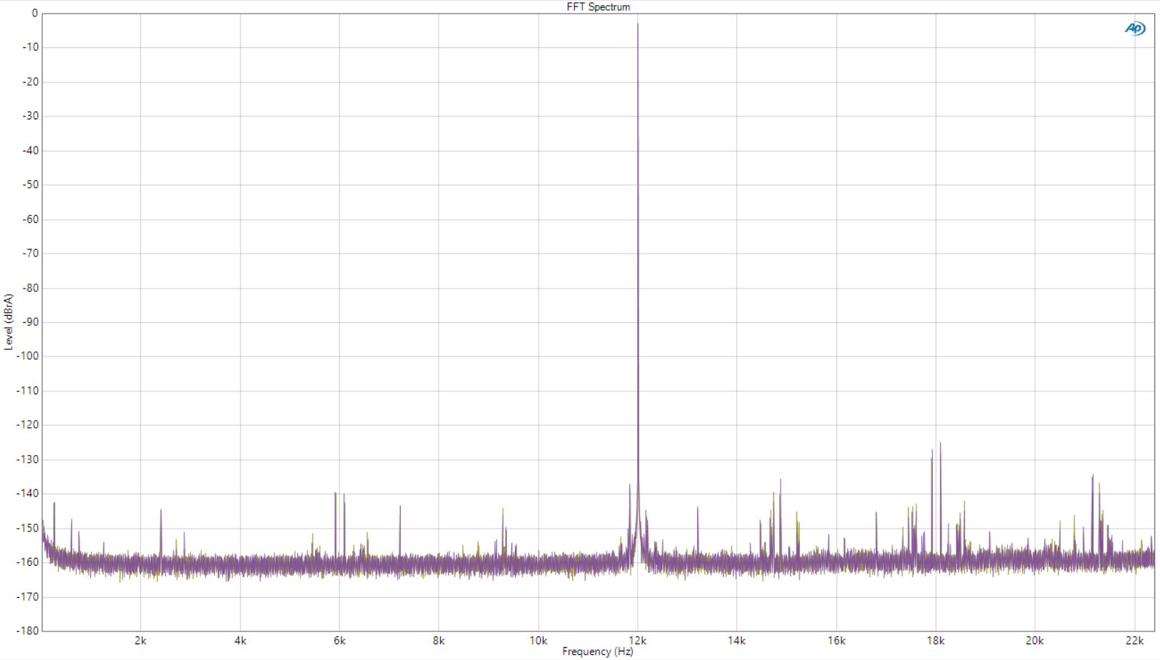

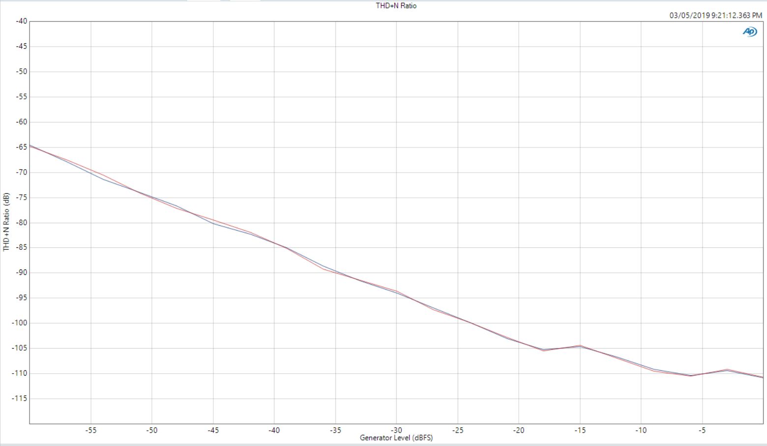

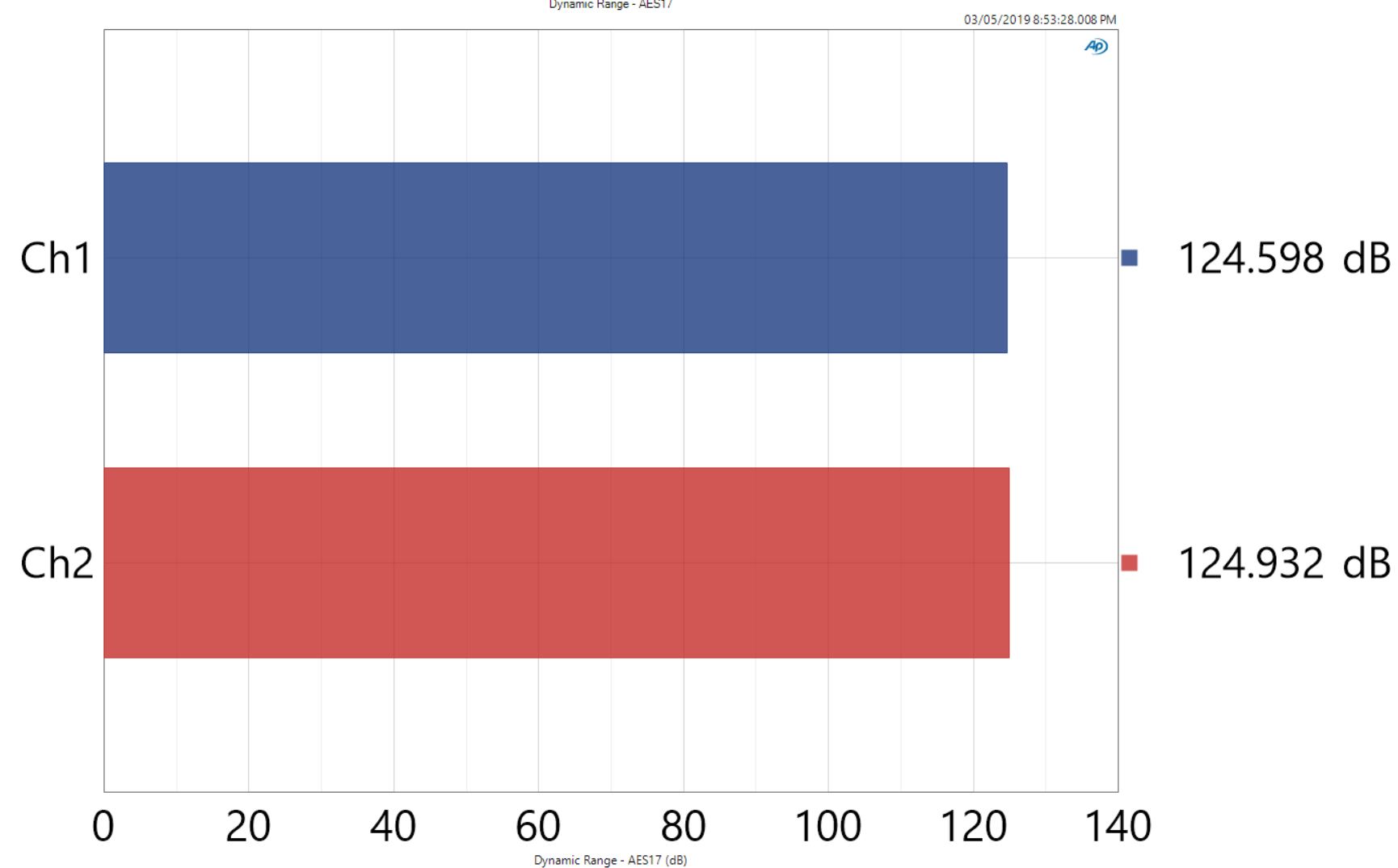

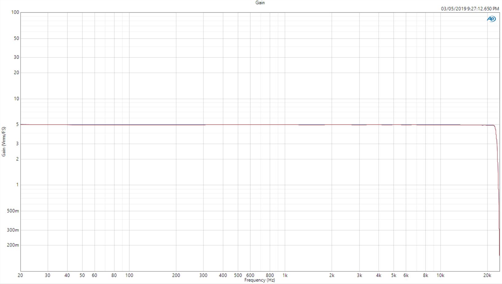

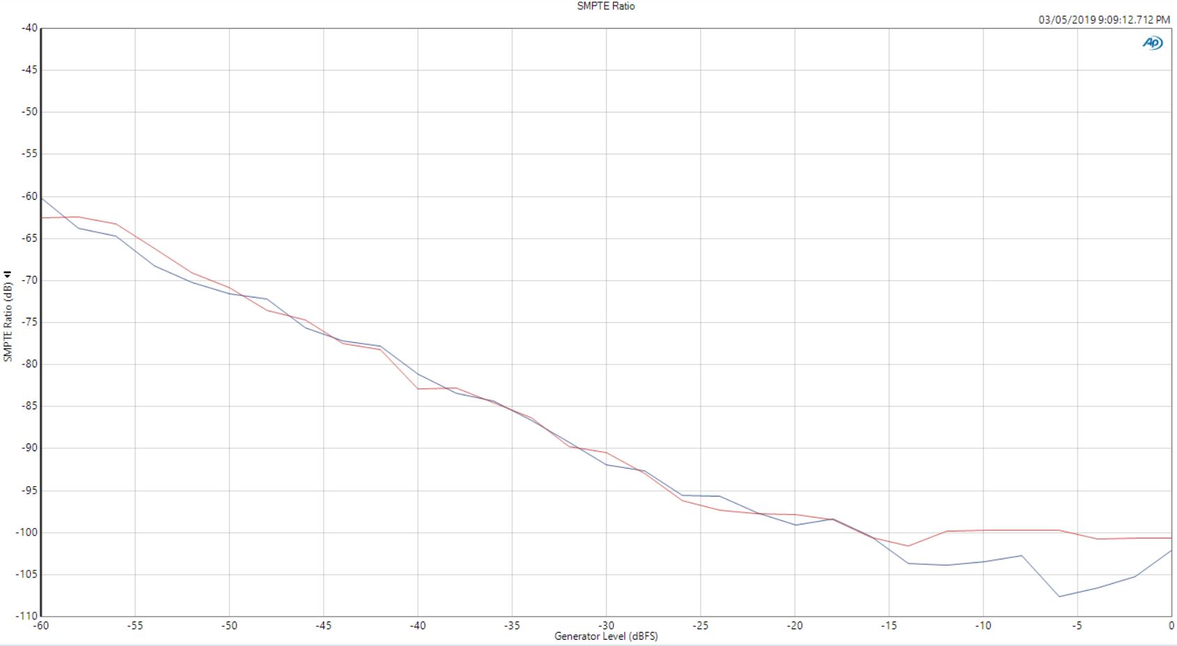

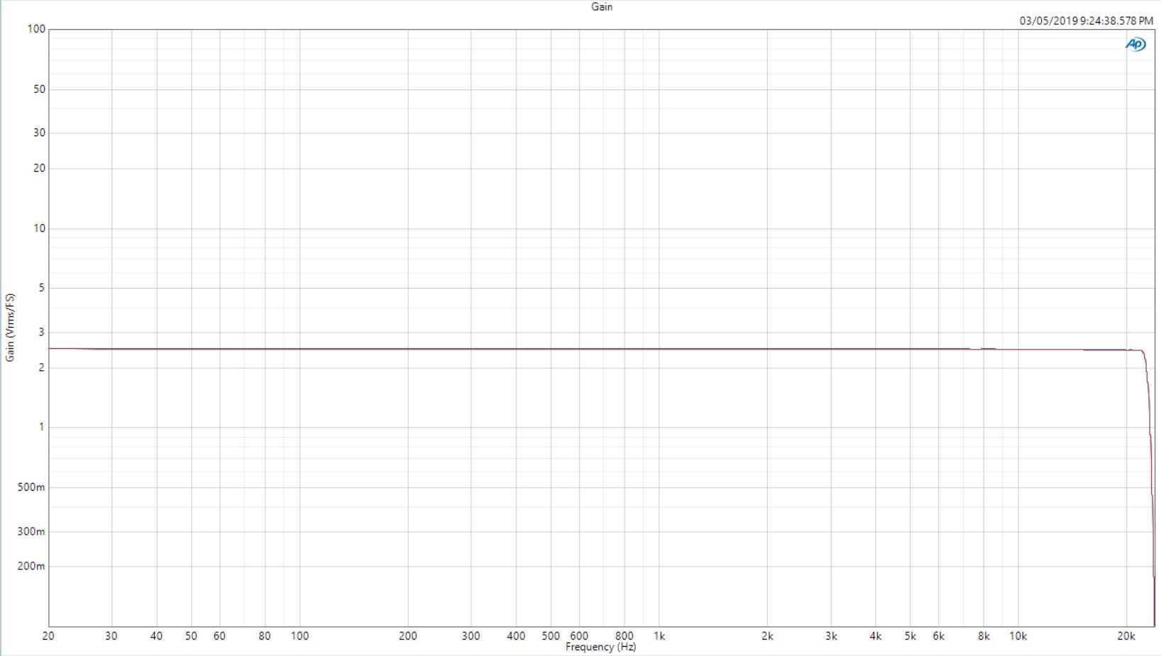

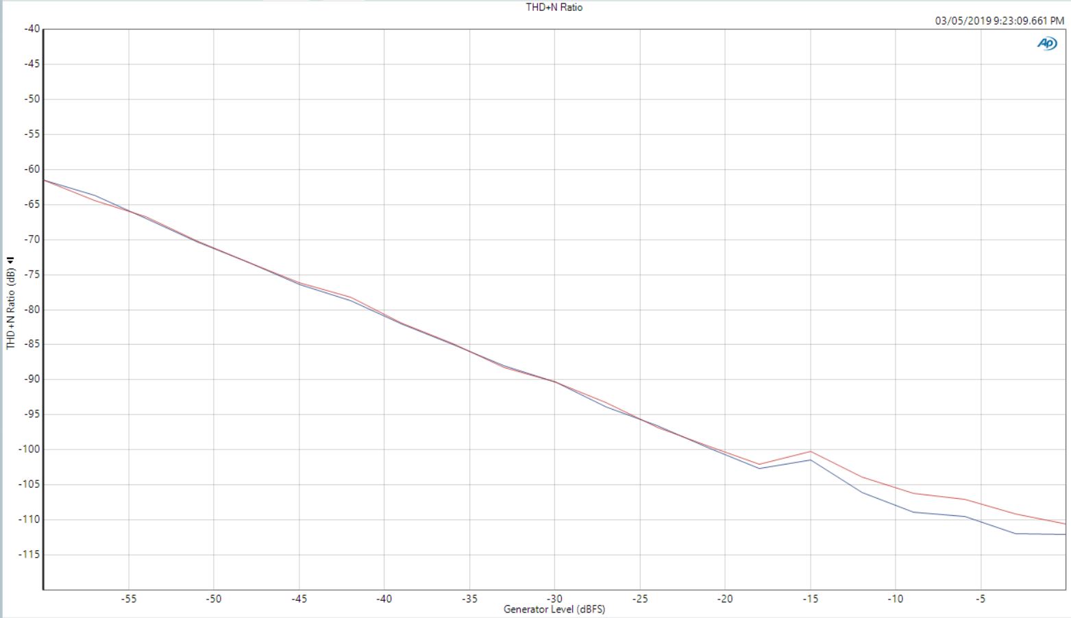

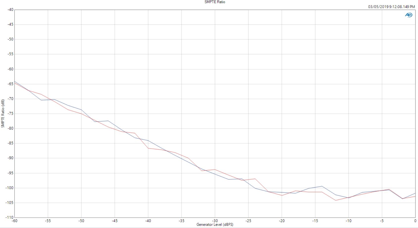

See attached images for test results.
There are two sets of images, the first image is for the XLR output, and the second set is for the RCA output. The image name describes what each test is.

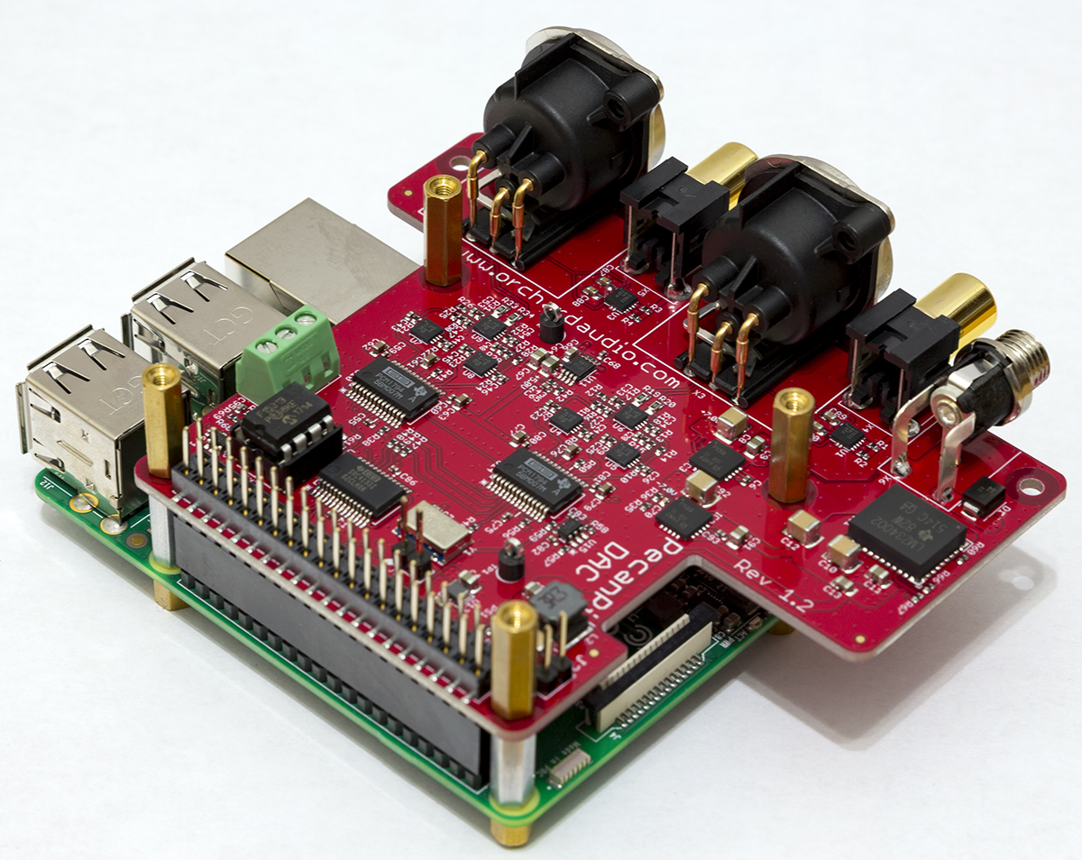

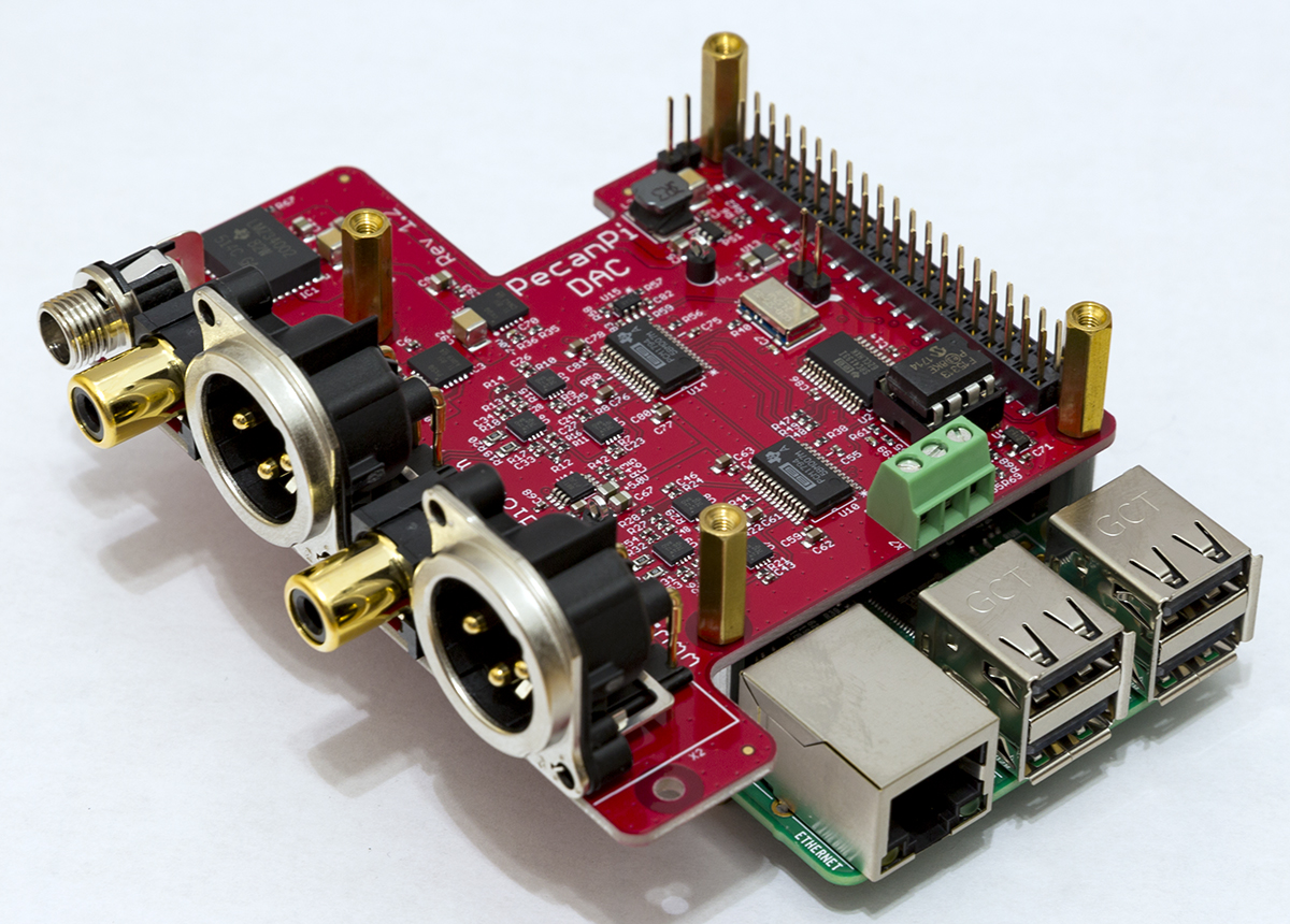

PecanPi Implementation Details:
DAC chips:
-- Dual flagship Burr-Brown PCM1794As in monaural mode
Digital HW Volume Control and Re-clocking:
-- Crystek CCHD-575 oscillator -- ultra low clock jitter of 82fSec
-- SRC4193 for volume control
Output stage: True balanced dual different output stages
-- Uses OPA1612s
-- Low Noise Panasonic Resistors
-- Proprietary filtering topology
Ultra low noise analog power supplies:
-- TPS7A4700 (4.17uV noise) for positive op-amp power supply
-- TPS7A3301 (16uV noise) for negative op-amp power supply
-- TPS7A4901 (15.4uV noise) for DAC Chips
Headphone driver:
-- Dual parallel OPA1622s

No mute pin?
The mute is taken care of internally either when the BUS has zero (0) data on it or when the bus is down.
