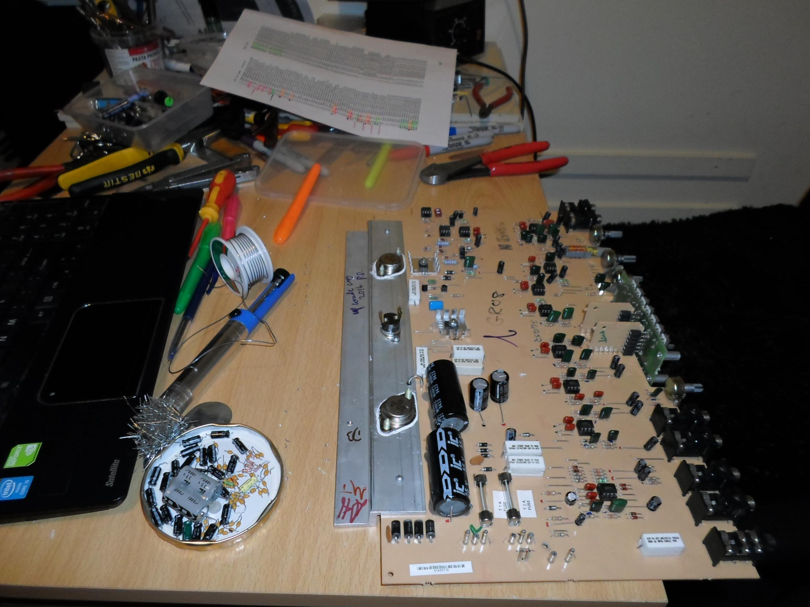

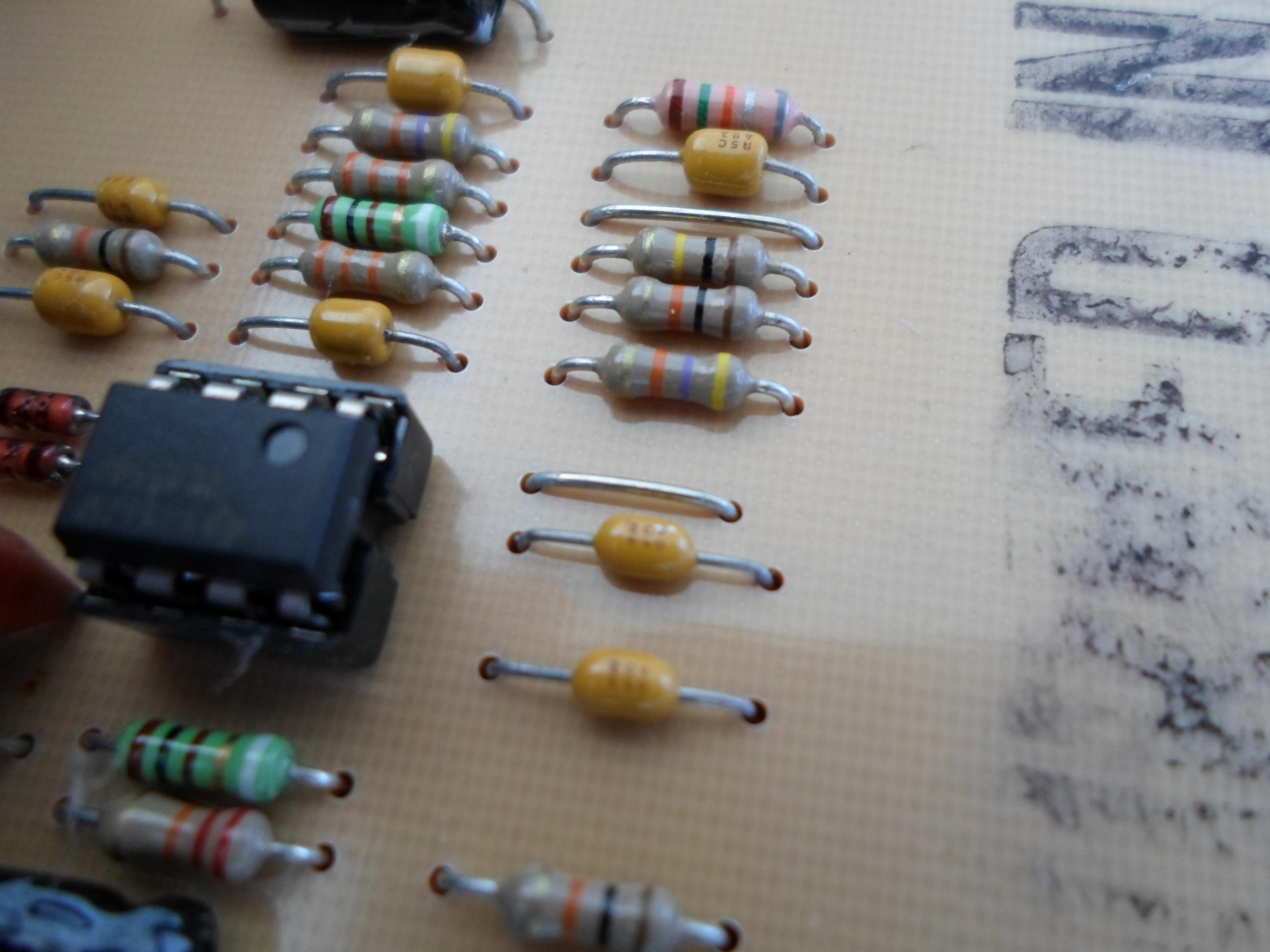

The tan ones were cheapo 50v ceramic power bypass caps. Several were blown open in my 1998 PV-1.3k. I doubt if those were CG0. I replaced with salvage caps from a PCAT power supply with a higher voltage rating.
The green things looking like resistors might also be ceramic capacitors, check the schematic. I had some of those blown too, in the DDT and VI limiter circuits. 50 v rating in my amp. I replaced with 200 v rated caps +-20% so they won't blow the next time the output transistors do. The gold band indicates a more precise cap than the tan bypass caps, I think. I used film caps; they stuck up a little more than the green ones but there was room. CG0 is hard to buy from my usual vendors, no sense paying $10 freight to get a $.80 part when a $2 one will do.
I thought they were bit budget using ceramic, i just swapped them all out except the resistor looking one because they were such low value, and left the power supply ones.

Post #1, he says a TKO from 1993. Looking at the photo, I suspect it is a TKO115 '92 model. Schematic here:
http://bmamps.com/Schematics/Peavey/Peavey_TKO_115_(7-92)_Schematics.pdf

I just bought the amp last week and it was sounding pretty flat compare to my friends i used to play through about ten or so years ago (his hadnt had much use), so thought i would do the electrolytics, there was only about two films caps in the whole amp so thought film would be an improvement.
i replaced the polarized and ceramics at the same time so im not sure what sorted it.
its sounds much better after about three hours of playing, not sue if i will pull it apart again and swap the ops, the designers might get peeved if i change the sound of their amp they spent years developing. they would probably tell me to go build my own

Power bypass caps are best as ceramic, for stomping out out high frequency transients like bouncer radios(transmit), cordless mikes, & cell phones. 4558 are not particular of power supply cleanliness due to the slow slew rate spec, interesting you got by with film for the little tan bypass caps.

I left the really low value ceramics that look like resistors in because i didnt have that lower value films. I wondered about the headphones because the only amp i ever killed was a 45 solidstate practice amp before i new anything about amps and its was when i started using headphones in it.
