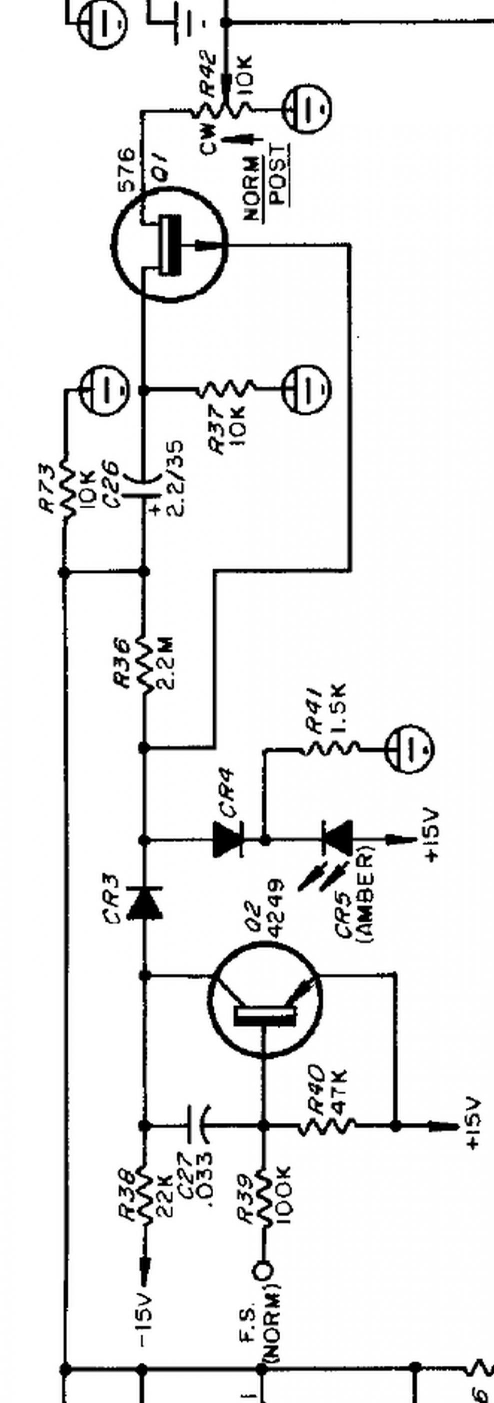

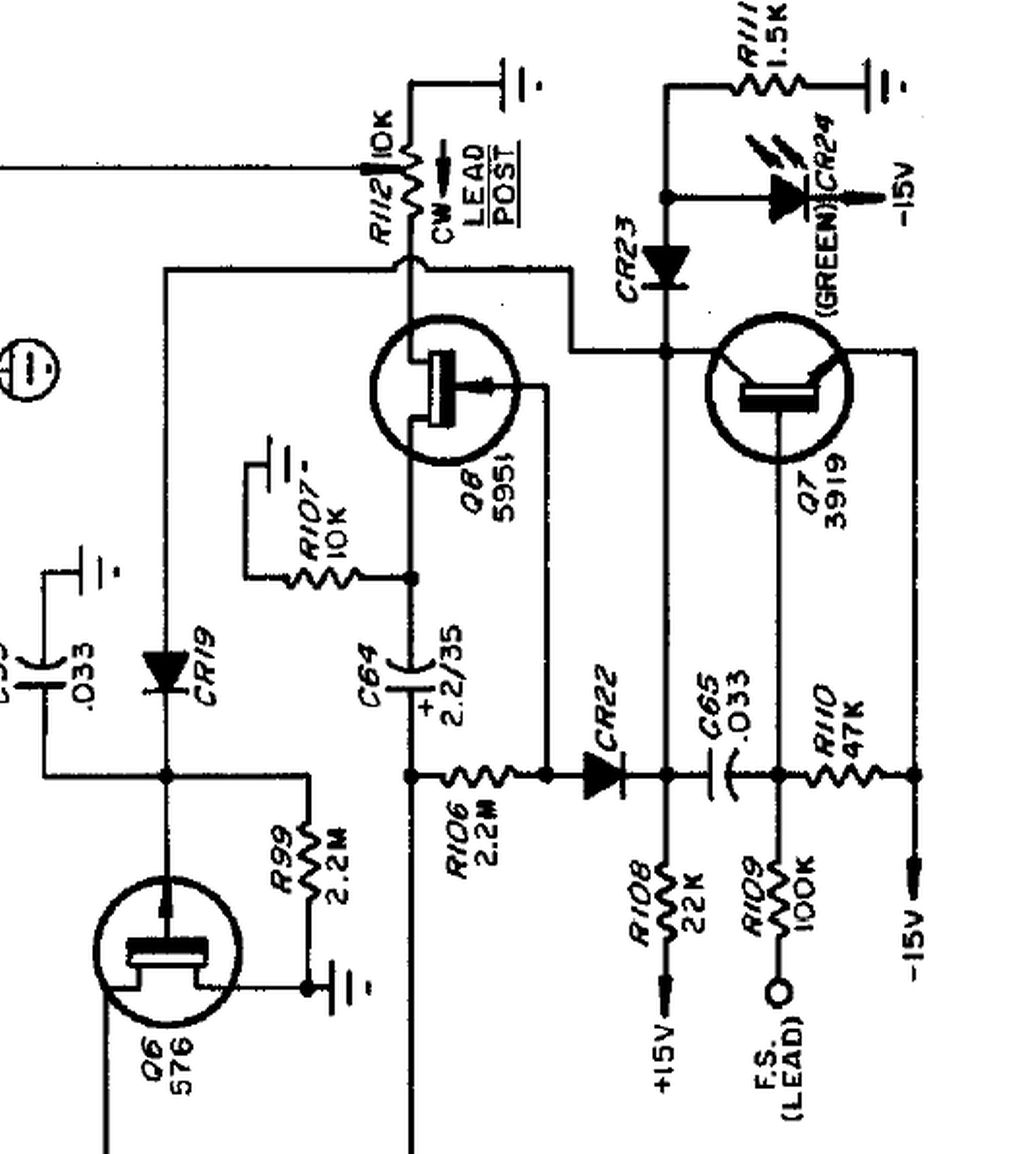

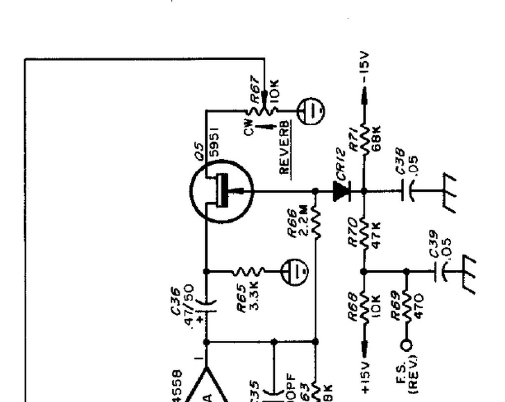

I found the bad Jfet when I had some cold spray as erratic semiconductors are sensitive to temperature changes.
A little heat from a nearby soldering iron can affect it as well.
Check the diodes in the footswitching circuits for any leaky ones as this can cause this type of noise as well.
They must show conductivity only in one direction if they show a high resistance in the reversed bias state then it is leaky and should be replaced.
The same goes for checking the Bipolar switching transistor as well.
No leaky ones!!
This would be the first things to check rather than swapping out a bunch of parts that may very well be good.

See my problem with this, is I need to break it into sections.
I can see the schematic and figure out what is the preamp, and what is the power amp section, but thats it.
Can someone circle the foot switch section?

With a volt meter you can check the voltages on the gates of the Jfet's and if you see any erratic voltages on one of them while you either have the stage switched on or switched off then you may have found where the noise source is coming from.
Check both states for each one.

Check CR6 and CR7 for leakage as they are connected to the preamp's output opamp and are reversed biased to the the +/- 15v supply.
Same with CR14 and CR15 connected to the input of opamp U6.
There are several diodes like this in the muting stages as well.
Since this is a preamp problem ignore the ones in the poweramp stage.
