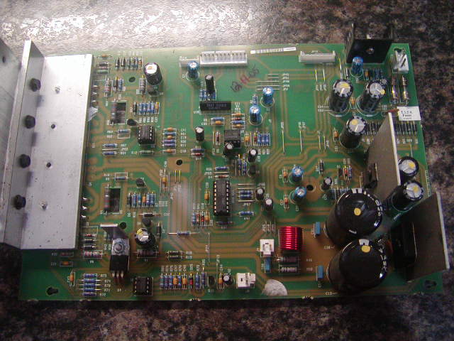

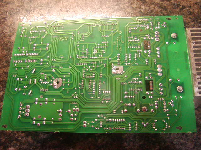

Several pictures
Bottom view
The outputs and emitter resistors have been replaced. All semiconductors tested.
Top view
J8 Fan, J4 output, P1, P2, P3 supply. J5 low voltage supply. J1 connection to the front board.
Need to know U1 and U10 function with respect to amplifier operation.

Pulled the board for pictures, put it back together, same connectors same place ( cannot connect it wrong) it works no SPS light on until it clips now.
Don't know why but it will go to someone in need now. SPS works properly, no clip light, don't know what I was thinking too many amps on my bench at the same time that I'm working on.
