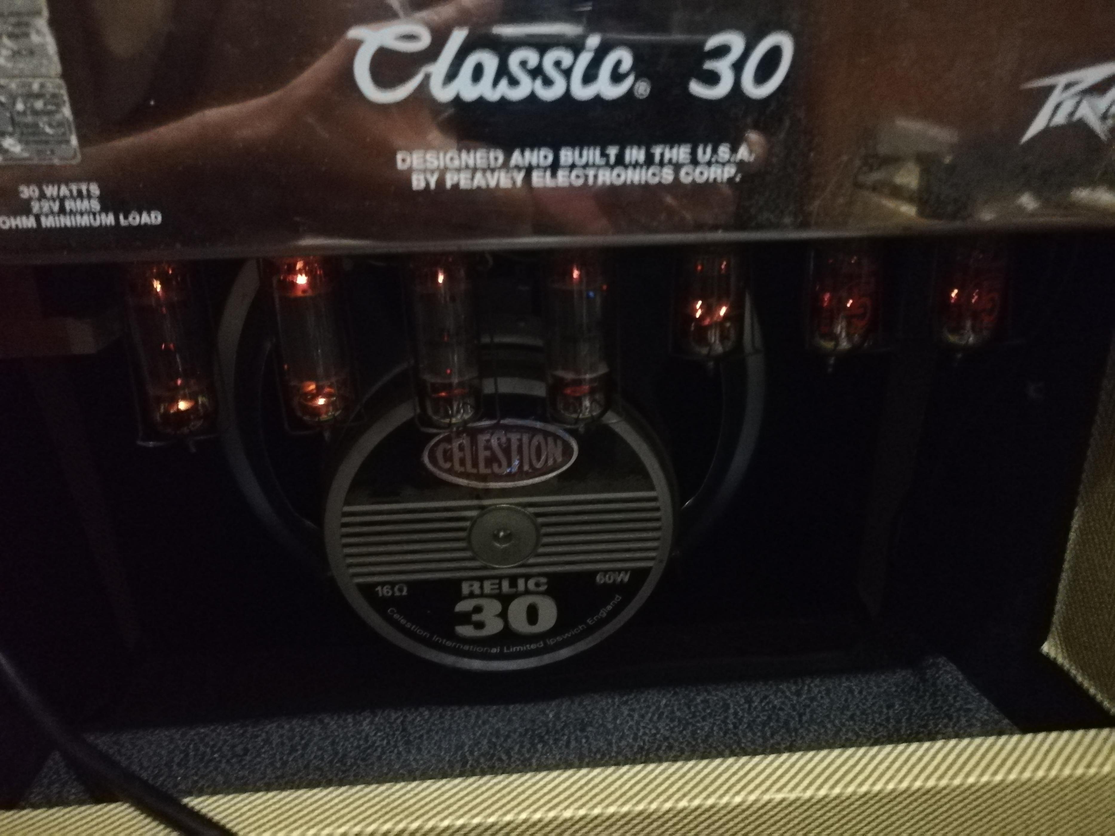

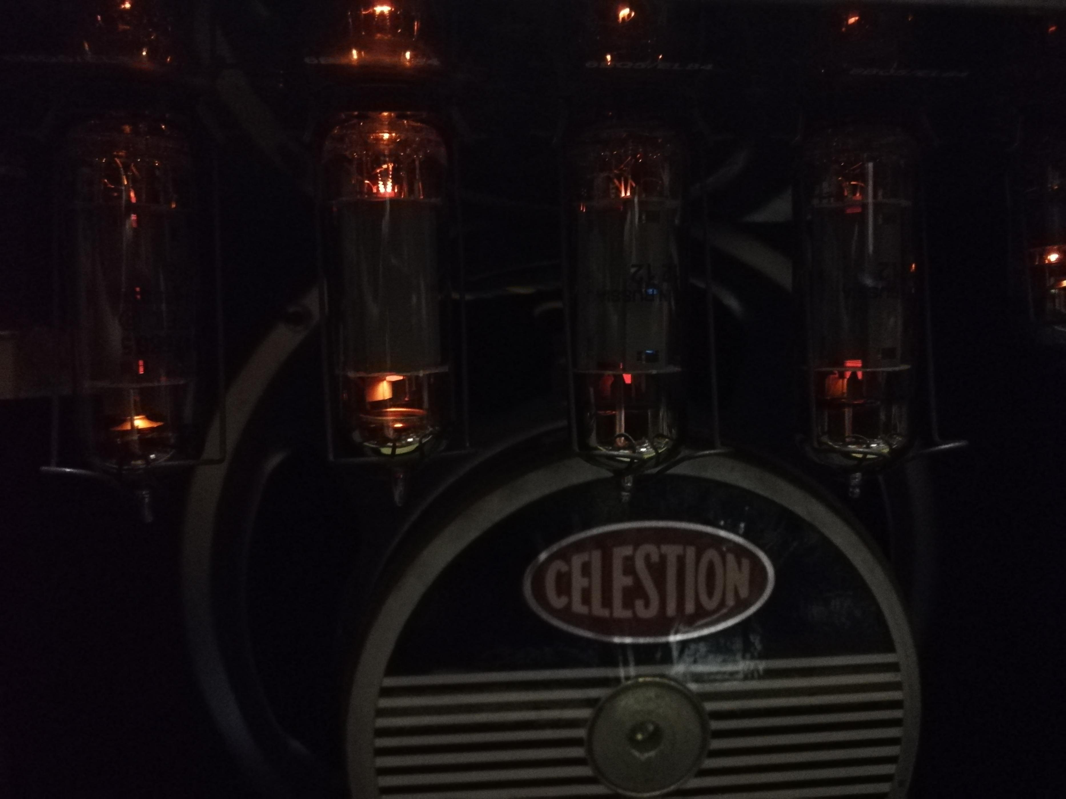

Hi thanx for answers. This amp burn current limit resistor 390r. İ change it and i see some leaking caps i change thats too. Amp working but this noise coming out.
There was 2 caps i dont change after bridge diode. 47uf 500v. but they look ok.
This noise maybe coming from caps or tubes?

You will have to scope it to find where that noise is coming from.
First speaker out, then power amp input, to at least split amplifier into 2 working blocks: Power Amp and "everything else".
Divide and conquer.

thank you for suggestions. i change filter caps too finaly i find them in my country. but nothing change still that things happen. i take out tubes and shake in my hand slowly and one of them some thing making noise insde. that mean tube in bad condition? that tube el84.
