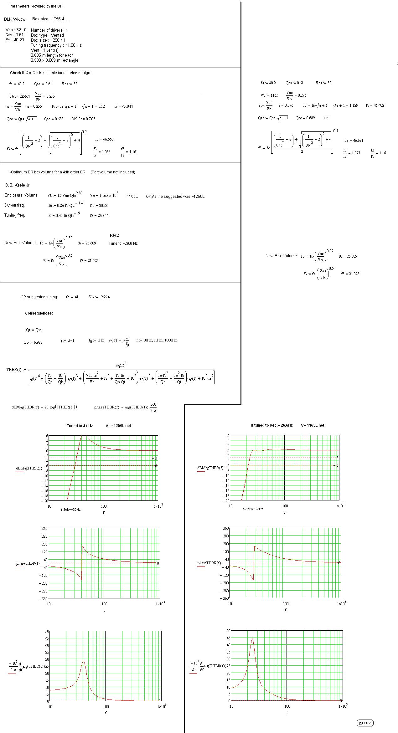

k guys this is what I have mange to draw up so far using winISD, do these number make sense to anyone, if they do will it work or sound like crap.....
Driver : peavey black widow 1801-18"
Vas : 321.0
Qts : 0.61
Fs : 40.20
SPL : 0.00
Project by : Tim & Deanna
Project for : you
Number of drivers : 1
Box type : Vented
Box size : 1256.4 l
Tuning frequency : 41.00 Hz
Vent : 1 vent(s)
0.035 m length for each
0.533 x 0.609 m rectangle
Relative

Hi, Draw your own conclusions:
b🙂
Wow ur a real hard core DIY, I tried that programs u sent me, I couldn't get it to download properly, so I tried WinISD, on this last try I had my tuning Hz at 41, I thought it was a little out to lunch with my port dimensions, so after try'n out some different Hz levels I manage to make something that seems decent, still work'n with my same box size I dropped it down to 27Hz and wow what a difference, I got 4 vents at 6" x 6" deep, and the box really came together, I think, 41Hz is good for music but being that I'm building this for my movie theater I was able to drop it down which I think will be a great improvement.
