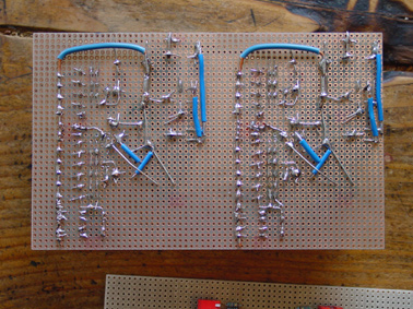

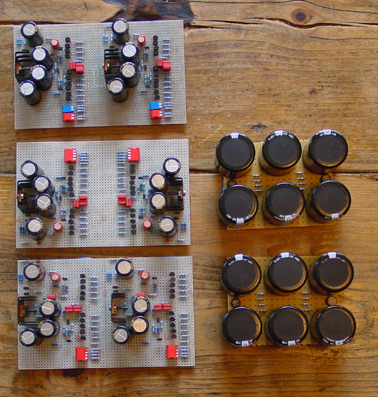

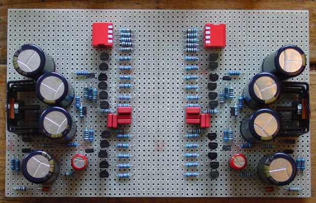

Symmetry is a good thing in hifi and in order to get the two (or more) channels identical (more or less). My thing is to make the channels as two duplicates, not mirrored (much work). It's just to press CTRL-D (but I press CMD-D since i use Macintosh) and move the duplicated piece. If I make a design with mixed parts, matched transistors, regulators, IC's it's virtually impossible to make the PCB 2 x the design. Connectors, skrewholes makes a small asymmetry if you have limitations of the board size.
In the pearls i made some changes, as you may see there are more toshibas to make the pearl fit for low output MCs and i tried to make them as small as possible, the circuits are 2x3 inches for one channel and i cant make them smaller. There was no reason using the 2sk389 as i use for jfet in the output for minimum. The output coppling capacitor is a black gate bn unpolarized cap, they sound amazing, unbelievebal for a electrolytical capacitor.
I matchet 100 jfets for the pearls.
I soldered 96 transistors 78 capacitors and maybe 200 resistors just to test my patience.
As you see, i put in some dip switches to make it possible, to find the right resistance for every MC between 30 ohm and 2K, that should work for every low output MC.
All the voltages are allmost perfekt, the matching still had some tolerance, below 5 percent in the worst case but i think that will be no problem. I didnt want to buy more of them.

Hi Oliver, some questions as i'm ordering parts for the pearl at the moment.
What did you use instead of the sk389, paralleled sk170? Did you buy the jfets from "Schuro"? Do you think that a BlackGate sounds better than a film-cap?

Joe, yes i matched and paralled sk170 from schuro, they made a good price for 100 peaces.
The black gates N sound better than all film caps i know, exept Jensen paper in oil and maybe Mundorf zncap, they sound extrem clean and smoth with deep space (after two weeks), no harshness no highfequency feepsing and no resonances.

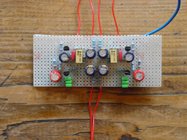

Third gain stage for pearl
Like some others i like the sound of the pearls, but think more gain would be an improvement, especially with low output MC cartridges. And like some others i tried to achieve the aim by paralleling more jfets in both gain stages. But i wasn´t really satisfied, the gain didnt get as high as i wished and the sound didnt improve in every aspect. I got more dynamic and better bass, but the sound becomes less relaxed and´liquid´. So i started thinking of a third gain stage and the many possibilities to make it.
After a while i decided that choose the easy way: a third jfet gain stage without cascading (who needs 70 db of gain?), it gets the signal from the output capacitor from stage two, its made with a matched pair or 2sk170, it has about 400 -500 ohm on the drain side, 100K on the gate, 20 ohm on both sources and an output capacitor. And thats it. I forgot one thing, the circuit can oscillate or recieve radio signals, a 10pf styroflex in the pearl input and a 20 ohm resistor ín the output solve the problems. The voltages are the same as in the first two gain stages.
Now here comes the funny thing! My three friends got the ´modification´very soon and they freeked out and told me: take this thing to the next high end store... I think, it sounds like the original circuit (like it is, now) with such a boost in Dynamic and power without the negative effects of doubling the fets in a two stage pearl. I really like to know what advantages an ono or xono could have now. The pearl is perfect for every mc now, even an 0.15 mv ortofon mc 3000, there is no need for the T3000 transformer anymore, it will be an second hand offer on ebay.
