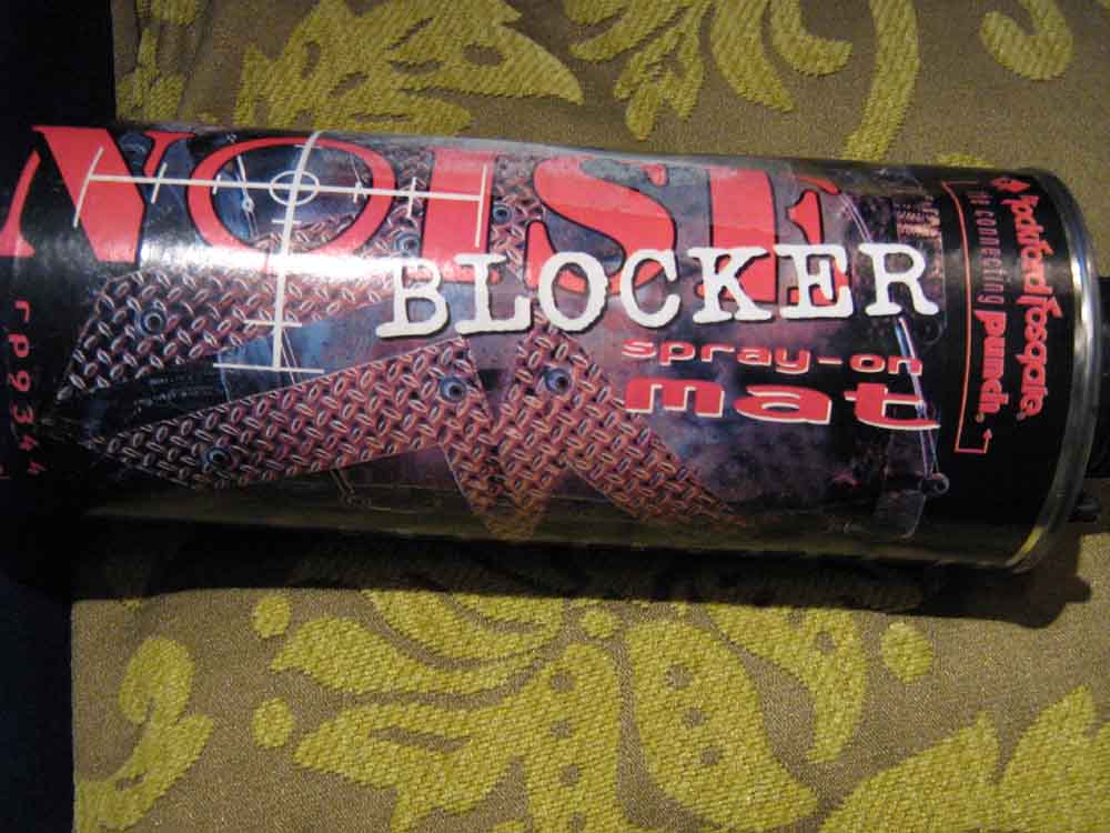

You can use bitumen paint (have some at home, I'll look up the brand and post a photo later.
The egg stuff is excellent, the call this pritex (this material is open pored, don't be foolish to use packaging material as that is closed pored).

Instead of using paint can I cover internal walls with a layer of 4mm thick bitumen and thick carpet tiles like this guy:

Bitumen sheets work wonderfull, as long as you stick it to the walls tightly...about the thick carpet, I would use different materials to experiment with. To find what you like best...
