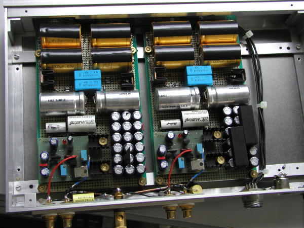

I did not built Pearl but did the Ono (just the output stage without MC part). For anybody wanting more gain from Pearl the Ono output stage might be of interest. It's easy to built and doesn't require coupling cap. The small board in left corner of mother board is my implementation of this circuit. You don't see resistors because they are on the other side. The PS transformers are separate.
