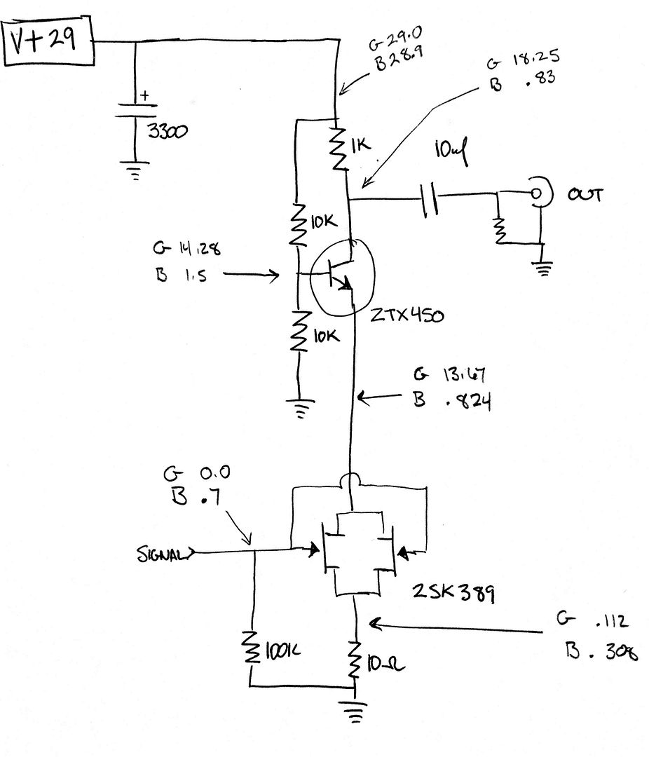

Here's the skinny - I absentmindedly had my PSU turned on while I was plugging the umbilical and had it not lined up properly and something zapped.
The PSU is fine, and one channel is fine. The bad channel measures ok except by the final gain stage.
Here are the voltages, the good channel is 'G' and the bad is 'B'
The ZTX has already been replaced with a fresh one. (I didn't test it, and am just assuming it works...)
The obvious next course of action is to replace the K389, (with a pair of matched K170's, because, lets face it, K389 are complete unobtanium these days...)
(And I''ve no idea how to unsolder a 7-pin widget cleanly...)
Does anything else seem wrong?

check that ZTX trice , same as those two 10K resistors
these two 10K-ers are just voltage divider and you must have there Ub/2 , not some wakoo point something level
desolder 389 with vacuum pump or solder wick

If the voltage has been connected wrong then I would replace semiconductors and the electrolytic.

I had time to check ZTX before running out of time (my workbench is in storage room accessed through toddler's room... it's a small house...)
hFE is good. Measures in the ballpark of other ztx I have on hand.
Resistors measure (in circuit) the same as the other channel.

Ok, I finally had time to fix it...
The K389 was no longer a live parrot --- it is no more, it ceased to be, bereft of life, it rests in peace.
The circuit wasn't drawing current, therefore the measurements higher up the chain were getting strange.
I replaced it with a matched (Idss) pair of K170, and everything measures fine now. Will listen to it next, once it's buttoned back together.
