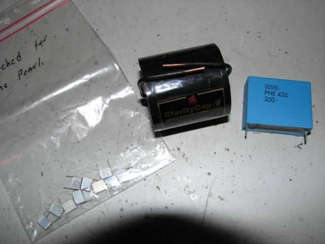

Hi Cviller. I thought it was best to continue in your own thread😉 If you could squeeze in a set of holes for the outputcap with 37,5 mm dist, it would be great. The Rifa PHE 426 10uF has that dist and I would like to try it for this. I will also try some polyprop-rolls and maybe some MKT's. The pic shows a couple of couplingcaps for the output; the Rifa and a Clarity SA cap that will be testet.
To have a baseline of how bad (?) it can sound, I matched a pair of Siemens stackfoil MKT's for the RIAA eq. I know they are supposed to sound bad, but I do want to hear it for myself😉 From then on I will try and climb the audio-ladder to see how much influence the caps has.

Looks like your components are getting ready to become a new pearl. 😉
I used some Elko bipolars - cheap but with golden letters
so they must be good. 😉
The sound is extremely good, but I don't know if some better ones could make it even better.

Wow, that was fast. We better watch out, the other guys might start calling us "The Dynamic Danish Duo"
I dont think the Bipolar eltrolytic is the best choice, but if you think it sounds good, why not?
Steen🙂

I read a test of different caps written by someone here on diyaudio and he gave some bipolars a quite good review. I don't remember who it was and I cannot find the link - maybe one of your friends can dig up the thread. 😉
I needed some stuff from a supplier who doesn't stock any MKP's so I took a chance on some of his better bipolars. The pearl is not mine anymore, so I don't think I'll test different caps, unless he thinks it would be interesting.
