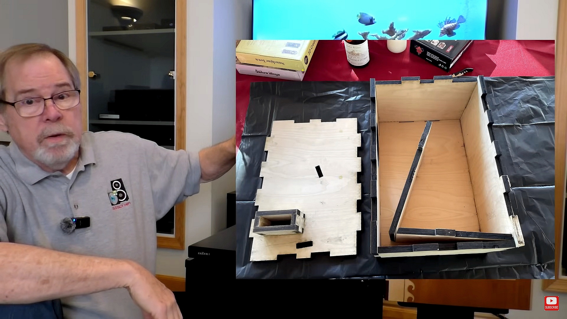

As in a folded ML-Voigt for it? Sure. I haven't done any myself deliberately to avoid any potential for treading on Harley's toes, and also because in many cases, I can't see the point of the configuration since an MLTL does the same job in a simpler enclosure and there is no visible difference.
I can to an extent vouch for that. One of Scotts design for the MAOP 11 is going wonderfully LOW as well as maintaining the silken HIGHS so signature of the MAOP group, all in an MLTL enclosure....As in a folded ML-Voigt for it? Sure. I haven't done any myself deliberately to avoid any potential for treading on Harley's toes, and also because in many cases, I can't see the point of the configuration since an MLTL does the same job in a simpler enclosure and there is no visible difference.
Not at all & very much appreciated. I can confirm Eastern Bay Sound is absolutely legitimate though, with to date all the acoustic design work done by me...😉

If you really want to get the most out of the Alpair 11MS, you need to redesign the pipe length, taper and volume. The 11MS requires a slightly larger, slower breathing enclosure.Excuse me, but is it possible to make a "Sibelius" speaker with the Alpair 11MS?

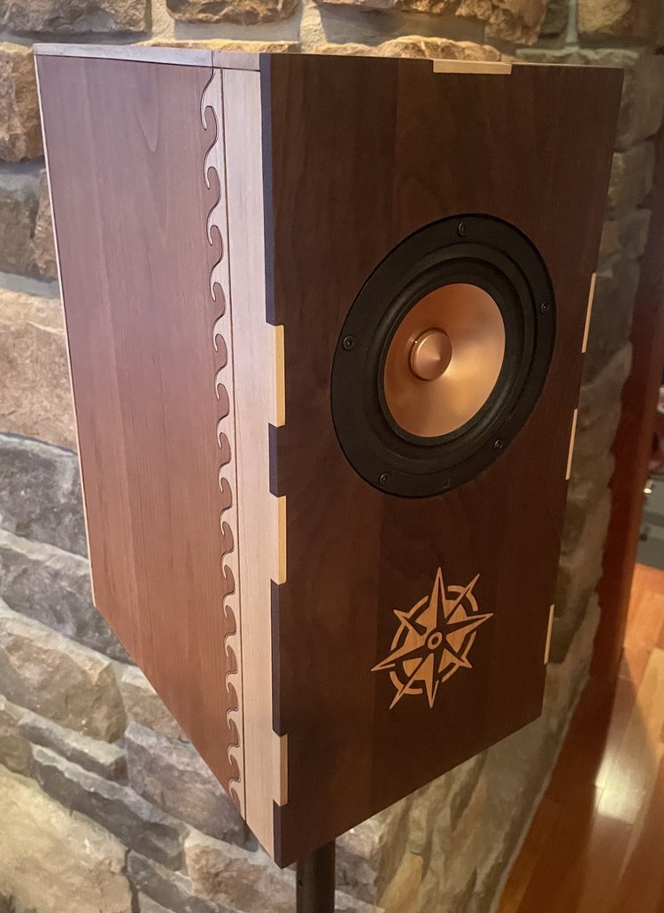

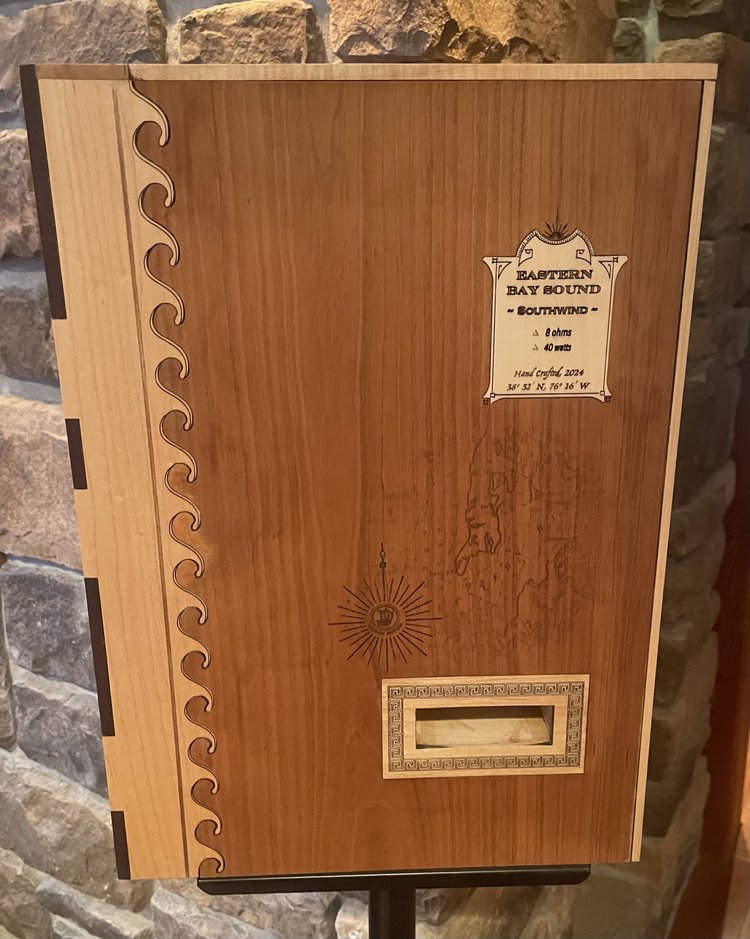

In other news, resident luminaries Scott and Dave got a shout out (aka design credit) from a new company producing a MarkAudio-based work of art, the Eastern Bay Sound's Southwind.
Great stuff.
