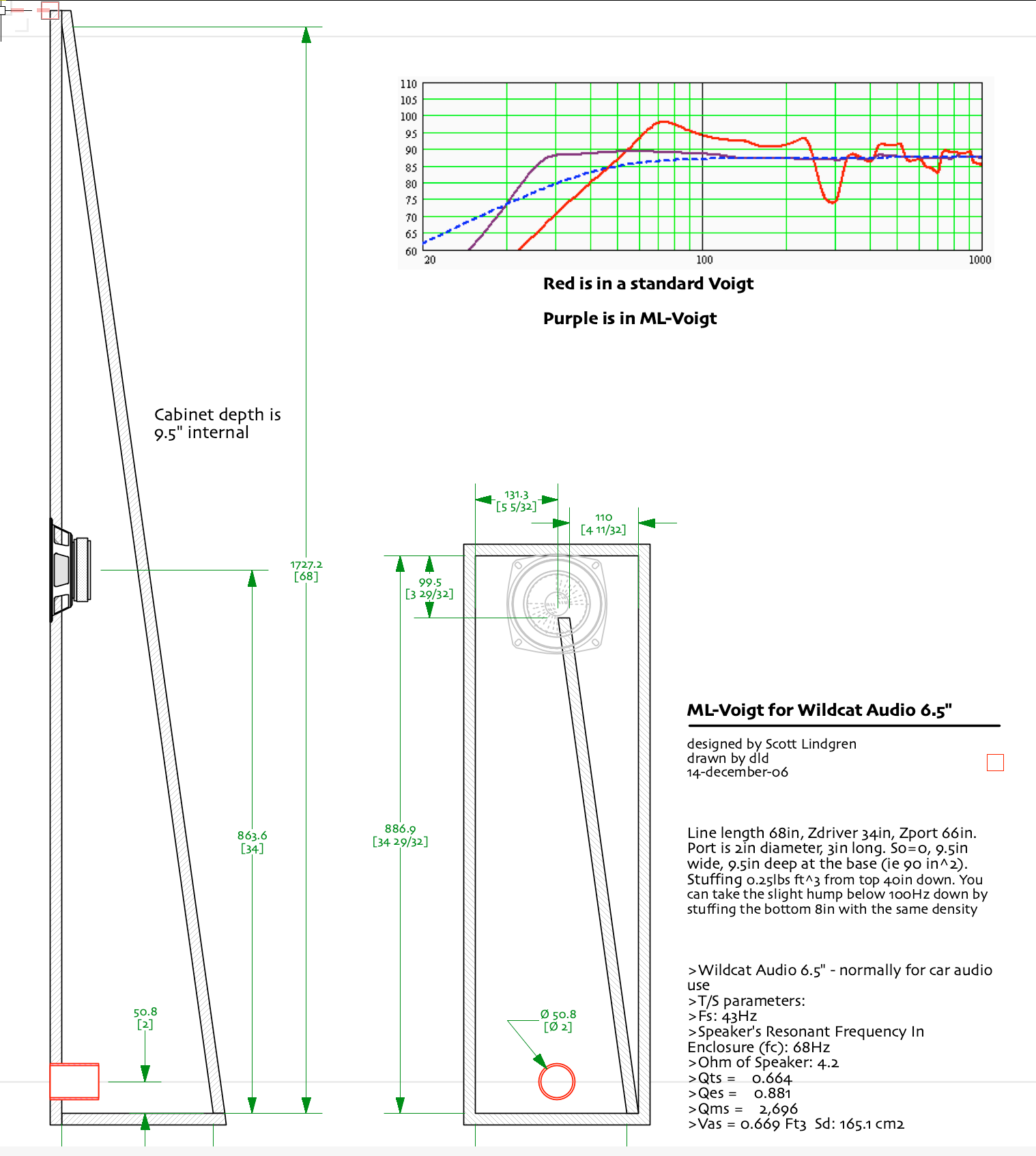

A properly designed ML-Voigt has a Zd right at 50%. Aslong as you fold the basic “festival” style straight Voigt such that the driver fires in the dirction you need it to face.
Festival style:
The usual single folding. You can put the driver on any of the 4 sides bu will need to adjuat where the point starst to get the appropriate Zd

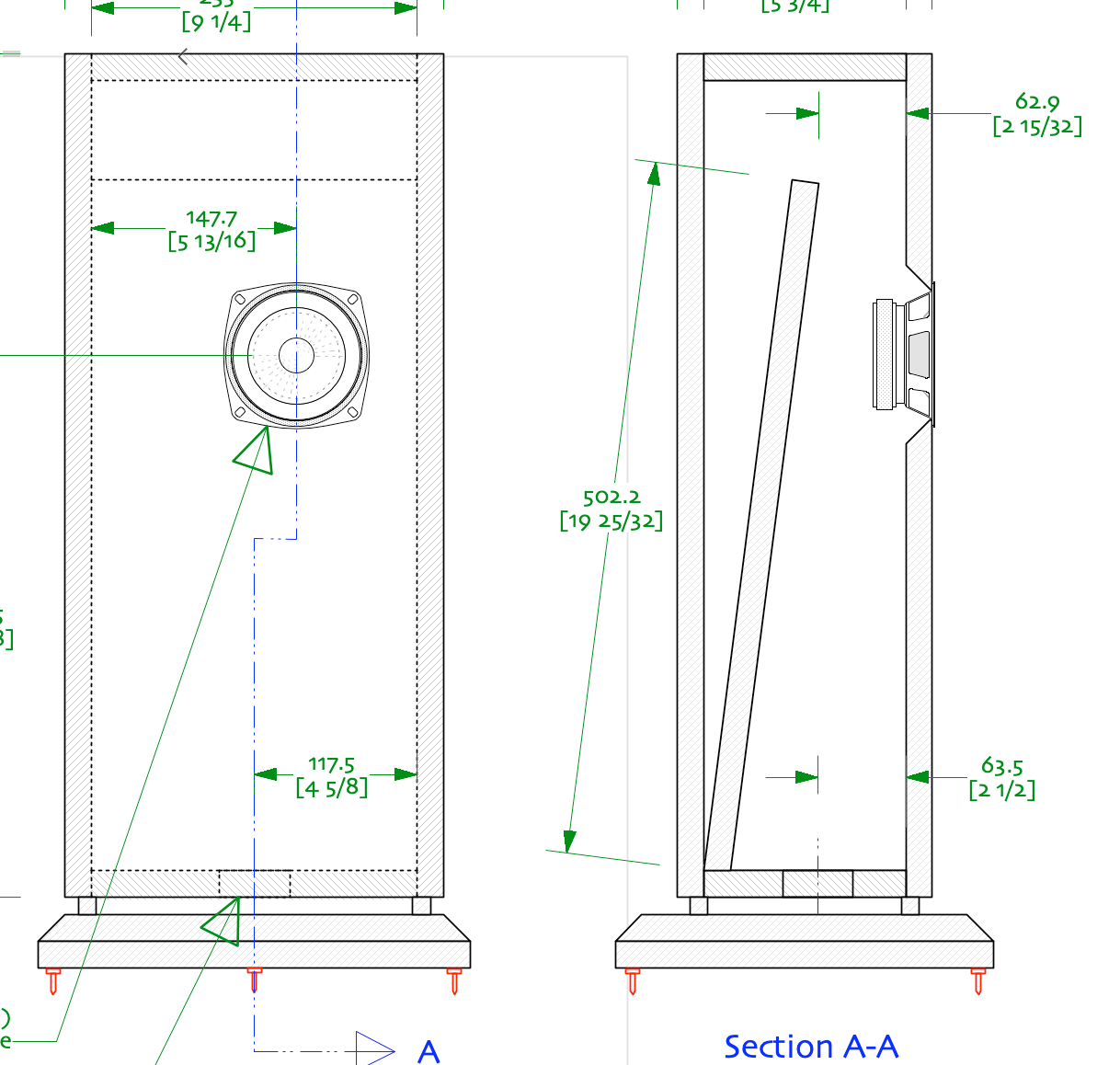

Here a clever folding that rose from opposite sides of the planet… Scott (Yorkshire) for the FF108e∑ and FF165wk, and Nadape (Japan) for more than that.

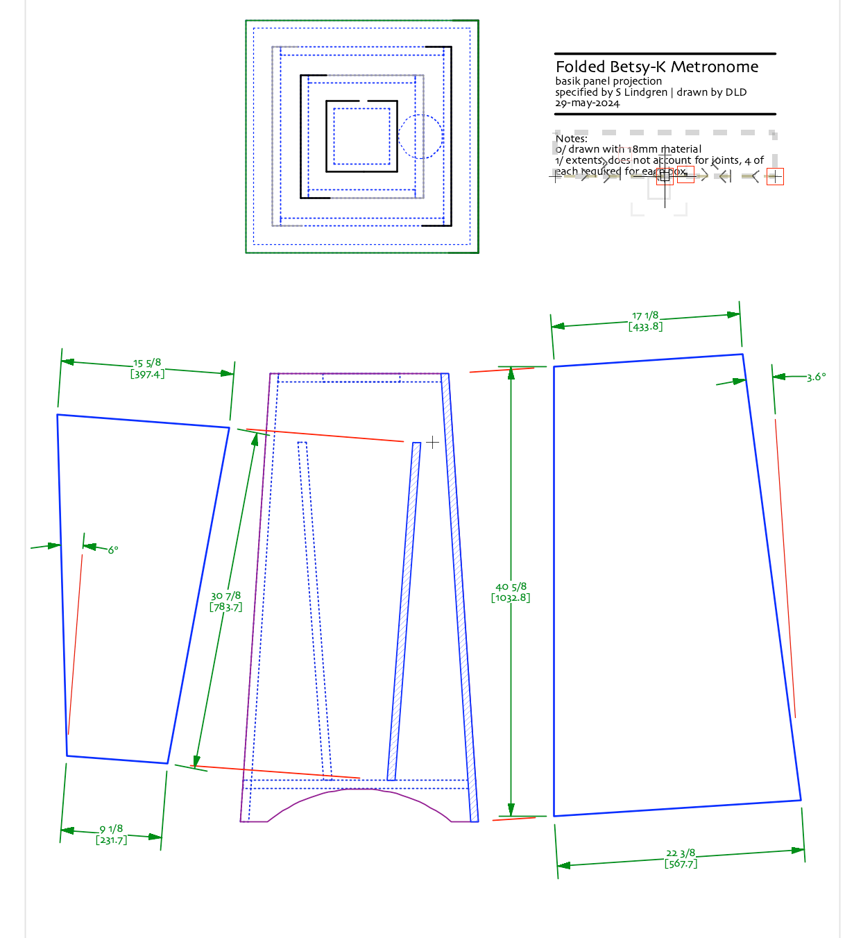

And then there is the folded Metronome, a good start for an upfiring omni

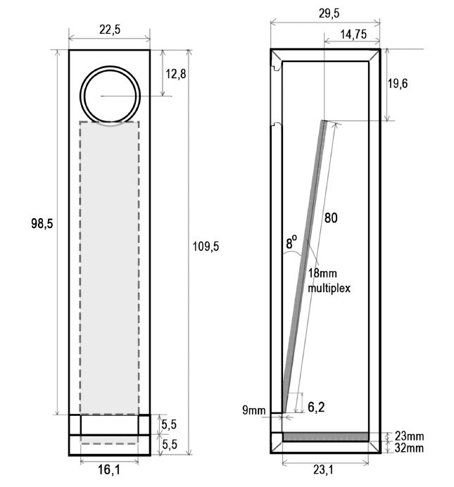

If you want to use the Markaudio Alpair 10.2 or 10.3, I would stick to the design of the Sibelis. Harley tinkered with the design for many years until the speaker reproduced an instrument faithfully. I listened to the Sibelius in Belgium and can say that singing voices, for example, have never sounded so natural. If you want a slim speaker, you can stick to the internal dimensions of the sibelius and, for example, use 18mm birch plywood. And possibly the front thicker. I think my drawing corresponds to the original within the margin of 1 cm. The only thing that cannot be copied is the driver of the Sibelius itself, which is an Alpair 10 adapted to Harley's wishes. The coil appears to have been adjusted. But this is all secret. It is striking that Markaudio has stopped production of the Alpair 10 and not the other sizes. If you look at the electrical properties of the driver, the Alpair 10.2 will come closest. This driver can make a greater impact and @Hondasnl has determined that the 10.2 produces more bass in the Sibelius housing.

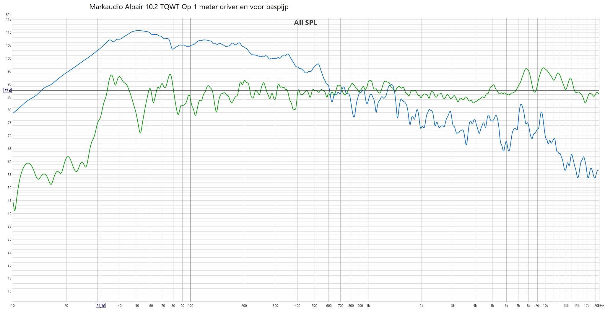

I bought compact and cheap self-built TQWT cabinets (18mm MDF) with the Alpair 10.2 and they already sound fantastic. The measurements show how good the driver is, measured at a distance of 1 meter and the measurement at the bass opening shows that too little and/or wrong damping material has been used.
