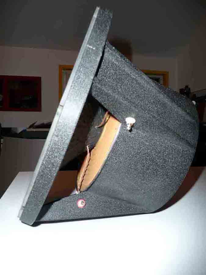

Old tread but need help on this as it's my first speaker project 🙂
Just won a pair of Coral 6CX-501's on a local auction site and am looking to use them in a OB design.
My question - How should I mount them 😕 on the face or from behind, drawing attached
Cheers
Cheers
