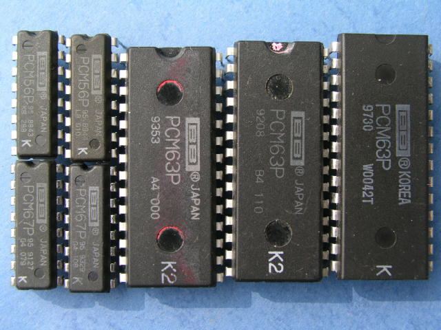

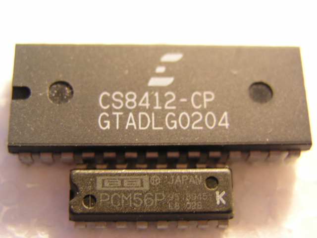

Based on the photos above and the 2 in my machine, FAKE.
the K looks stamped at the same time as the rest of the printing where it would be printed later when sorted.
I should say it more clearly.
After Burr Brown merged into TI, TI did change the mark prints of BB's IC if the ic is still in production. The famous case is OPA627. You can find out lots of different prints of OPA627 in the market.
I did saw some PCM65P-K (from authorized TI dealer) with the same prints as shown in above eBay aucton. But, those PCM65P-K were prints PHL (phillipines).
This is the first time I see such kind of prints' JAPAN (Country of Origin). That's my puzzle??
Same problem as with PCM63:
I have “PCM63P” from Japan, when the "K" is printed in white colour on the very right side of the chip.
It looks likes: "PCM63P--------------K".
I also have “PCM63P-------------J” from Japan, once again printed in white colour on the very right side.
Same kind of print is to be found on "PCM63P------------K2" (see the attached picture)
HOWEVER: There is also "PCM63K" (all in one word!) from the Phl. This is the only "K" selection I know which has no any "P" in the chip name (P for Plastic?). The selection grade is neither on the right side of the chip, nor it is in white colour.
I hope that this “PCM63K” is not fake. It sounds different (less aggressive) then the “J”... Should be OK.
On the other hand, this “PCM63K” sound very different then my other “PCM63P --------------K” from Japan.

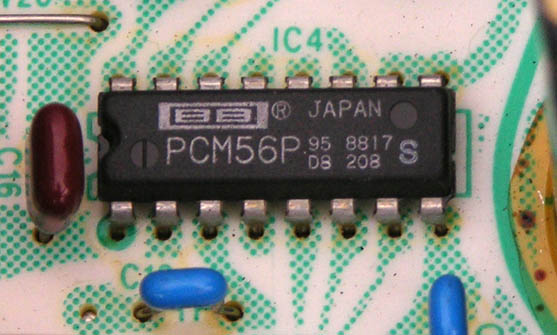

- PCM56 "S" stamp ???
