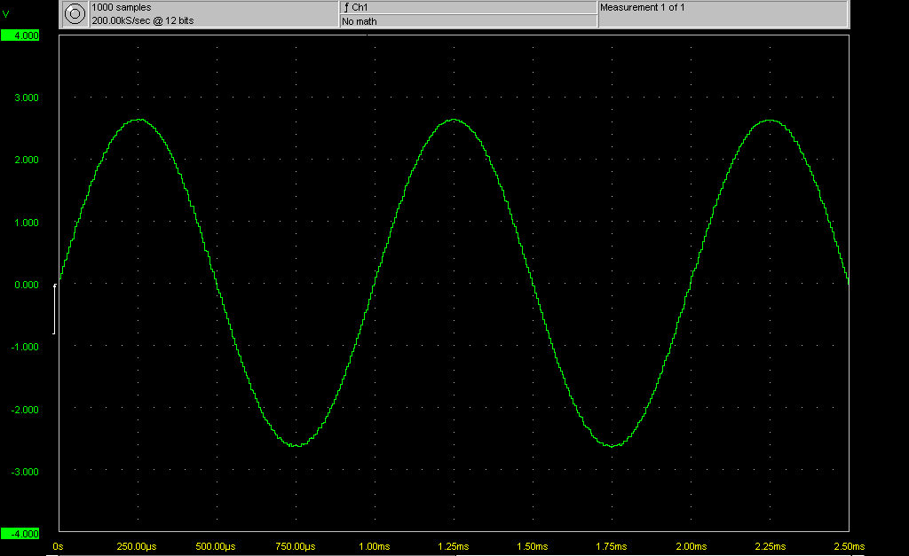

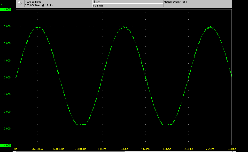

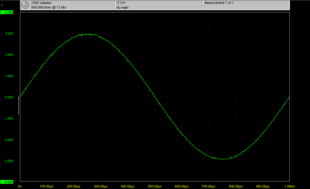

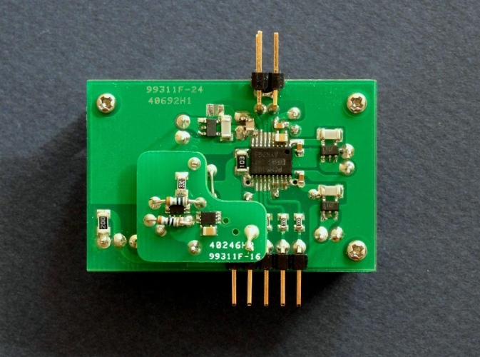

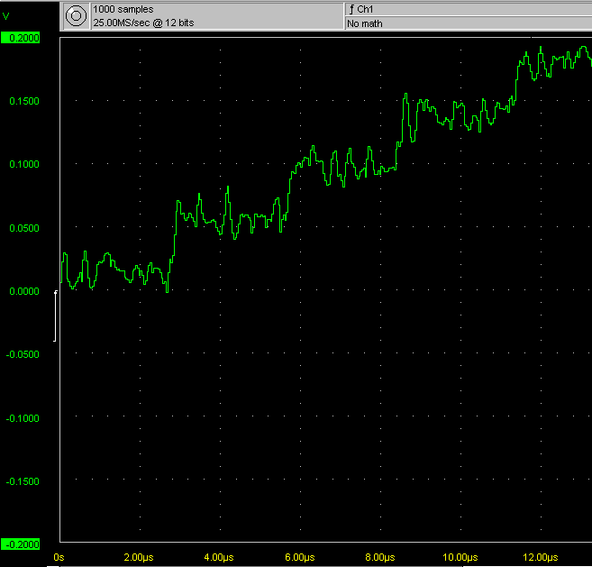

Out of curiosity, I did some measurements.
In my setup, the PCM5102 uses a 45.15MHz XO, 3.3V power supplies (3x), and has I2S input at 16 bit 44.1kHz.
The measured signal is taken directly at the IC output pin, without the datasheet 470R-2.2nF low pass filter.
Indeed there is clipping at the negative rail at full 0dB output.
The charge pump does not generate the full -3.3V, and hence the output opamps run out of voltage.
The clipping is gone for -1dB signals. And this can be solved without too much effort even for 0dB.
A similar problem exists also for the ES9022, which is why they brought out the 9023 to run on +3.6V supplies.
In real music material, this (0dB signals) hardly occurs.
Or at least in my own CD collection, I don't have anything that goes the full output amplitude.

Very quick & dirty, but problem solved. 🙂
I forgot to mention that the output was loaded with a 600R load in my setup (headphone with series resistor).
The charge pump generated -3.16V with a +3.3V supply, and is somewhat load dependent.
So loading it less (say RL 0 10k) will probably also remove the "problem".

- Digital Line Level
- PCM5102, 2VRMS ground centered direct output with two digital filters
