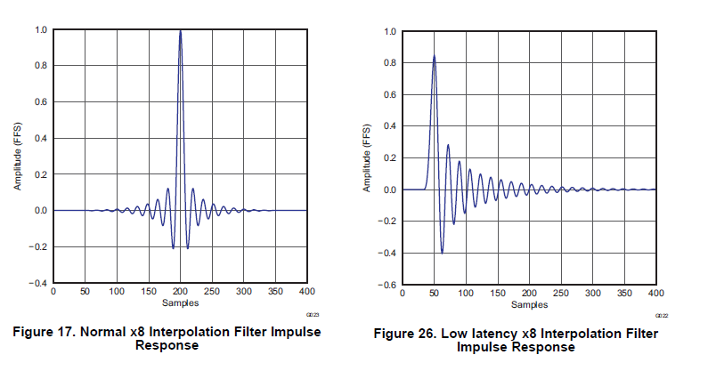

- Classical FIR Brickwall filter and Apodising IIR filter

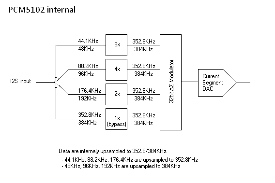

- Integrated high-performance audio PLL to generate SCK internally
This chip seems ideal for simple DAC.
PCM5102 interpolation filters
Graphical response of two interpolation filters.

From the datasheet the 150x chips can generate the master clock from the incoming data stream using a internal PLL and no external master clock input or oscillator. In doing so it supports any sample rate frequency directly with only the bit clock, L/R, and data signals. A good question is how well it does this? It would be very interesting to see how good this internal PLL and oscillator are by building one and doing some testing.
If this PLL mode works well this may be an interesting way to shave off the expense of the external oscillator and its low noise power supply (as compared to the 9022/23 at least).
If it does not work as well in PLL mode as the 9022/23, an external oscillator can be supplied to the 1502 but it must be selected to work on either 44.1KHz multiples or 48KHz multiples. It won't do both with one clock frequency.
The best performance looks to be achieved with an external low noise oscillator and working synchronously from an SD player or a fixed rate transport, etc. This is probably where the comparison between the 9022/23 and the 1502 should be made because it is the closest thing to an apples-to-apples comparison.

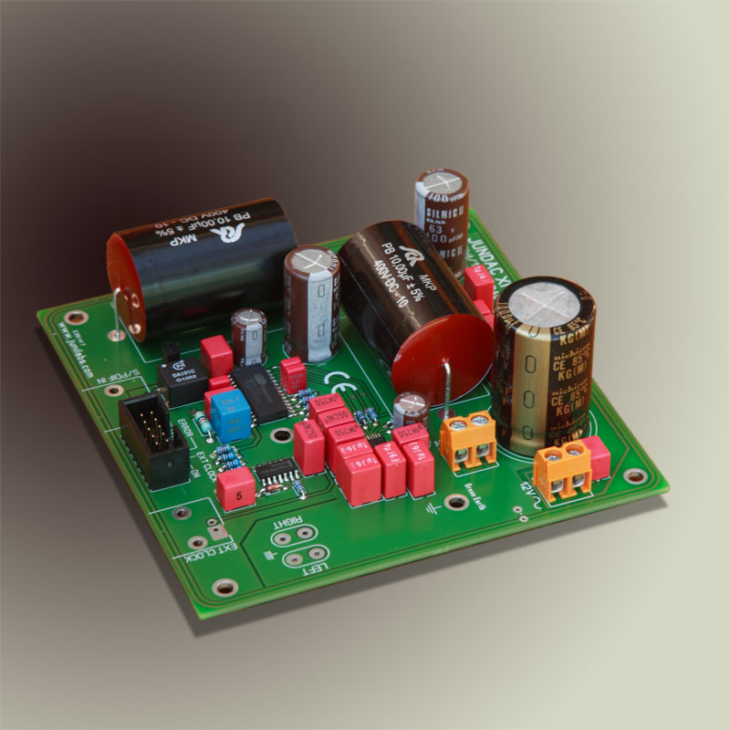

Dave,
We have done a PCB for the 5102 to tests, but have not yet found time.
It has, however, MLCC caps that you hate. 🙂
If you don't mind, you are welcome to a test board.
Though I know from experience you rather do your own.
Rest see email.
Patrick
Hi Patrick,
Ceramics still have thier place for me and I have used many over the years. I took an untraveled path with film caps and liked where it took me, that's all. I need to build one of my 9023 boards with all ceramics to listen to. It may be better...
I'll send you an email about testing a board. I look forward to doing it.
