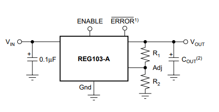

But when I look at the recommended REG103xA-A Voltage Regulator, it exists only in 3.3V or 5V fixed output, so this let me think that they use the Adjustable version (suffix A-A).
The datasheet is available here: https://www.ti.com/lit/ds/symlink/reg103.pdf
and the figure related to the adjustment is in the 1st page:
I assume that Vin is +5V (maybe 9V or 12V would be better), so what values do you recommend for R1 and R2 in order to get Vout=4V ?
Maybe a trimpot for one of these resistor would allow a more precise setup ?
Thank you

OK MarcelvdG, so I design my board with these values.
According to this figure 37 of the PCM2906 datasheet, the PCM2906 itself is powered by the "Vbus" pin (through a 2R2 resistor), and the REG103A is also powered by the Vbus pin, meaning the USB positive voltage ( +5V), so I suppose that +5V is enough to power the REG103A.
Apparently.
