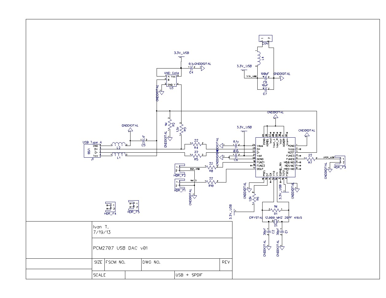

Yet another PC2707 USB module and I can't seem to get Windows to Detect it 🙁
I gives me error where It says that there is a problem with my USB device.
I checked all the connections from the chip to the components and the PSU.
What I did:
1. Checked if my and gate works to pull up D+. It does pull it up when it detects Vusb and 3.3V for the DAC. D+ stays Hi once on.
2. Swapped 3.3v sourses. Used a PC PSU for the 1st and went to a 3.3V LDO for the second.
3. Checked the clock.... I can seem to get a readout from the clock on my Oscilloscope :/. I have a 20Mhz Hitachi Tracer Beam Oscilloscope measuring this 12Mhz clock. I can't get a sine wave to show when using the 10x probe. I only see a DC voltage when the scope is DC coupled :/.
I opened up a small USB DAC based on TAS2012 or something that uses the same type of clock but it is 6Mhz and my scope was able to see a nice clean Since Waveform. the 12Mhz on my board I cant see with the scope :/
I swapped the clock with another and the same thing!!!
Wrong capacitors on the clock? Mine is 33pf.
4. Swapped the PCM2707! it was a pain but i cut all the pins and took the thing out. Lifted some pads, but luckily the ones that lifted were the Non Connected ones, except for the D+. I had to bridge D+ to the resistor with a wire.
5. Checked the Host pin and it looks like it's pulled correctly via Vbus. That is straight out of the datasheet.
After swapping the CLOCK and the CHIP out nothing changed. I get the same windows message of malfunctioning USB device.
Any ideas guys?
Anything wrong with the schematic?

Corection, I am using 30pf Ceramic NP0 Caps for the clock.
The datasheet states a 20pf capacitor for this clock.
However, I did a ton of research way back when on selecting those caps and picked 30pf. Also the AMB Gamma 1 DAC also uses the same crystal with 33pf caps?!?!

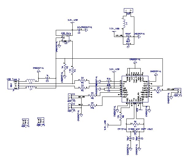

hmmm.... idk, I am going over my schematic and I can't find anything this far 🙁
HOST is good
FSEL is good
PSEL is good
or are they?

Update:
Found one mistake.... my TEST pin was unwired because my schematic had 3.3V_USB and VDD. This fixed the oscillator and I can see a sine wave now!!!
But it still can't recognize the the Device. It selects it as an Unknown device.

I am back from vacation and was able to take a look at the USB module
... guess what guys (if anyone is reading)... I flipped the D+ and D- wires on the USB cable..... great!!!
From what I've read that mean that the chip is fried... good thing I had samples. Need to order the supplemental parts, repopulate the 2nd PCB and will try this again :/ lol
So 1 mistake on the schematic and 1 brain fart.
Finally got around to it again last night and...... detected by Windows 7!!!! 🙂
It took about 5 min to go trough the schematic and to discover that I have also left off the Vccp floating. I believe I got confused that Vccp was only powering the analogue part of the PCM2707 which I didn't need and I left it open. Of course Vccp powers the oscillator and one more periferal.
