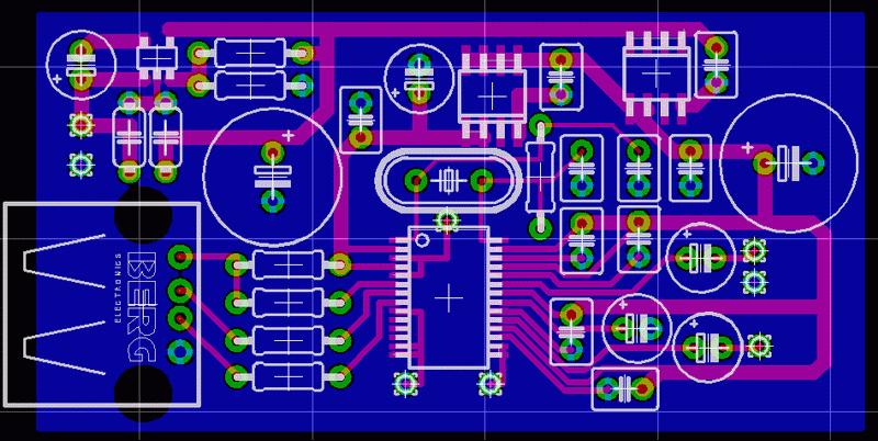

Here's a single sided pcb, analog and digital grounds connected. Power supply traces are 40mil, signal is 16 mil. Clearance is 8mil. Grid is 1 inch. I hadn't a correct layout for the inductor, so I used a cap layout. The computer ground is not directly connected to the groundplane but to the chip only.
Gyula--I would have to say that with this single sided board the capacitive coupling from a trace to the ground plane is next to nil. Capacitance between two plates (trace and ground plane for example) is proportional to the area of the plates in parallel, and traces side by side with a ground plane on the same layer are coupled only by the thickness of the 1 ounce copper, NOT the width of the traces.
We do this all the time on low noise photoamps here at work. it works fine, no ground loops. And it's not really a problem with 2 or 4 sided boards either. Calculate the capacitance with 0.062 FR-4 separating two plates, for example (2 sided standard board). It's pretty small. I have in production 4 layer boards (0.015 inch insulating layers between 1 ounce copper traces, 2 signal layers with a ground plane and power plane) with 10 megohm feedback resistors in current-to-voltage converters where 1 picofarad is a big deal. These boards work fine, and the typical parasitic capacitance is on the order of 1/4 picofarad. Not enough to create much of a ground loop....

Here is my PCB. According to Gyula, it is fool of ground loops too. 🙂

Here we are, what do you think about it ?

A few comments on the parts.
Chips on board : max1722, dc-dc booster from Maxim, REG102 (5V and 3.3V), low dropout regulator from TI, PCM2702, USB DAC from TI.
Capacitors : C1, C2 are 10uF tantalum. C3, C9 are Pana FC, 1000uF/6.3V. C6, C12 are Pana FC 100uF/6.3V. C15, C16 are ceramic, 32pF. All the other caps are wima mks-02 100nF. 220nF would fit.
Grid is 1cm. The board is about 3cm/6cm (1.2"/2.4").
2702 layout
Hi again
Took a look at your setup and compared it to the TI eval kit. Interesting, they don't even regulate the voltage input and get their 3.3V with 2 diode drops! pretty crude.....
One thing I noticed on your schematic--you have no pull downs on the audio out. The risk here is that you will get a POP when you plug in the DAC to your preamp and it discharges the output caps. It does not take much load to fix this--I used 330K to ground on each output on my prototype.
I like your power supply scheme. I have several products where I have done just what you propose--a small switcher followed by a linear for good noise performance. Should work fine. Thorsten Loesch has suggested that the TI TL431 is one of the better sounding regulators, might be an alternative to try although I do not know how much difference it will make overall.
On the layout, I would strongly suggest using surface mount components everywhere you can. Especially for all decoupling caps--0805 ceramic caps perform very well and can be put right next to the IC for the best possible decoupling of high frequency noise. Makes the board smaller too!
Nice work!
cheers
Adam
Re: 2702 layout
Indeed, their version is quite stripped down.
True. Well, I could mount the resistors right on the RCA jacks.
Thanks for the comments 🙂

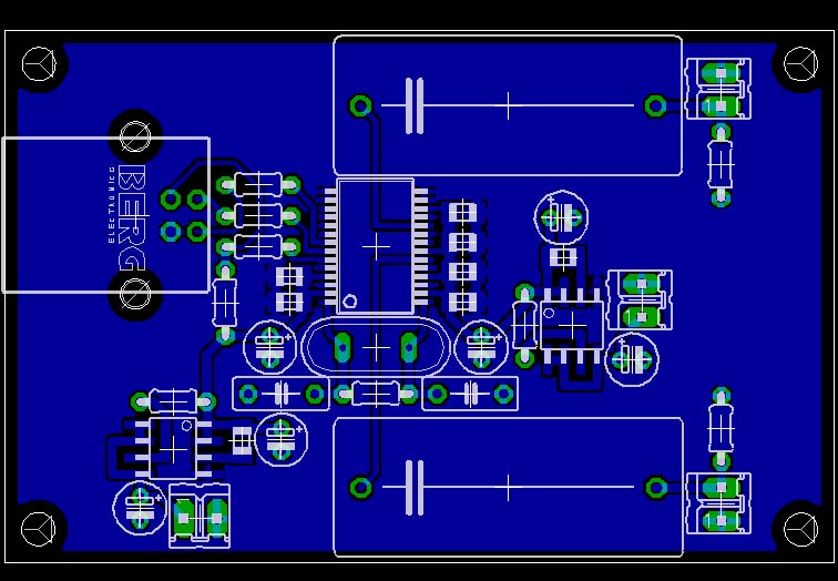

I've sort of taken over development of this board from 00940. Here's a 3D render of the the board I'm going to send off as a beta sometime next week:
I've included pull down resistors (the 0805s near the output), replaced the resistor for the oscillator with an 0805. Also, there's a pad to bypass the switcher or the 5V regulator. All the red caps are WIMA MKS-02 100nF for size reference. The output caps can be Black Gates
If all is well with this board, I'll put a smallish order in for other people
