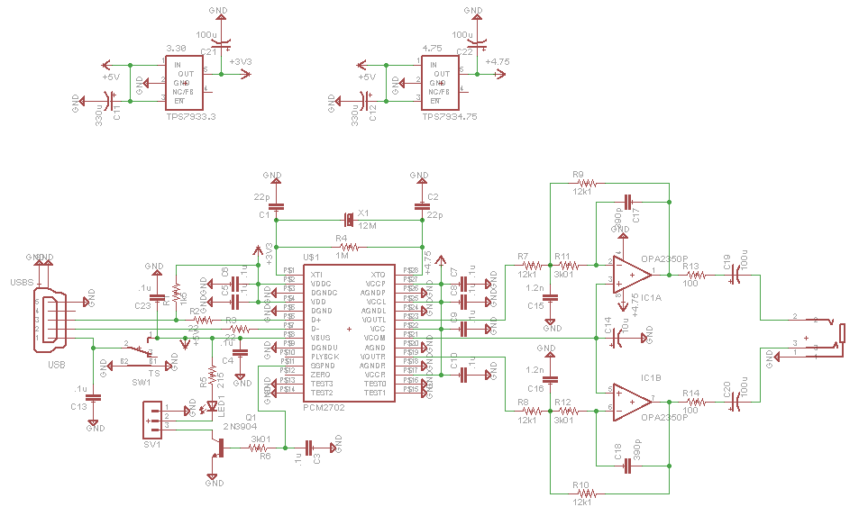

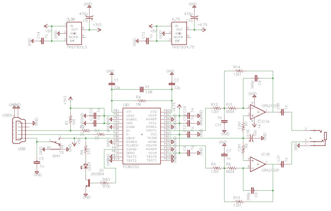

I was looking at the documentation for the TI evaluation board. It appears that they use a single supply setup and remove the DC after the filter... I have another question however. It appears to me that they use the SSPND ouput to light an LED. It looks like the LED is on when SSPND is low, indicating a fault. How can I use it for a power LED? Use an NPN?
Can someone look over this design and let me know if it looks ok. I'm using an OPA2132PA op-amp to match the one in the amp I'm using. I added an equivalent resistor to the NI input of the filter. I'm using an NPN transistor to drive a power LED. I also wanted to use a PP 1u cap on the output instead of a 10u electrolytic. The volume pot on my amp is 10k, which makes a high pass corner freq. of ~=16Hz I think...

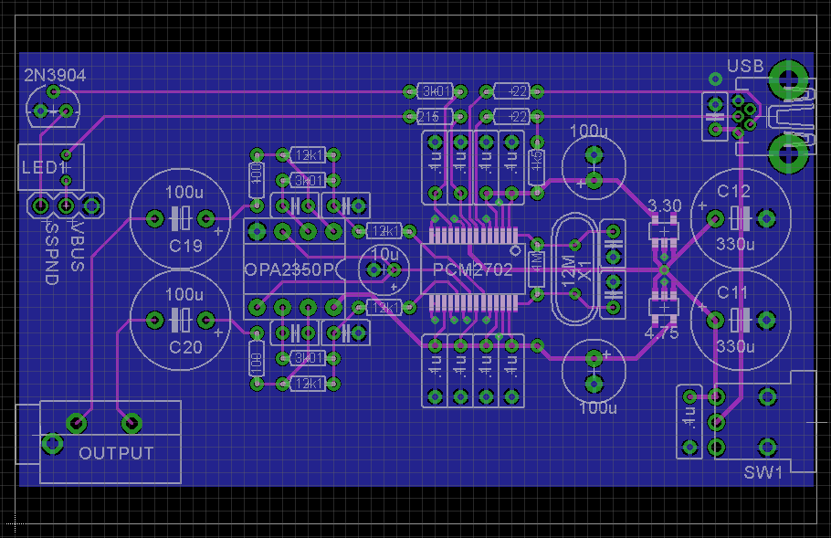

Well here's the final product...
I've included the final Schematic and Board layout also. If anyone is interested.
I had a lot of fun with this project, first time with SMD and also first time doing re-flow.

The pop is caused by the output capacitors charging (which causes current to flow at the amp input, creating a temporary voltage).
Larger caps have worse pop because of the increased current to charge them (I think), but smaller caps have the low end roll-off, so it's a trade-off. You could add a buffer between the output caps and the input of the amp. That would allow really small output capacitors and would remove the volume pot from the low end roll-off equation.
Very nice layout!
