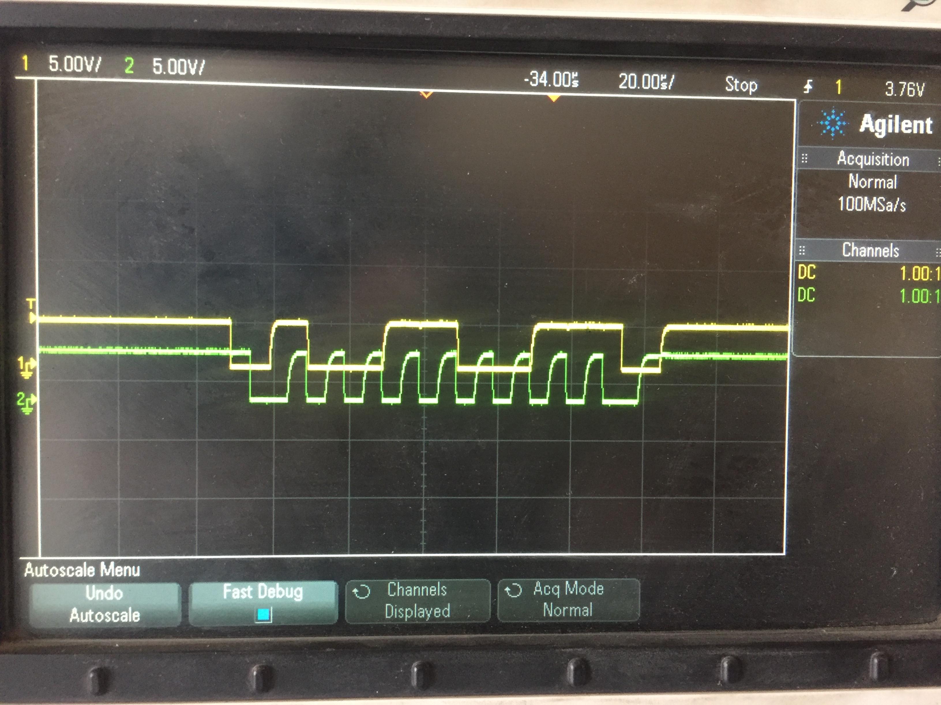

Hi, I couldn't get that shipment on time so i had an angilent DSO in college and i probed the lines and this is what i got. It's sending out the correct 7 bit address and then attaching the correct read bit making it an 8 bit address. But i'm always receiving a NACK. I'm attaching the oscilloscope captured photo. I checked the SCL frequency. It's constant at 99KHz.
That's not how to do it. You have to send out the 7-bit address on bits 7-1, and then add a 0 for bit-0. Exact same thing as for 8-bit addressing. The you send data next without releasing the bus. As the second part of the first message you send the second 8-bits containing the address of the register you want to read. That whole 16bit thing is actually one message, 8-bits of address and the r/w bit set to 0 for a write. The next 8 bits contains the hex or binary (same thing) register number.
Then also without dropping the bus you have to do a re-start to the 7-bit address with a 1 in bit-0 (the 8-bit read address part of the next 16-bit transaction). That means you are sending a read command to that address, Then the slave (dac chip) should send the selected register contents back in the next 8-bits according to the SCL clock still being generated by the master (arduino), which completes the second 8-bits of the full 16bit read transaction.
You won't get the first ack back until you have written to the write address and sent the register number (data to be written), that's one complete message consisting of 16-bits, the first 8 bits are the address including the r/w bit, and the second 8 bits is the register address that you wrote. After one good 16bit message is received by the dac is when you should get an ack
Okay. So I have to start the bus, Send the slave address(7bit add + 1R/W bit), then without dropping the bus, send the register address which makes it a total 16 bit long.
After which i can get an ACK.
Now That i have set the register index, I can start sending the slave address with a ' 1 ' on bit 0 indicating that I have to read the data, so the first 8 bits of the 16 bit transaction contains the address with read register and the slave will send the data in the next 8 bits of the 16 bit transaction.
