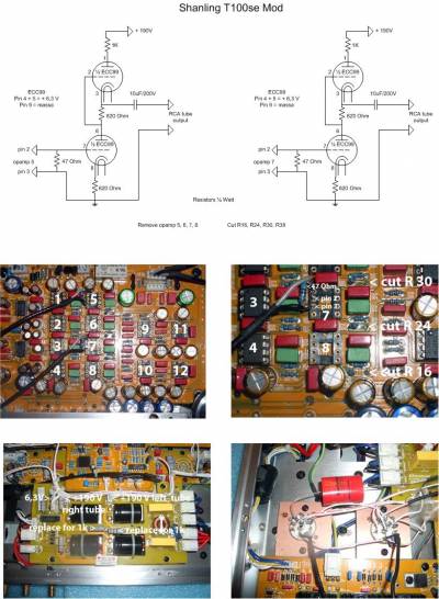

my pcm1794 has 47ohm I/V. That should give a lot of distorsion, but no distorsion at all. Just super sound.

Actually, 47r for a passive I/V is ok. You're not loading an opamp and your resistor is small enough to not develop too much voltage at the dac pins. If you were using a larger resistor, the protection diodes inside the pcm1794 might start conducting, creating large distortion.
