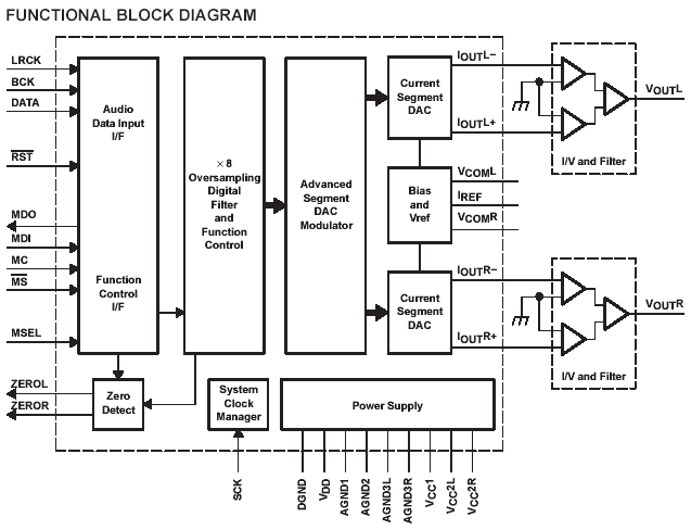

I picked up some pcm1792, and I am going to make a dac with them for my cd pro 2, possibly along with the ad1896 (i will swap for the src4192/3 once they are available).
Has anyone tried to use the volume control feature of this dac? The datasheet says 0 to -120db with 0.5db/step, which seems perfectly fine for my use, and it doesn't seem too hard to control, using a pic.

My concern in using a the newer dac for a pot is the linearity of the silicon. Maybe, a R2/R ladder dac, one that has no opamp internal to it that might be the best choice. You might look at some of Analog Devices older parts.

The PCM1792 doesn't have internal opamps, and just outputs current from the dacs, and I plan on making the I/V stage with opa627 opamps.
I don't know of any other dacs with volume controls, besides the ad1955.
What is the best way to put a solid signal into the dac, so that I can do a response graph of the linearity of the volume control? Is there any easy way to input a solid level response into the dac?

Burr Brown makes several parts, both parts have thin film laser trimmed resistors. So, no silicon resistor to cause distortions. The two parts are a DAC7545 with has both analog and digital grounds and the DAC7541A which has only one ground pin. Both parts are 12 bits and have a +10/-10 maximum input at the reference pin.
I don't know if these parts or still in production but they would work well, however the are linear taper
