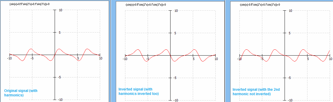

Well, the ones that make those harmonics... Fhe fundamental signal. I don't see why the harmonics won't be reversed too, if the base signal is reversed. Especially why some (odd order) of the harmonics would be in phase and the other (even order) would be out of phase.
They will be all in reverse phase with respect with each other, because they follow the fundamental signal.
Remember, this is not statistic noise!
Noise is un-correlated, we are talking about correlated components. You have keep in mind what even order distortion looks like in the time-domain. It manifests as an asymmetry of the signal waveform. Inverting the waveform therefore also inverts this asymmetry, re-establishing waveform symmetry upon analog algebraic summation. Again, this is a well established open-loop distortion canceling principle, one which has been utilized in push-pull and complementary symmetry amplifier topologies for decades.
You are wrong, inversion is a symetrical, linear operation. Distortion will invert also when the input signal is inverted. The second-order harmonics in DAC#2 don't "know" that the signal passing thru DAC #2 is inverted in respect to the signal that passes trough DAC#1.Inverting the waveform therefore also inverts this asymmetry, re-establishing waveform symmetry upon analog algebraic summation.
Inverting a distorted wave will not CHANGE the shape of that wave. Like I said, inverting a square wave will not sudennly make it a triangular one - that would happen if the second harmonic will change differently from the fundamental or the third one.
Acually, look at pictures below. First is a "normal" signal with 2nd a 3rd distortion. Second is the same signal inverted completelly (as it happens in reality). Note that the shapes are in mirror, as they should.
The third is what you say it happens - the second harminic is not chaging the phase as the rest of the signal. Note that the resulting signal is not at all "mirrored", it changes shape. It is NOT an inverted signal for the original one.
The distortion doesn't invert (whatever you mean by that), the waveform inverts. Therefore, waveform asymmetry is also inverted. Upon algebraic summation of the two anti-phase waveforms the original waveform asymmetry cancels. This has long been a well known and exploited engineering fact about push-pull and complementary symmetry circuits. I'm repeating myself, which means that there's no point in further discussion. I suggest that you do a simple web search to see all the many papers confirming what I've told you. References to it are everywhere in the engineering literature.

Ken you still don't understand what we are saying, what you propose will work if you want a 0VAC output dac🙂
The harmonics we are talking about are the signal prior to the analog stage.
We aren't operating the DAC chips in push/pull or complementary 🙄

Isn't the context of the discussion precisely a pair of DAC outputs operated differentially in push-pull anti-phase? Perhaps, we're are talking past each other and will continue to do so, but I'll take one last stab.
Imagine a pair of single-ended amplifier stages (instead of two DACs) operated as a balanced bridge. Each SE stage on it's own produces significant amounts of 2H, but when operated differentially the 2H greatly cancels. The now push-pull circuit doesn't produce 0 volts, but rather a differential voltage swing twice what either SE stage does alone - all while cancelling the 2H. It doesn't matter that the 2H existed right at the inception of the signal chain, prior to the two anti-phase signal being summed in to an single in phase signal, the 2H will still cancel, wouldn't you agree?

The main isssue is that the DAC is single ended inside the chip. Distortion products that are produced INSIDE, cannot be canceled OUTSIDE. Inversion at that point inverts the whole signal.
Ken, just look at the graphs above and the formulas that generate them. You will see that only a fully inverted signal (fundamental and ALL harmonics) will be mirrored image of the original.
The push-pull canceles the distortions produced INSIDE that stage, compared to a SE stage with class AB polarization. A SE class A will have less distortions (of any order) than any push-pull.
You just read somewhere that "2nd order harmonics are canceling" and, because you wish to be true, you assume that's true (for all situations).
