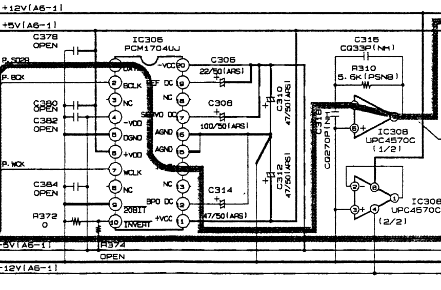

There are two pins on the PCM1704 that hobbiest no nothing about: Vref and DC servo.
Voltage compliance defined as V (at the i-out pin) minus ground, the higher the number the wrose the linearity.
There are two forms of voltage compliace:
1 Static- this is the i-out dumping into a dc voltage above or below the chips analog ground (input impedance of the I/V can be Zero ohms but at a DC level that harms linearity)
2 Dynamic - This is the impedance >0. You measure AC voltage between I-out and aground playing a simple 100hz 0dbs sample and you calculate the impedance.
Of course an I/v stage can have both voltage compliance issues leading to non-linearities.
But obviously those two undiscussed pins must play a role in aliviating difficulty in building an I/V for this troublesome chip.
Vref can probably help null the static voltage compliance?
And possibly the DCservo pin can monitor ac on i-out and compensate a bit ?

The voltage compliance you mentioned, static and dynamic, can be tackled successfully; I have solution for both. Static -> fast OP's with very low input bias currents and offset voltage (AD8065) can produce very good results. However, dynamic impedance with such OP's can not be low enough at higher frequencies -> hence the high frequency perceived performance with VFB OP’s as 1704 I/V suffers.
Much better solution is CFB OP's like very a fast AD811. The compliance voltage swing I have achieved is 2.5 mV max -> with 1 kHz square wave at 0dB (!!) - extremely harsh / demanding. The frequency response is flat from 16Hz to 22 kHz within 0.1 dB. AD811 has higher input offset voltage and input bias current, but that’s nothing (negligible) compared to ability to present itself to 1704 as flat, very low dynamic impedance load. It is like perfect resistor with constant resistance, with added capabilities of providing the gain that can be optimised by selecting Rf and Rg to suit preceding filters / oversamplers. For the first time I was able to listen to natural, uncoloured digital reproduction with no fatigue of any kind. The estimated dynamic impedance is around 1 ohm and is flat across the required frequency range. The topology is dual differential 1704 implementation in very low noise environment, with noise levels at all Vcc / Vee pins equal to ground plane noise levels. I did not have AD811 oscillations’ issue of any kind…
1704 presents the most natural digital conversion I have heard so far, so it pays to invest in appropriate I/V stage to get max out of this chip.
AD811 need heatsinks to stay cool and keep drifts constant, minimising influence on “static” compliance values.

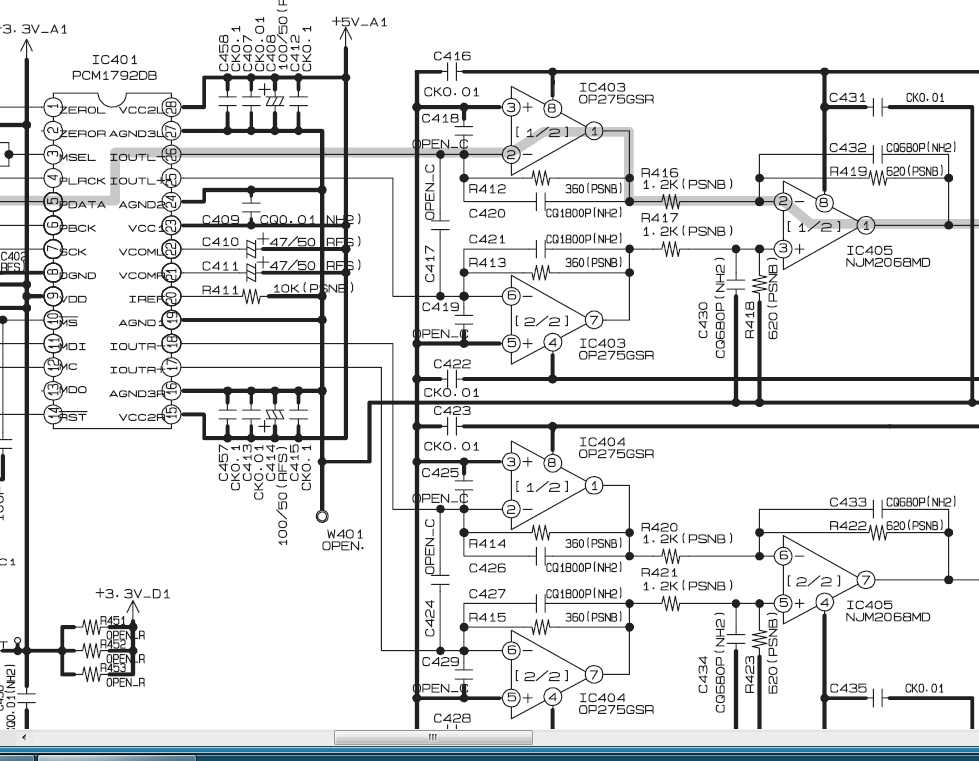

I am very fond of the sound of PCM1791/2. I do own a TDA1541 (modded) and two PCM1791/1792. The 1791/2 is just better (Denon DVD-2930, DVD-3910) - with proper filtering at output. When I see people eliminating the analog filters and claiming that it "improved the sound", I just cringe.

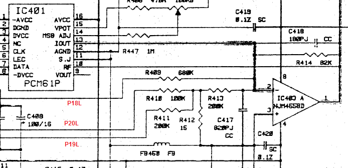

But recently I got a hold of a player with 20 bit upsampling and two PCM61 (18bit) plus two extra resistor-driven bits. I am amazed by what I hear - a CD via this r-2r sounds at the same level with SACD via the D-S chip ( I do own a few recordings in both formats).
I can imagine that the PCM1704 is even more exciting - I never heard it.
I just saw the new "old" stock friday and I was contemplating the price. $140 for a pair of DAC's is steep. But maybe worth it...
Especially when I think that DSD via PCM at 352.8kHz or even 705.6kHz is a very nice ideea.
Anyway, for the I/V conversion I think that a fast OpAmp is enough. It doesn't need to follow the slope of the individual bits, it just needs to folow the final settling time (under 200ns). The slope of individual bits can be attenuated at the input of OpAmp with small capacitors.
As for lowering the output impedance of OpAmps in HF domain - that is done with capacitors in paralel with the feedback resistor - maybe adding a discrete output buffer stage can improve that impedance even more?
Pure resistive I/V is shown in that link that it's just a joke - with 130ohm in order to have sufficient signal for a decent SNR (130mV), we get THD at -55dB!! Come on.... are we building 20-24bit DAC's or we are contemplating a 10 bit one?

Boky, add series resistors on the i-out pins makes me wonder how we have a low input impedance I/V stage.
Easy test to do is take a 100hz 0dbs wave file play it repeating and measure AC on the i-out pin of the PCM1704, should be as close to zero as possible. This voltage measurement divided by the total current (2.4mAxdac chips) gives the input impedance of the I/V.

Thats about perfect, but if there is a resistor in series to the opamp on the i-out pin we would have some input impedance and compliance? I assume you are measuring at the dac pin. Just seems a resistor on the i-out pin in series with the I/V would be in opposition to what we want to accomplish, maybe the resistor is in paralell with the opamp like below? That way its impact is negliagle to input impedance and compliance?
I have considered an I/V like this but with a much lower impedance prefilter (20 ohm resistor max, much higher cut-off). This way at lower frequencies thru the audio band, the input impedance is dominated by the opamp (near zero) and as the frequency moves toward the clock speed (from the steps) there is a limit to how high the input impedance can go due to the prefilter resistor in paralell with the opamp. Also the prefilter capacitors which turn to high impedance at higher frequencies are still in paralell with the resistor so no harm done. Plus the prefilter helps limit the bandwidth of the steps.
You could do the search on: "JT DAC No 3" for the circuit I used. It is the same one Walt Jung explained in "High_Performance_Audio_Stages_Using_TransZ_Amps.pdf". I used different values for Rf and Rs to optimise bandwidth/ringing, and gain.
Total gain of the stage and the transimpedance of the CFB OP used will influence the dynamic compliance "swing". For this reason, the LME49713 might be a better choice. I tried it - it was not as revealing as AD811 was....
I would say that AD811 is the closest thing to a single-gain-stage, optimised for I/V conversion. It is the fastest, with the lowest static impedance of any IC known to me….

Why use the resistor? It just limits the usefull voltage on output.I have considered an I/V like this but with a much lower impedance prefilter (20 ohm resistor max, much higher cut-off).
IMO tha capacitor itself does the same thing - that's the usual input capacitor in older datasheets (and older schematics). In newer schematics, it was done away with - probably is not important that the output impedance to be low at that frequency anyway (SR of steps themself), relevant is only the settling time of the DAC (that's around some 200ns)?
Notice in the schematics below the "evolution" to empty capacitor pads.
