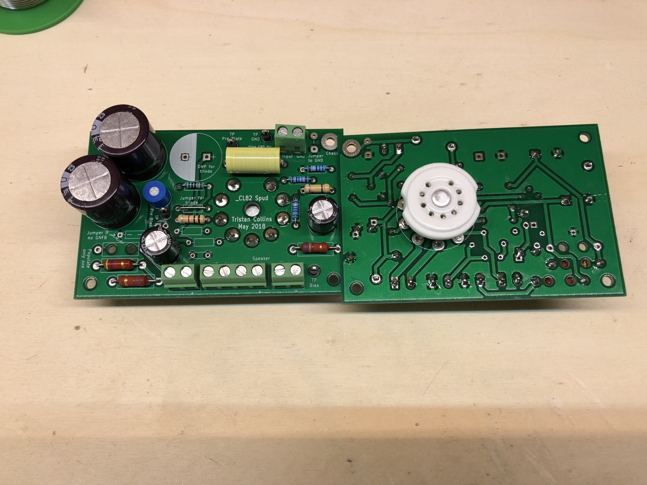

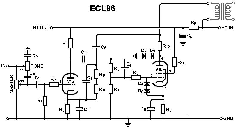

Interesting.. Would that need a coupling cap followed by a R//C combination?You could add the option for plate-to-cathode feedback in case you want to play with that? (i.e. ring of two)
And I guess this would connect directly to the input cathode, rather than the middle of the split R_k?
I can maybe use my R3 in double duty if I make a footprint with 3 pads to give the choice. It's tight spacing though...
Yes.Interesting.. Would that need a coupling cap followed by a R//C combination?
Whichever you like really.And I guess this would connect directly to the input cathode, rather than the middle of the split R_k?

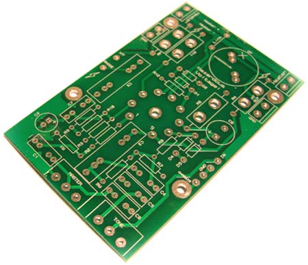

Thought I'd mention here that I've got some general purpose ECL86 PCBs available. I made then as part of my universal PCB range but I don't think I'll make them permanent, so if anyone wants one while stocks last, now's your chance.

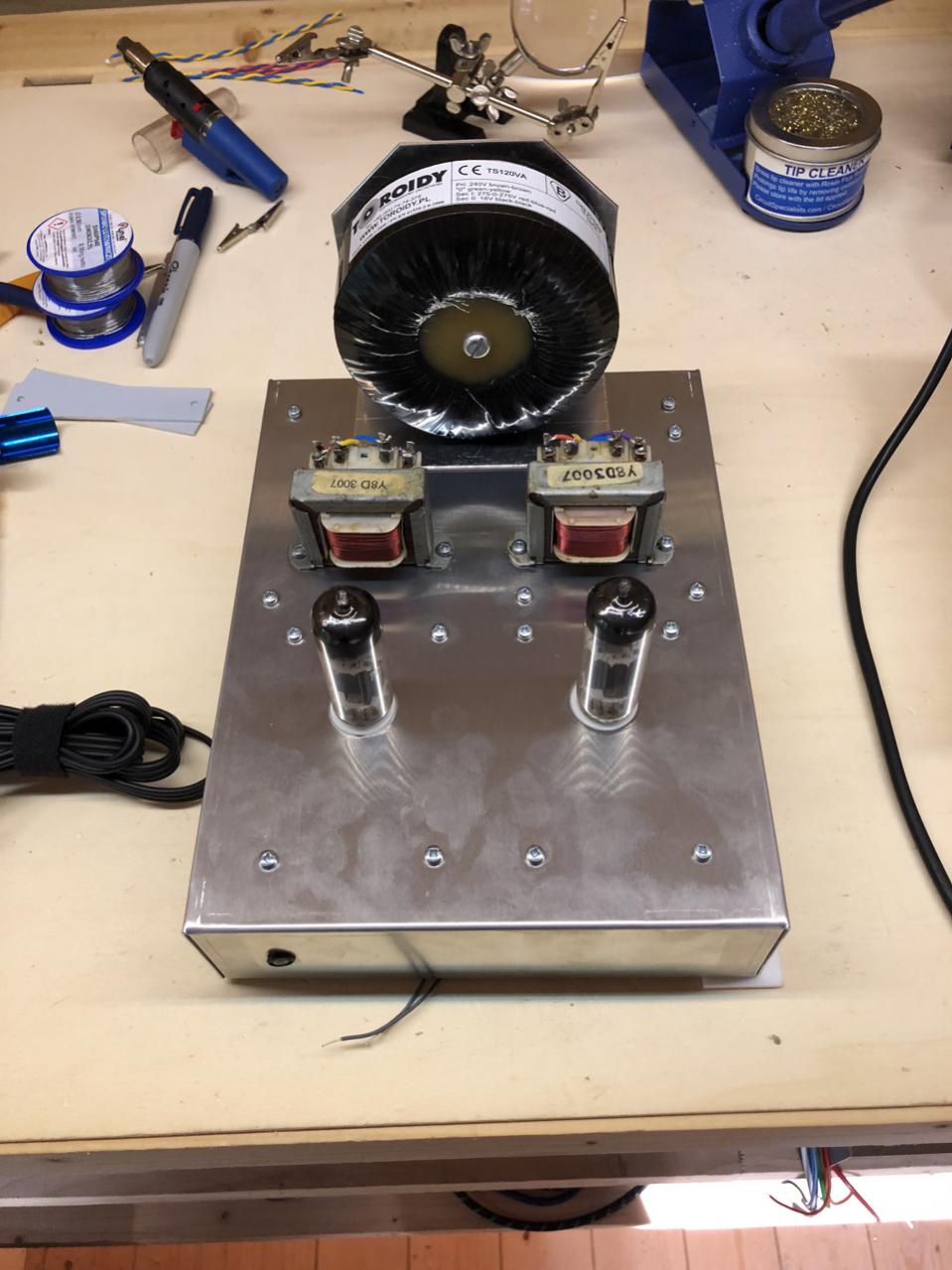

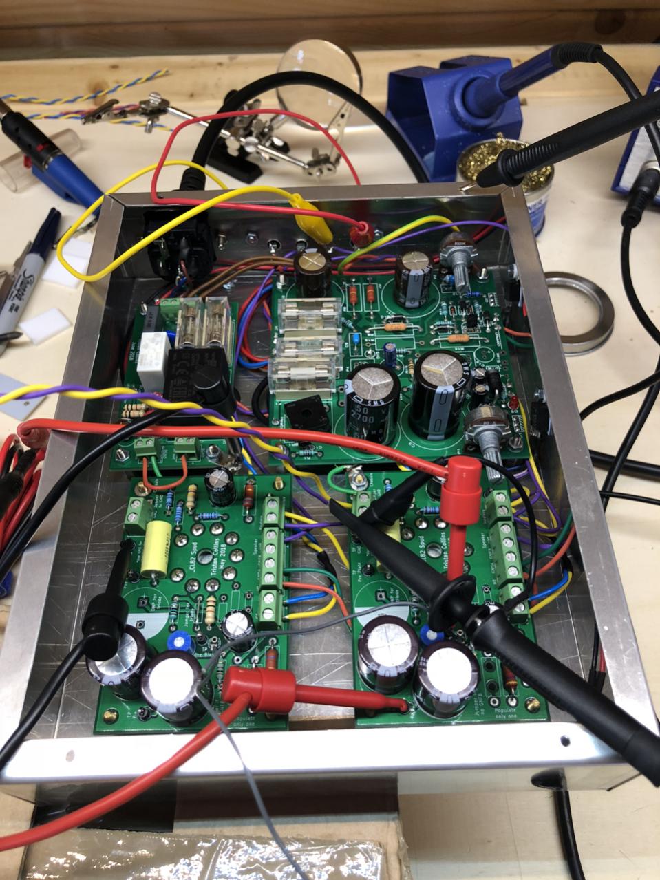

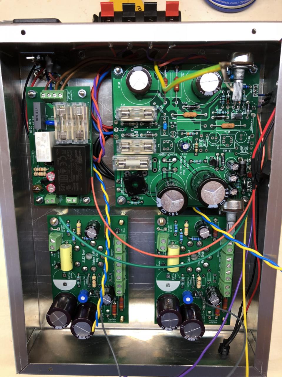

Build update
Over the last couple of weeks I've finally got this build together and making sound.
Photos below.
Just have to tune the GNFB and finalize the signal inputs (had thought to hard-wire a RaspberryPi / DAC and use it as a streaming device).
Playing through my 8ohm living room Wharfedales (so a slight mismatch) it sounds good. Not much bass compared to my DCPP (hoping the GNFB might improve that a bit) but perfectly respectable to my ears.
I'll post some scope traces etc when I get the time. Also, if anyone wants one of my spare PCBs let me know.

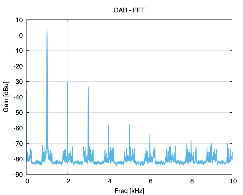

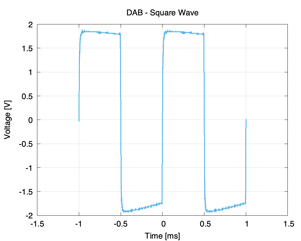

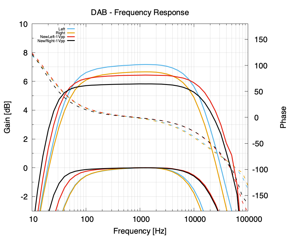

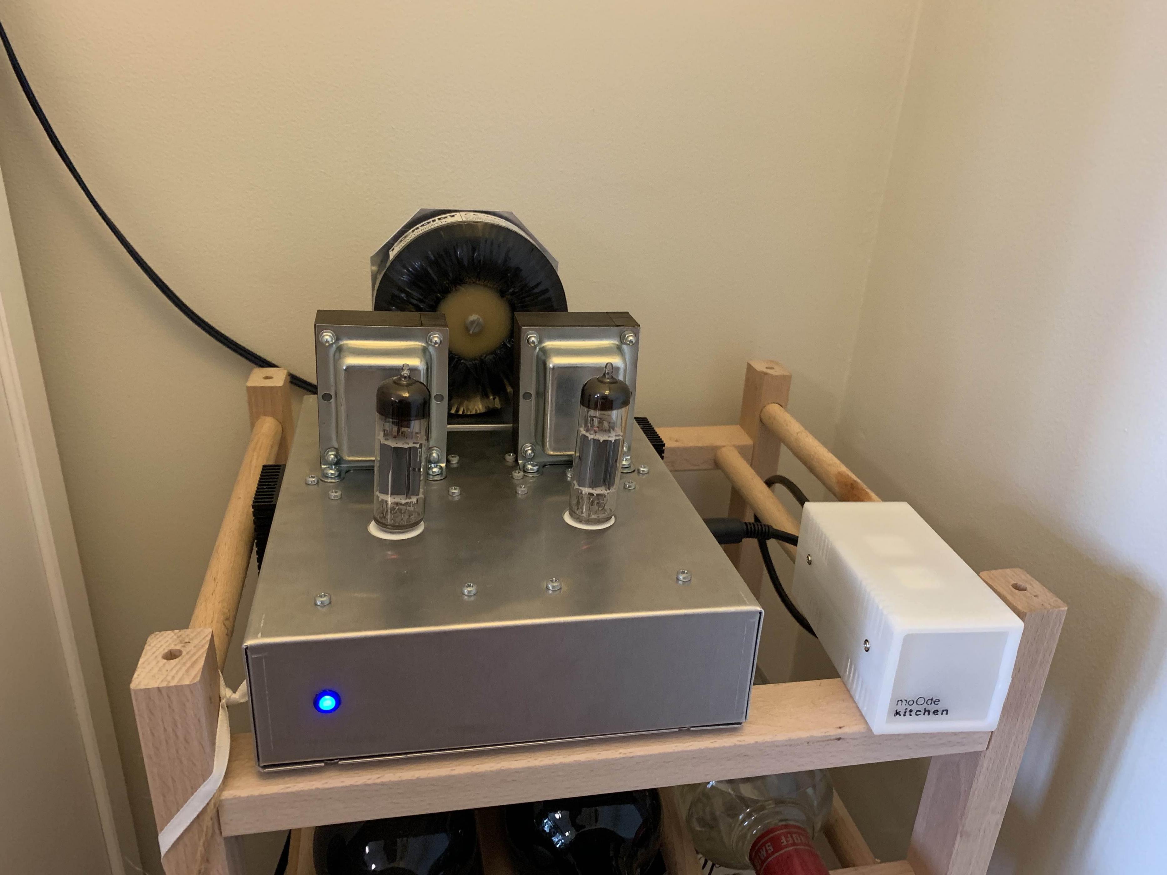

"Finished" and measurements
So after months of tinkering & tweaking I'm finished the physical build.
The last major change completed yesterday was replacing the tiny, vintage OTs with a set of new, beefier ones from VVT.
Result: what I consider a good sounding set-up for my kitchen. Puts out about 1W on the edge of clipping. Listening through my home-made miniKarlsonators there is a _slight_ lack of bass, but that could be the speakers and their position. A small bit of EQ solves that and makes for enjoyable listening, especially with jazz / piano stuff. Not so great with heavy rock.
Attached are some readings taken:
- freq sweeps with old and new OTs, showing magnitude and relative to 1kHz level
- square wave response at 2Vpp 1kHz input
- FFT of 2Vpp 1kHz sine input
Slight mismatch between channels for some reason... Perhaps a coupling cap?
I've plenty of PCBs left over if anyone wants them to try this themselves.
