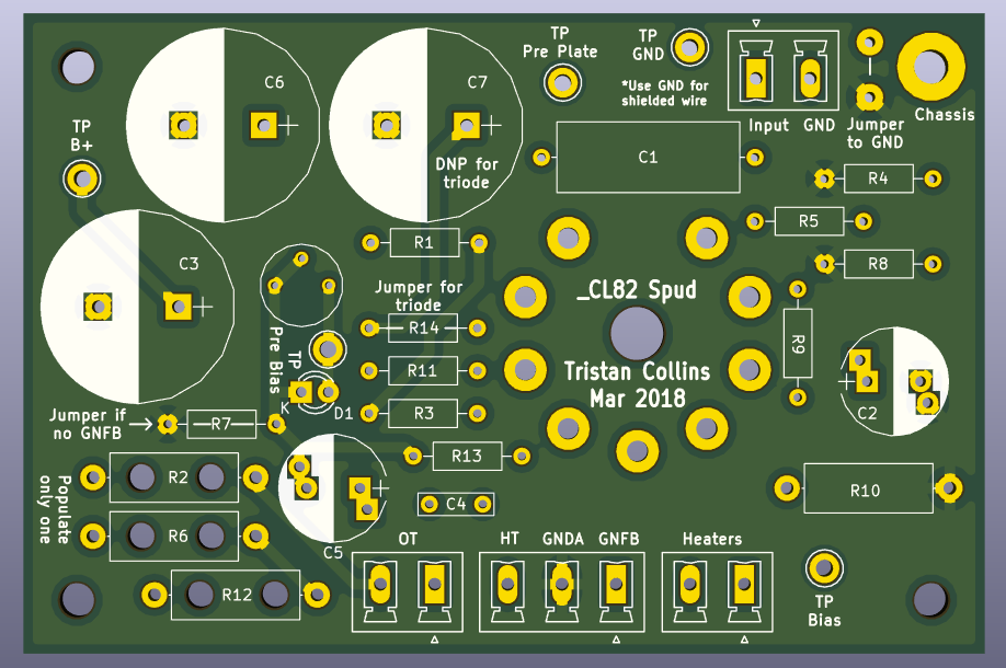

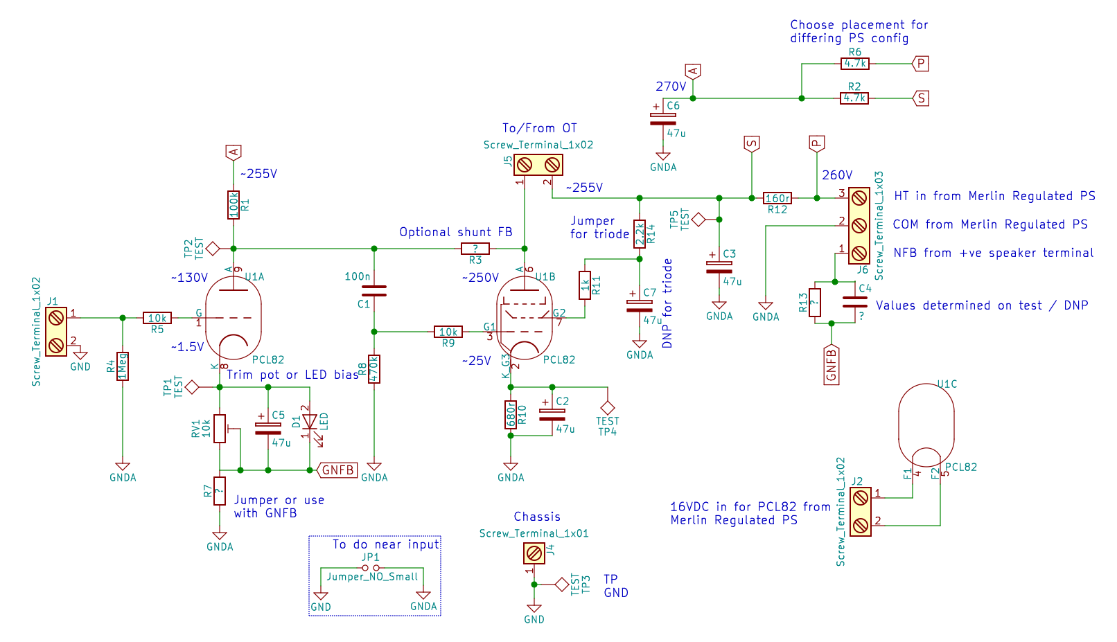

I'm planning on making a simple, compact SE PCL82 amp for the kitchen / office. For ease and speed I'll get some PCBs made up using PCBway (10 for $5).
Attached is my attempt at a design featuring:
- pads for GNFB
- pads for shunt (plate to plate / Schade) feedback
- driver stage bias by trim pot or LED
- pads to allow both triode and pentode connected power stage
- alternate B+ chain
- plenty of test points
- should be usable for both ECL82 & PCL82

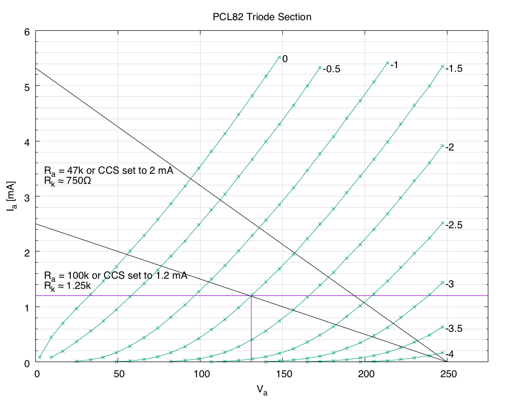

Initial component values are shown on the schematic (based on PCL82 measured curves taken with a uTracer). I'll have plenty of scope to tweak on test.
The HT and heater supply will come from one of Merlin's regulated power supply boards. OT are old, tiny ones from eBay. PS is a custom toroidy.pl left over from another build.
The kitchen amp will use two boards for stereo, the PS board and an additional PS relay board (to be designed) to give a 5V supply and control the overall power state via a Raspberry Pi Zero.
I hope to use one of the extra boards as a test bed to have a go at tuning the GNFB / square wave response / Schade etc etc.
Can anyone see any issues?

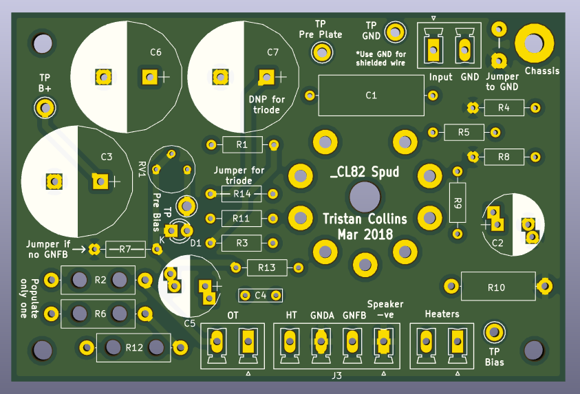

You need to ensure that the feedback is referenced to the same point as the input, so some sort of connection between speaker -ve and GND/GNDA is needed. Ideally this connection would follow the same route as the +ve speaker to feedback, so the loop area is small.

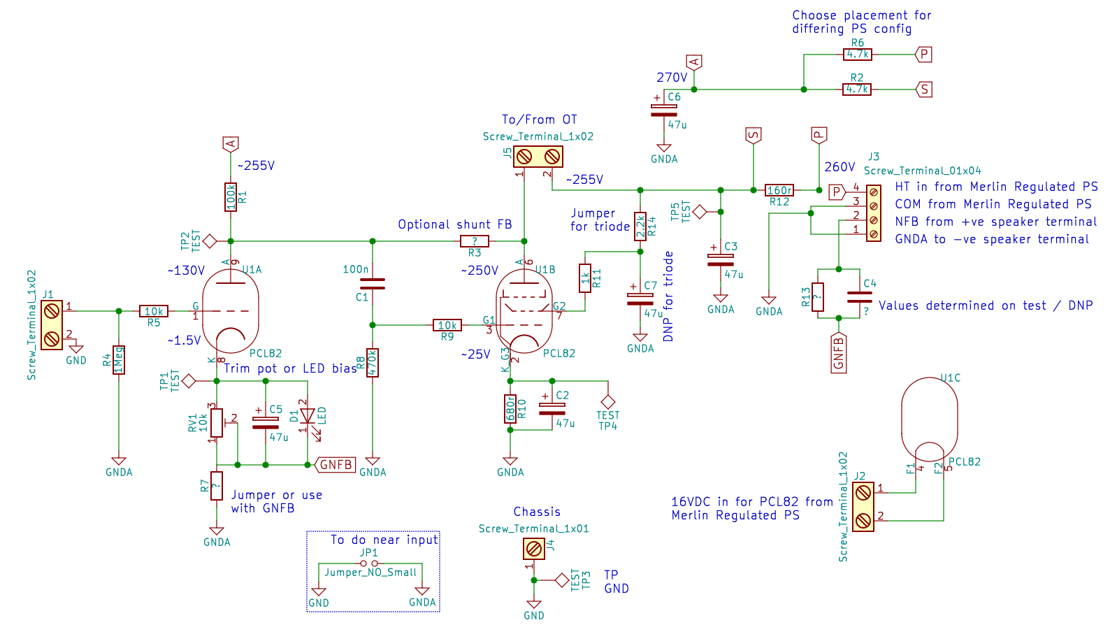

Thanks - yep, should have added that. Attached is an updated set. Added an additional pad to make the -ve connection to the OT / speaker connector.
I'll need to review the grounding - I had hoped to keep GND as the pour and GNDA as short connections to each filter cap...
