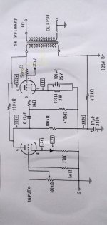

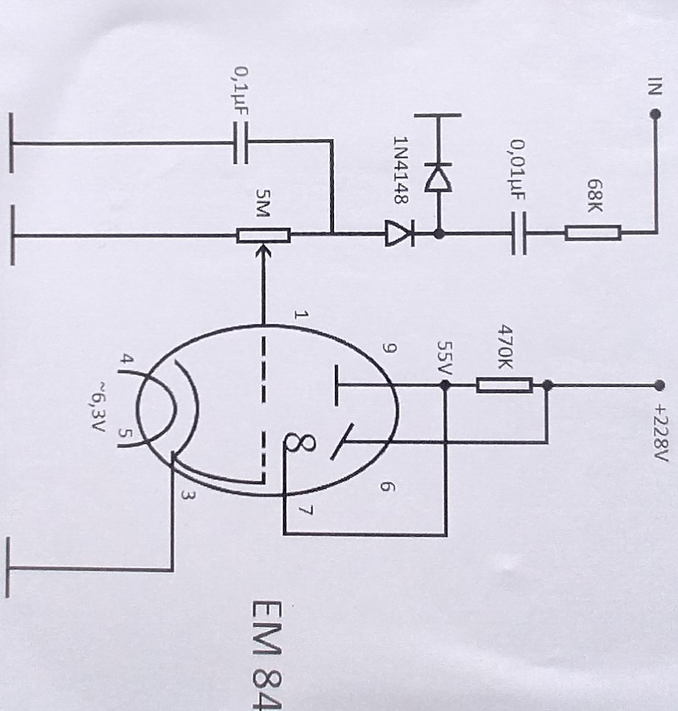

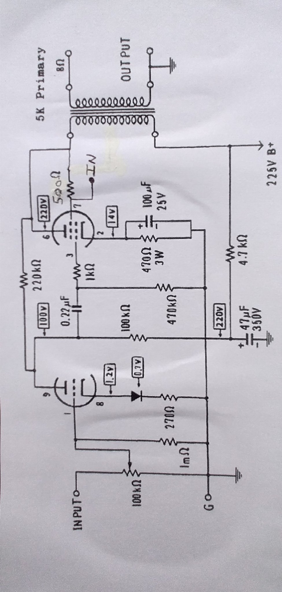

Where from do you drive these indicator tubes? EM84's need about -20 Vdc at the triode's grid to close the bar completely, a voltage that never can be obtained from the speaker output of a 3 watts amplifier, unless it transforms to an weird high speaker impedance.

Thanks! Yes, I've overlooked your IN terminal at the pentode's screen 🙄 .
€ 5.20 incl. S/H indeed is ridiculously cheap for an EM84 tube
! I think I'm gonna give it a try...
Btw, the Eastern German EM83 that you mentioned is an interesting tube as well, as it's a twin indicator, hence calls for service in a stereo amp. But it's $$$ or €€€...
