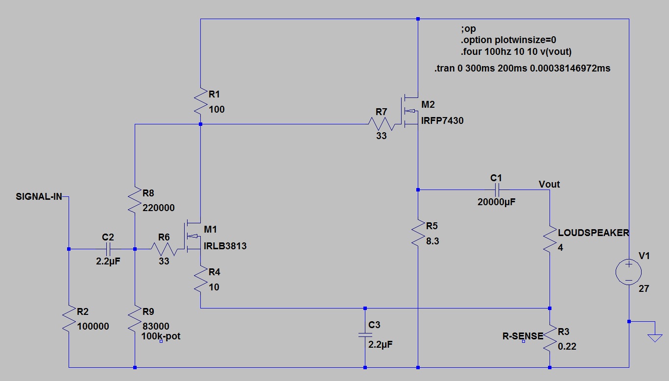

This is where I ended up after some quality time in LTSpice and some real life single channel test-amps.
M1 is an IRLB3813 and M2 is the legendary IRFP7430.

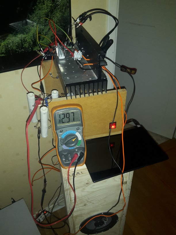

It sounds very nice. It exerts a very firm control of the 6,5 inch car audio coax-driver in a large quarter-wave pipe. The bass is very powerful, dynamic and seems to go a lot deeper then the tuning admits it to do.
Johannes
Some small changes I made since the first version playing, and some small clarifications of the different parts.
When I applied PCF to my Bastode Zen amp the distortion increased and there was a certain sound-character associated with PCF that I first believed where due to the negative output impedance effecting the responce-curve of the speaker.
This does not seem to apply to the F6 with PCF, so I have been thinking about where that character comes from.
This is a test of using PCF without the global negative feedback-loop, while keeping the somewhat "Triody" or "SITy" character with the IRFP7430.
I can´t hear any of the unwanted character I previously associated with PCF.
This amp just sounds clean and more and more aggressively and firmly controlled in the bass when I apply PCF.
The Bastode Zen amp sounds more vivid, alive and fun when it drives my BIB. This amp is a little more laidback and cool, but with a much improved clean, dynamic and vigorous bass reproduction..
Johannes.

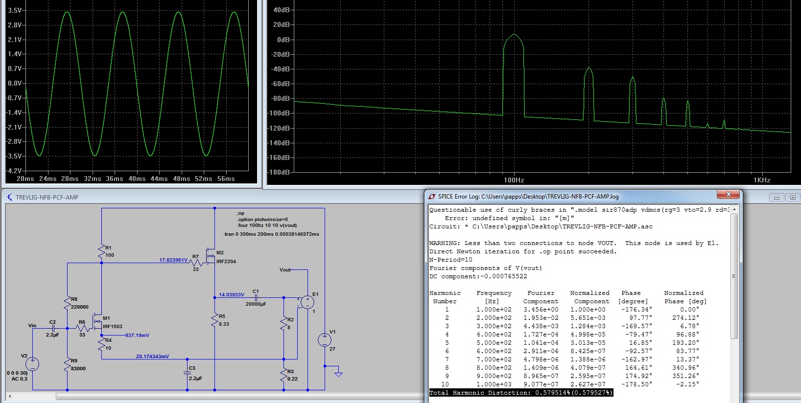

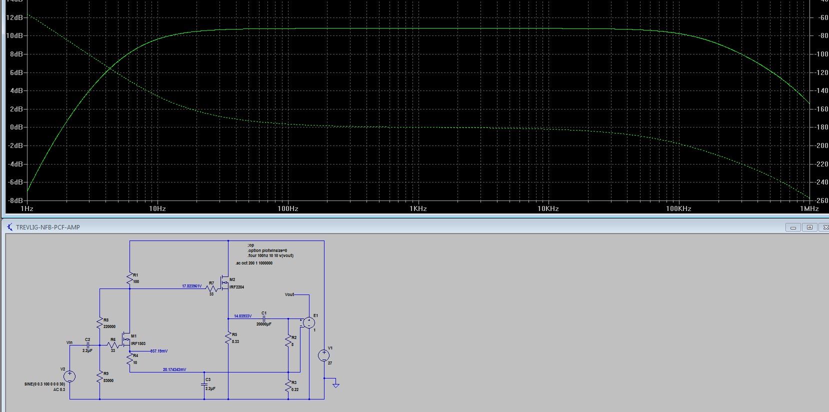

Here is simulated THD and frequency response into an nice resistive 8 ohm load with 0.22 ohm R-Sense.
There is some distortion due to the positive current feedback, the simple voltage gain stage and lack of global negative feedback, but it does not worry me. In this test I am perfectly happy to trade away the global negative feedback for some added THD. It is all about exploration and fun experiments, and 0,57 % simulated THD is quite good compared to many single ended Triode-amps.
I can not hear any of the warm fuzziness associated with lots of second harmonics from this amp.
Johannes

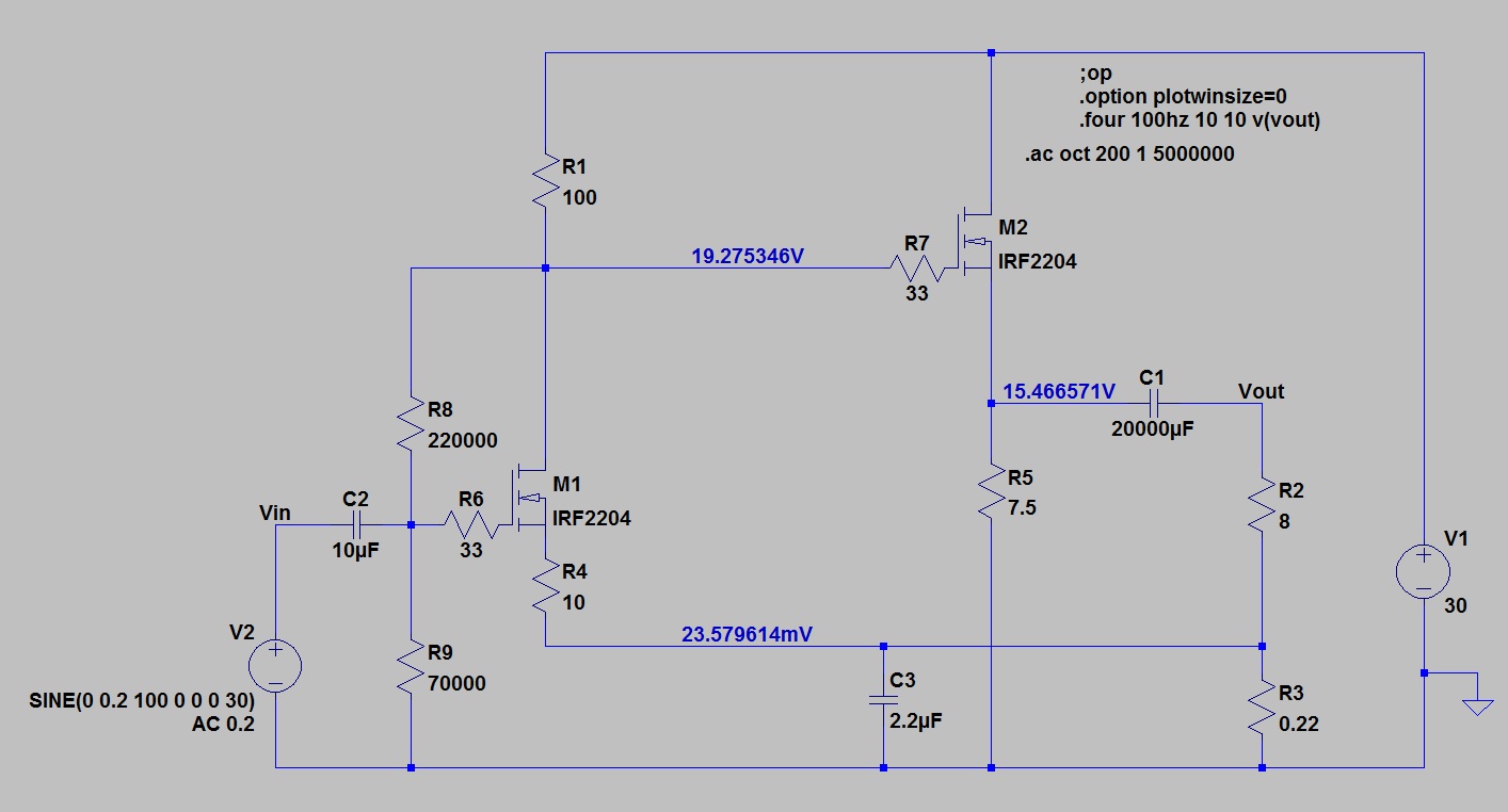

Today I upgraded my test-amp with a new output MosFET.
The IRLP3034 is a logic level gate (2.46 Volt Vgs for 1.0 ampere at 2.46 Volt Vds) so there is more voltage over R1. This lowers the distortion in simulation at least, and since it makes sense I could not see any reason not to swap the output device to a logic level gate TO247 with lots of nice transconductans.
http://www.mouser.com/ds/2/196/irlp3034pbf-938028.pdf
I also increased R-Sense to 0.44 ohm for a higher negative out-Z (can you say "higher negative out-Z?).
The output power increases 4 times for half the load resistance. 2 watts into 8 ohm gives 8 watts into 4 ohm. It still sounds very nice even though my loudspeaker has a quite different tone-curve then before.
The bass is absolutely thunderous. I have never heard a cheap 6.5 inch car caox loudspeaker in a quarterwave pipe sound like this.
When powerful and deep electronic bass hits I get afraid the cones are going to come flying across the room. It is fun for home theater but a little to much for hifi use.
I have been thinking about how to design a very nice sounding amp with lots of power for subb-woofer duty. I have some ideas why Rod Elliot shuns negative output impedance in his article. Clearly it is possible to build a very nice sounding amp with a couple of ohms of negative output impedance. A lack of global negative feedack is part of the solution.
Thanks for the idea Nelson Pass!!! I keep on learning so much from all the stuff you keep on hinting in your posts. 🙂
Johannes

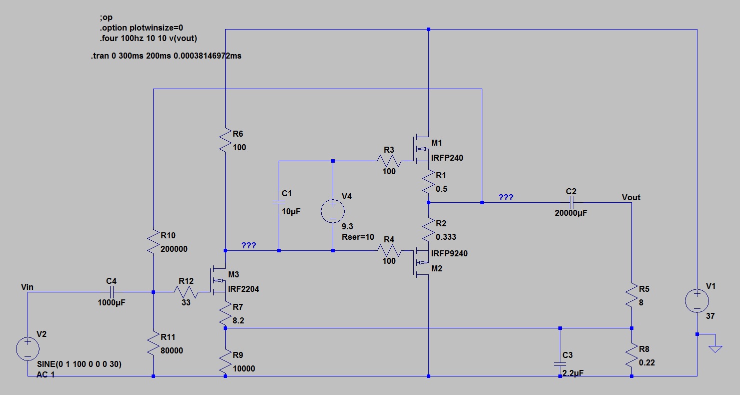

Nelson Pass DEF outputstage should be a very suitable outputstage for this simple no global negative feedback PCF amp. Since I don´t have any suitable SIC depletion-mode JFETs I have to solve the bias with a battery.
The usual 9 volt battery has 9,3 volts with no load, and fits perfectly between complementary P and N channel fets with some small amounts of source-resistance to set and stabilize the bias.
It is not as neat as Pass original DEF outputstage but it seems to work nice in simulation.
The voltage asymmetry seems to work in my favor for once, since I need more voltage across the drain-load resistor (R6) in the input stage. The distortion increases a lot with less the half the supply voltage across R6.
Johannes
