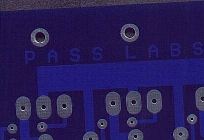

Hi Kristijan.
Any experience with Gold plated PCB, is this applicable to your boards as addition and what is your opinion about this. I personally think that it should improve things.

Hello trigon,
The gold plating of the PCBs is possible, but it is just unneccesary to make them that way, and the cost is not justified.
There is no way to get any better sound results with the gold.
The main purpose of plating the PCBs is to protect the Cu tracks and pasds against corosion - oxidation, for improved solder joints when soldering thus lowering joint resistance.
Also, there is much less risk for cold joints.
On my PCBs I use Pb-Zn track overlay.
I enclosed the picture, and like you can see, the silver look of the pads are achived by tinplating.
The all tracks are tinplated, even under blue soldermask.
